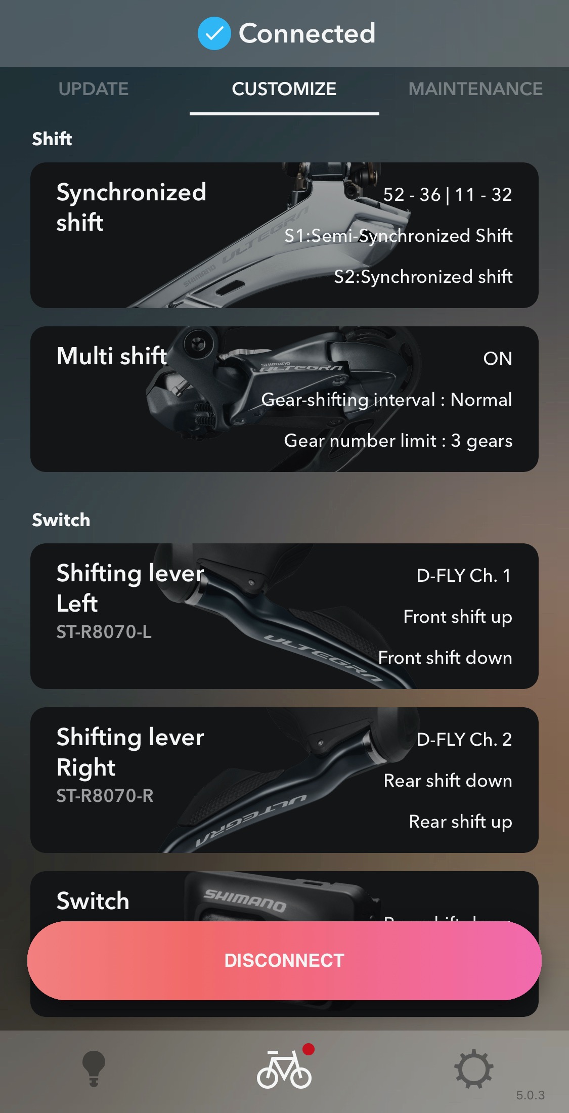

    I’ve just had another thought
    I’ve just had another thought after connecting up one of my bikes…
    The app has been updated at some point (I hardly ever use the app, I would never do firmware updates over the air, cable only and my main reason for using D-Fly is head unit communication).
    Obviously when connected, the system is unresponsive, probably in some kind of maintenance mode. There’s a big “DISCONNECT” button in the app now – are you pressing “DISCONNECT” or just quitting the app? I wonder if the latter, the system is not waking up again and still thinks it’s connected.
