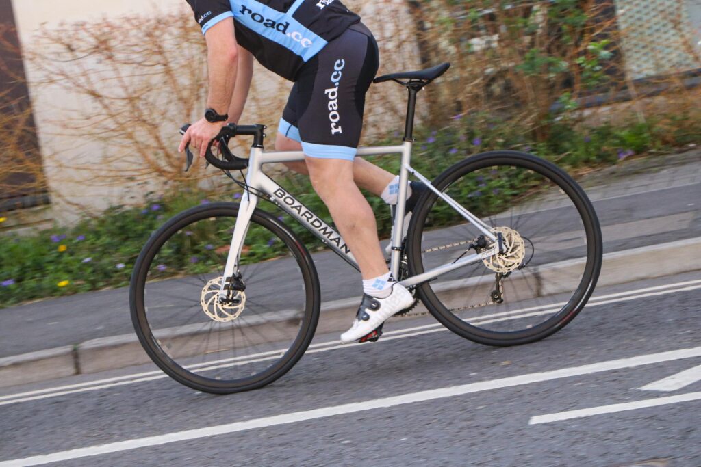

Not having to settle for compromises from a comfort point of view means that you can enjoy everything else too.
The geometry is slightly more relaxed than a race bike, with the front end slackened off enough to take a bit of speed out of the steering without muting it too much that it lacks excitement at speed – you can still have fun tackling a fast section of road or your favourite downhill.
It’s your typical ‘endurance’ setup. The top tube is a touch shorter for the bike’s nominal size and the head tube a little taller. It gives you a less extreme, more relaxing position on the bike while still allowing you to get a bit aero in the drops when you want.
At this price the SRL 8.8 is more likely to be considered by those new to road riding – your first bike, possibly, or first road bike at least if you’re coming from a hybrid or mountain bike background.
The Boardman is perfect for this; it’s an easy bike to ride and it gives you all of the fun and sense of speed roadies crave with none of the drawbacks like twitchy handling or a nervous rear end from a short wheelbase.

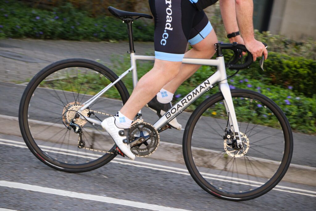

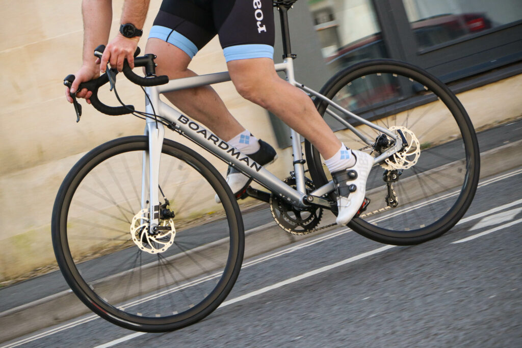

With the ability to take full mudguards and a rear rack, the Boardman lends itself well to all-year-round riding for training or commuting, where the relaxed ride feel can also be a benefit if the roads are wet, slippery or you’re in urban environments mixing with the traffic.
I found the SLR to be a cracking bike to ride, and while I spend a large amount of time on bikes costing thousands and thousands more than the Boardman, it was never found wanting in terms of the fun factor.
Its overall weight takes the edge off of climbing and acceleration compared with bikes 2kg to 3kg lighter, but the SLR doesn’t come across as sluggish. And while some of the long, steeper climbs were a bit of a slog in the 34×32 bottom gear, I don’t think I felt as though I’d ever had a compromised training session or ride.
When sprinting away from the lights or hauling up those climbs, I could feel a tiny amount of movement at the bottom bracket area, but that was only when really smashing the power through the pedals. Overall, the SLR still feels tight throughout, including the fork, when cornering or braking hard.

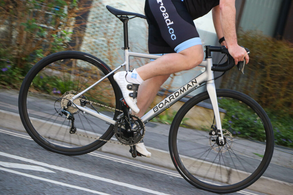

I probably enjoyed the Boardman the most on those rides where I was just tapping out the miles, on my own in the lanes. Away from the hills the overall weight is less of an issue, and it was here I found the SLR to be efficient and smooth rolling.

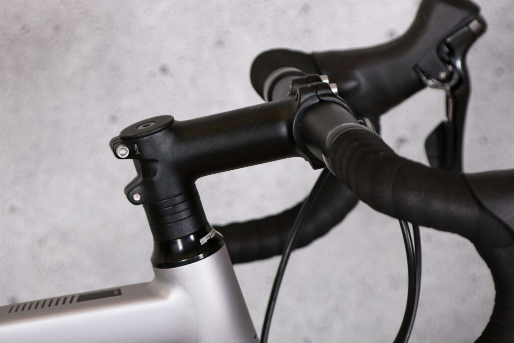

The standard wheels and tyres are comfortable, as is the rest of the finishing kit. The bar tape and saddle give plenty in terms of padding and support.

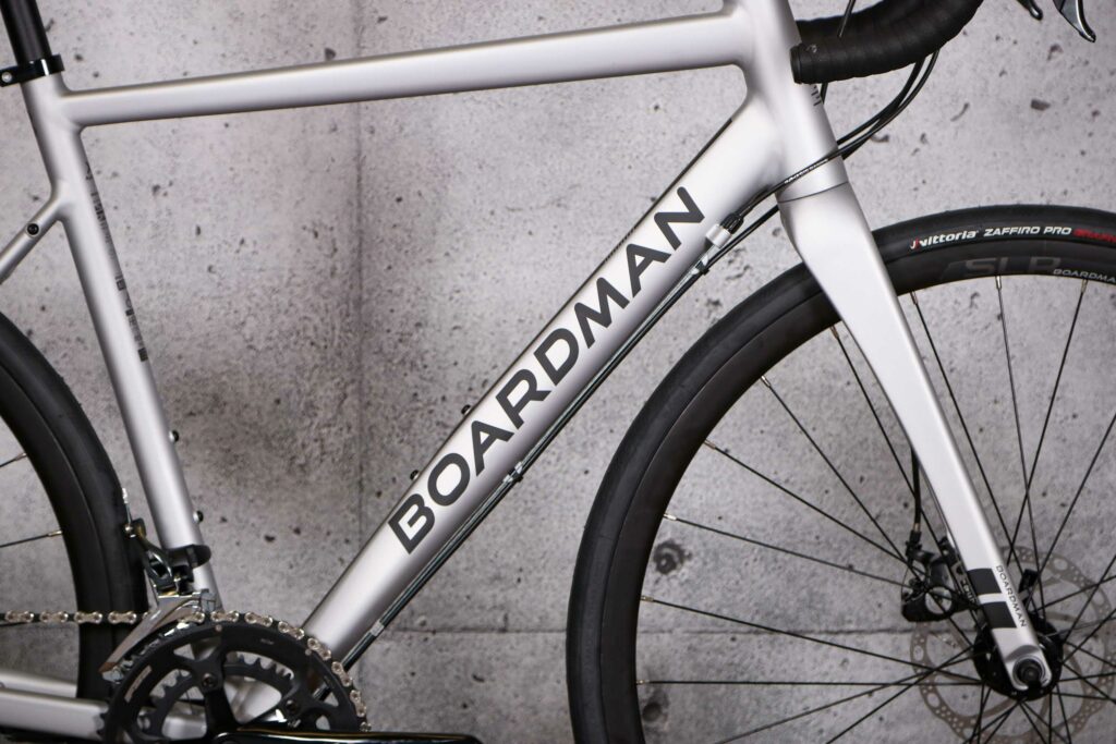

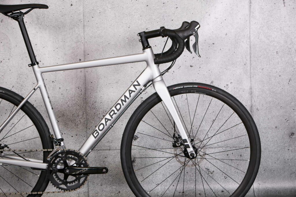

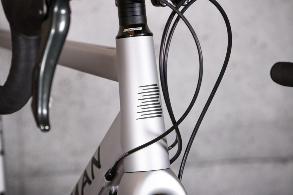

As I mentioned earlier, the SLR 8.8 is created from aluminium alloy tubing, 6061 grade in this case. No surprises there as it is a stalwart of bicycle manufacturing, but Boardman has gone down the butting route.
2022 Boardman SLR 8.8 – front (Image Credit: Farrelly Atkinson)
I mentioned the triple butting earlier; butting relates to the wall thickness of the tube. On basic metal alloy frames, the wall will be the same thickness across its length. If it’s double butted, probably the most common we see, it’ll be two different thicknesses: thicker at the ends where more strength is required and thinner towards the middle to promote flex for better ride quality and to drop a tiny amount of weight.
Triple butted – yep, you’ve guessed it – means that the tube will have three different wall widths, giving even more scope to tweak the frame’s stiffness and comfort levels.
> A-Z of cycling jargon: find out what over 150 strange terms really mean

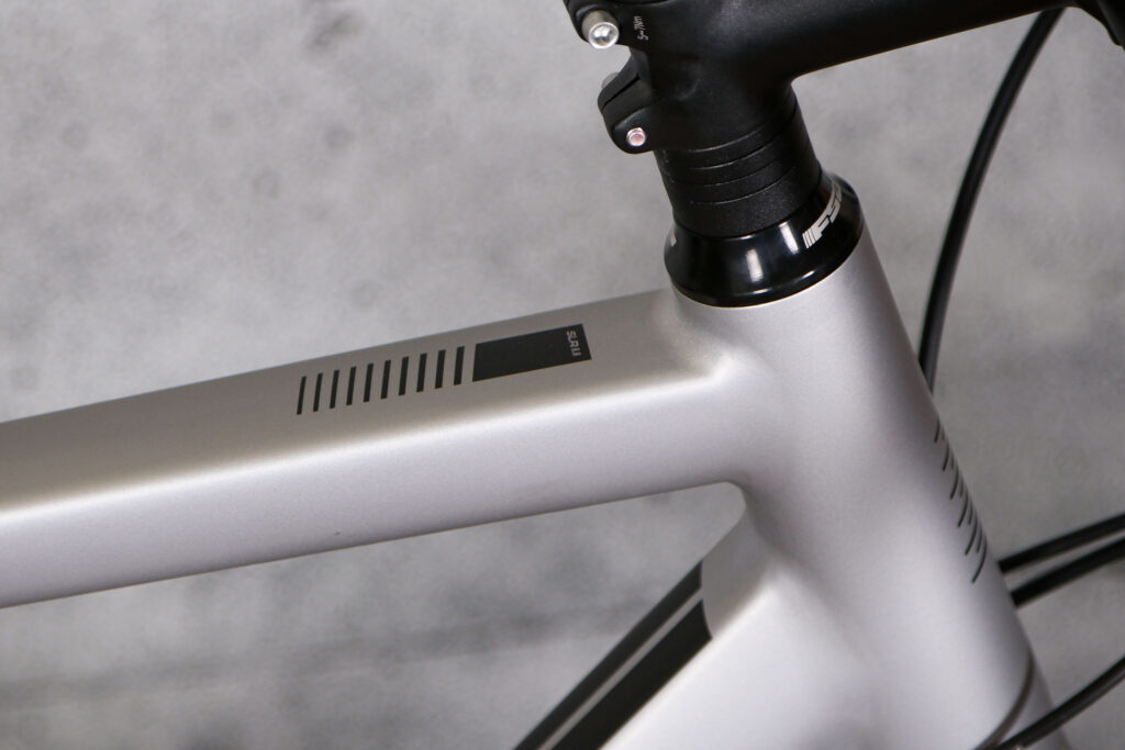

Boardman’s designers have done a good job, as you can tell from the previous section; the SLR 8.8 rides very well indeed. It has the stiff and firm qualities that aluminium frames are known for, but with a hint of suppleness. It’s no steel or titanium, but for the price it’s one of the better aluminium frames out there.
2022 Boardman SLR 8.8 – top tube (Image Credit: Farrelly Atkinson)

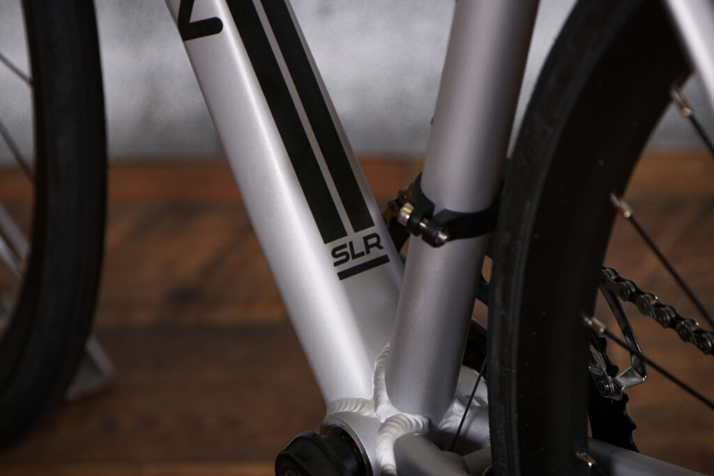

The overall finish looks good, with the silver paint finish alluding to the metal beneath. The welds in the visible sections have been sanded to give as smooth a finish as possible, although the bottom bracket junction has been left a little more agricultural looking. I’ve no issue with that, though – leave as much material in this area as possible.
2022 Boardman SLR 8.8 – bottom bracket (Image Credit: Farrelly Atkinson)

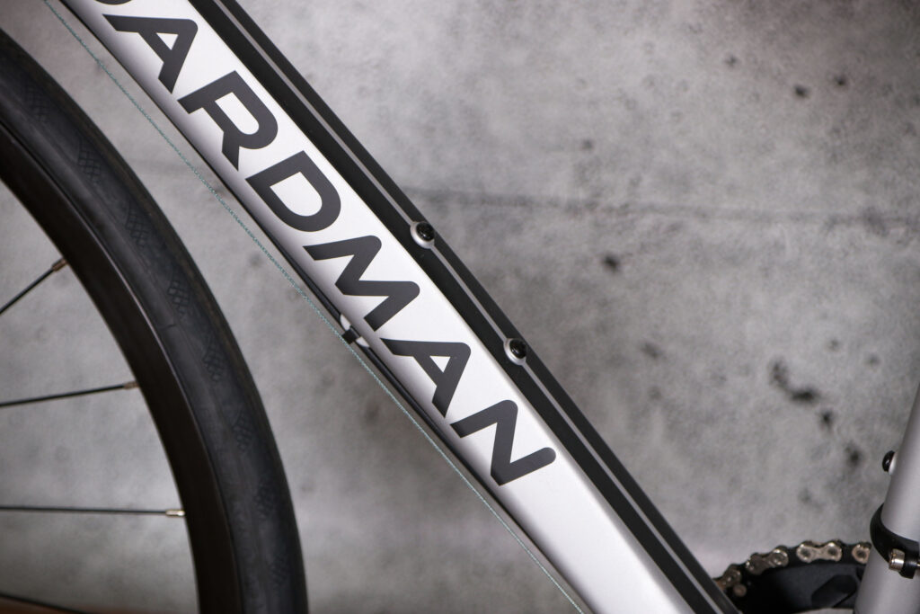

There are some concessions to price, though.

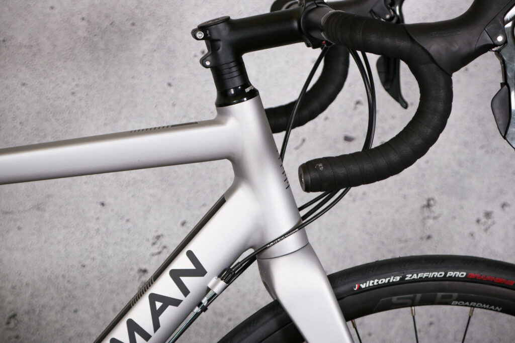

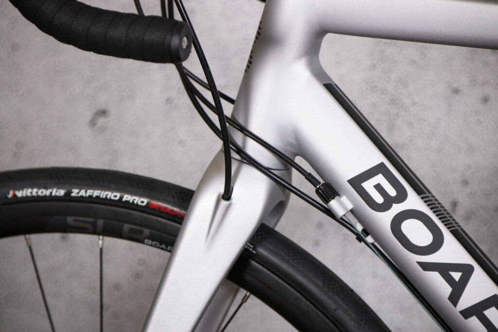

First up, apart from the brake hose travelling down through the fork leg, the rest of the cable/hose routing runs externally. It’s not as clean looking as internal routing but it does make maintenance easier, especially for those who like to fettle and do their own servicing and repairs at home.
2022 Boardman SLR 8.8 – cable routing (Image Credit: Farrelly Atkinson)

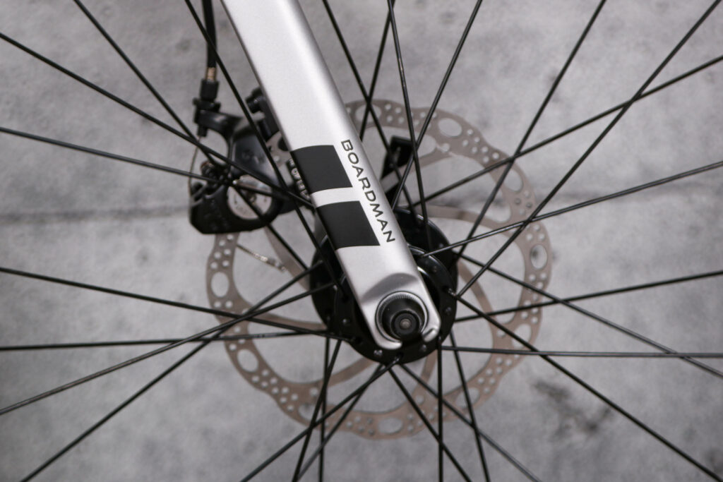

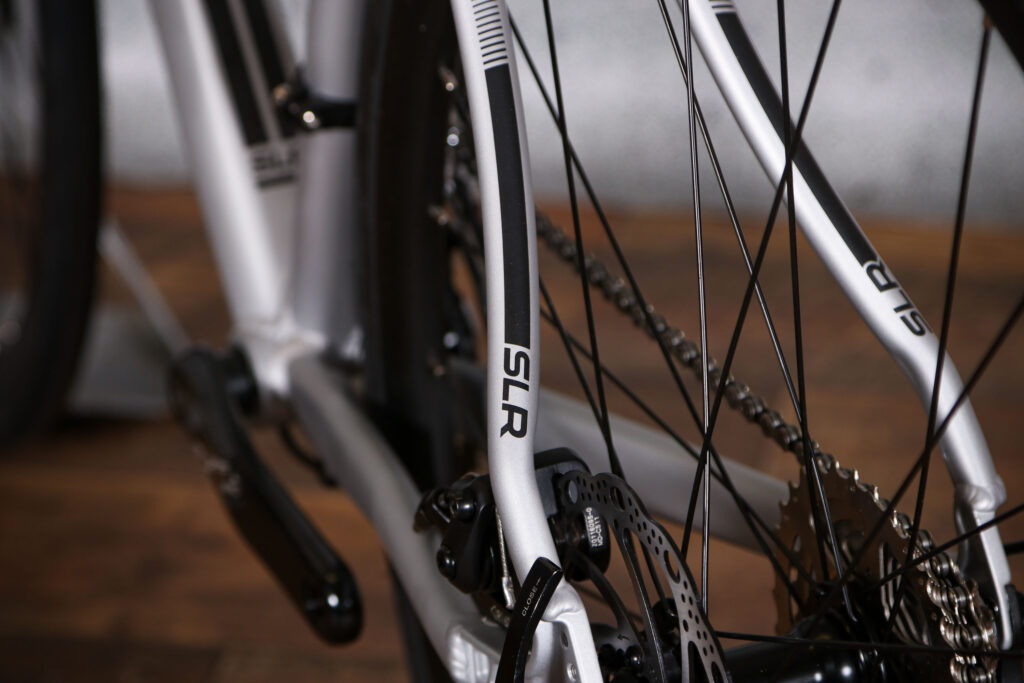

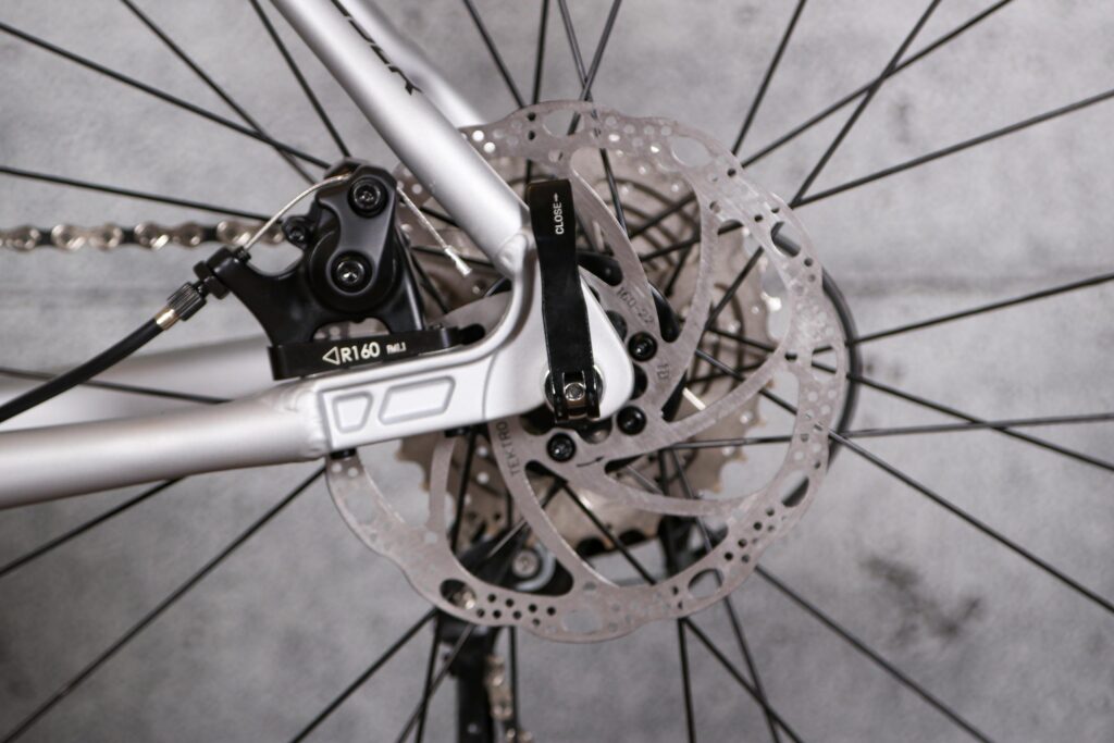

The other thing is that the SLR doesn’t use thru-axles for the disc wheels, going old school with quick release levers. It’s not a massive issue – we’ve lived with them for years without problems – but I suppose I’ve just got used to the security of having the axle threaded into the frame.
2022 Boardman SLR 8.8 – rear disc brake (Image Credit: Farrelly Atkinson)

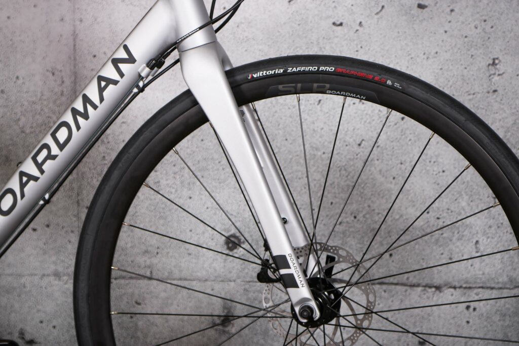

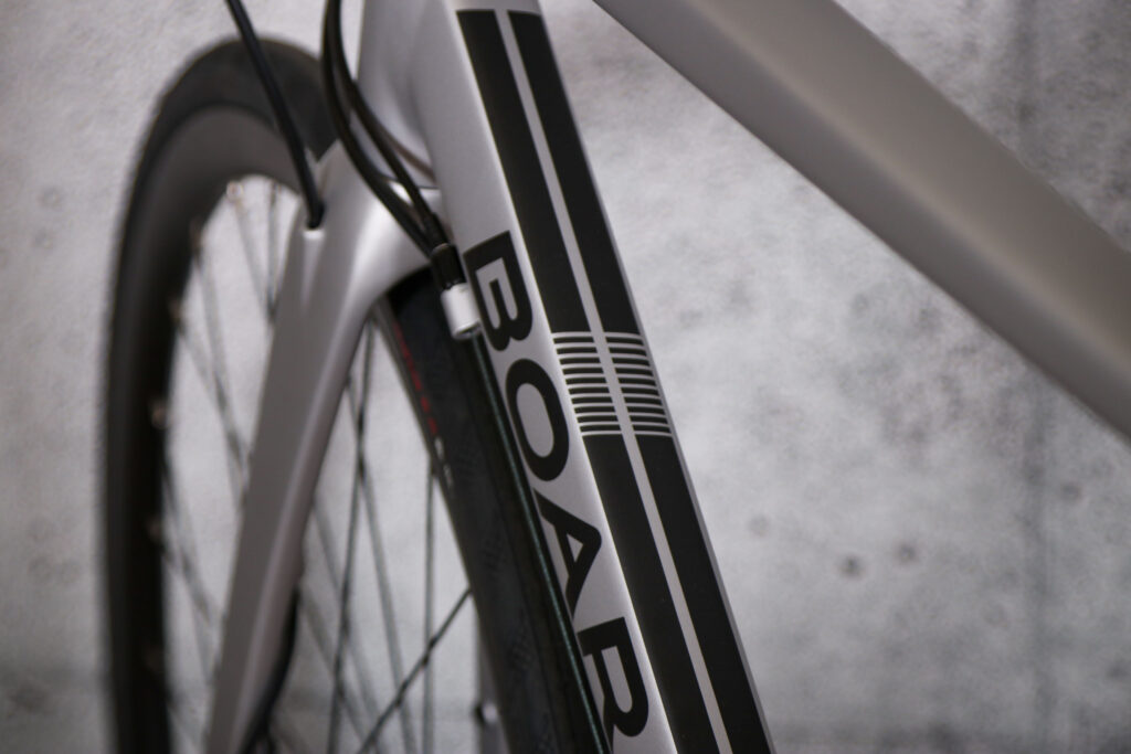

One issue with quick releases is that they can allow the fork ends to twist under heavy braking, because of the rotor just being on one side. In my experience you have to be motoring for that to happen, though – I’m talking hauling the brakes on for a complete stop from 50mph or so – and it’ll depend on how stiff the fork is in the first place.
2022 Boardman SLR 8.8 – fork (Image Credit: Farrelly Atkinson)
Essentially, neither the quick releases nor the external cable routing affect performance, they just highlight the little upgrades you get by paying a bit more.

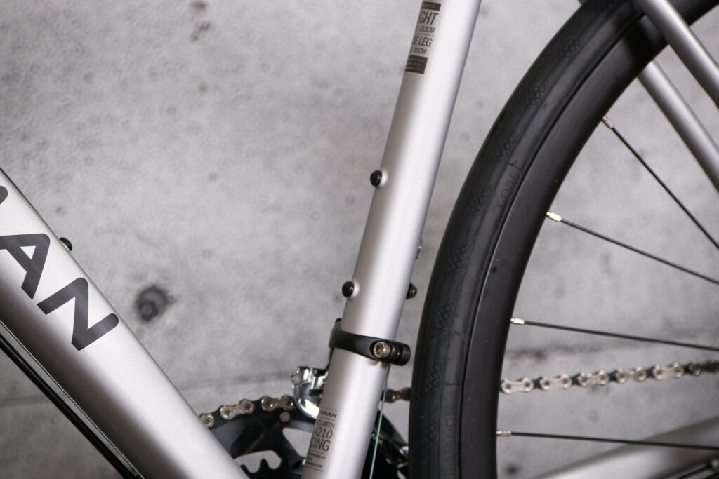

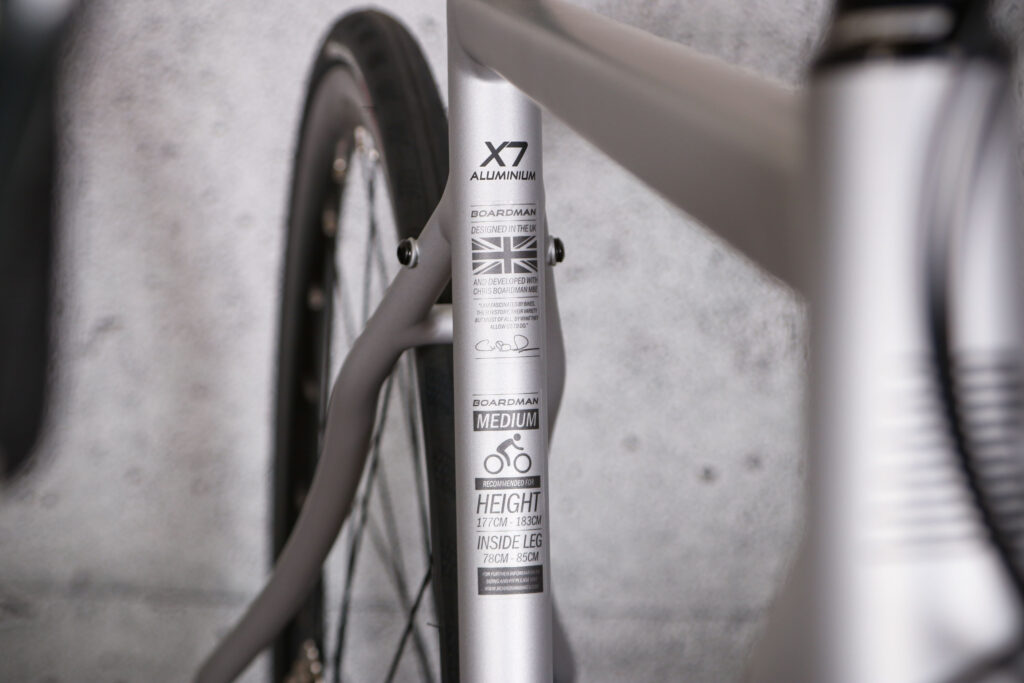

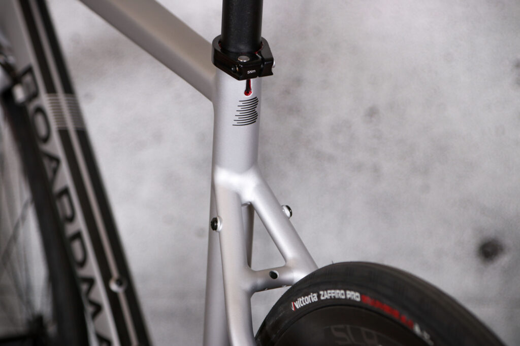

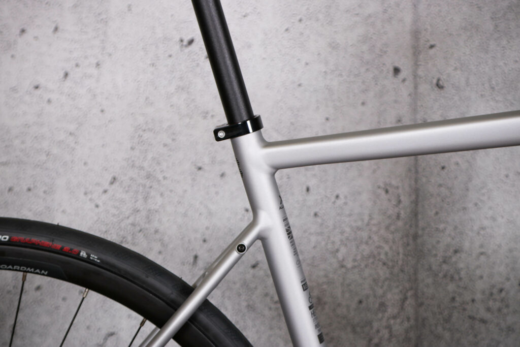

Other than that, you are getting two sets of bottle cage mounts, full mudguard mounts and bosses for attaching a rear rack.
2022 Boardman SLR 8.8 – seat stays top (Image Credit: Farrelly Atkinson)

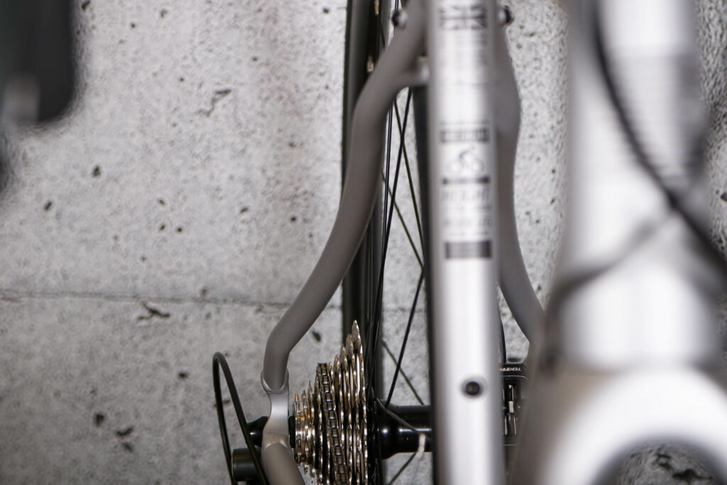

The bottom bracket shell is threaded, and the SLR has plenty of room left over either side of the 28mm tyres fitted as standard for mudguards to fit, and to go wider without.
Geometry

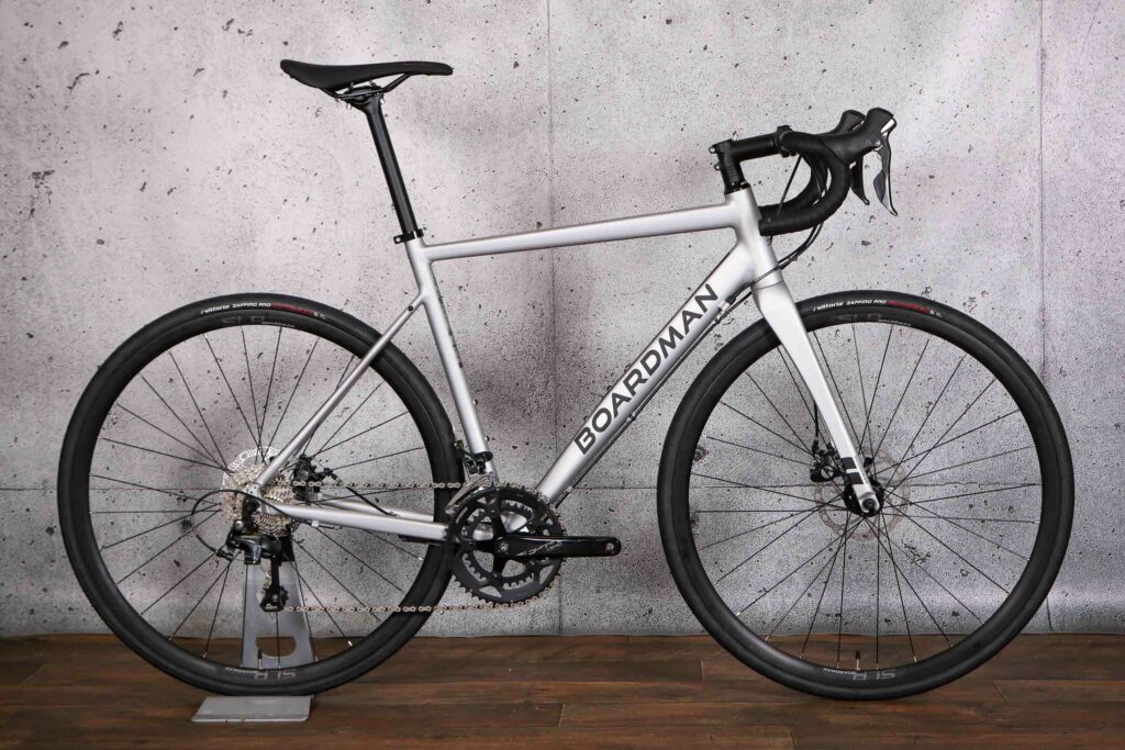

There isn’t anything out of the ordinary when it comes to the geometry of the Boardman, and that’s a good thing. There aren’t any quirks that you are going to need to learn to live with.
2022 Boardman SLR 8.8 – rear (Image Credit: Farrelly Atkinson)

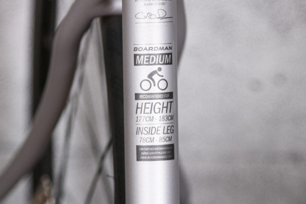

Four sizes are available, from small to extra-large, which equates to top tube lengths of 540mm and 585mm respectively, or a recommended height range of 170cm to 195cm.
Our medium test bike has a top tube length of 552mm, head tube of 160mm and seat tube of 530mm. The head angle is 72.5 degrees while the seat tube sits at 73.5 degrees. This gives stack and reach figures of 568mm and 384mm respectively.

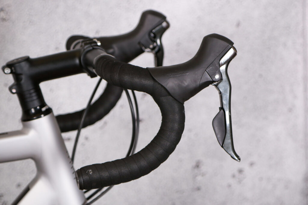

The SLR 8.8 primarily uses a Shimano Tiagra groupset, which is based around a 10-speed system. You get the STi levers, front mech and rear mech, plus a Shimano HG500 cassette, but then things deviate a little.

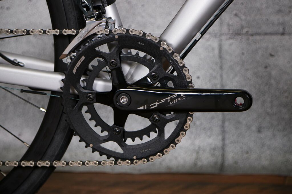

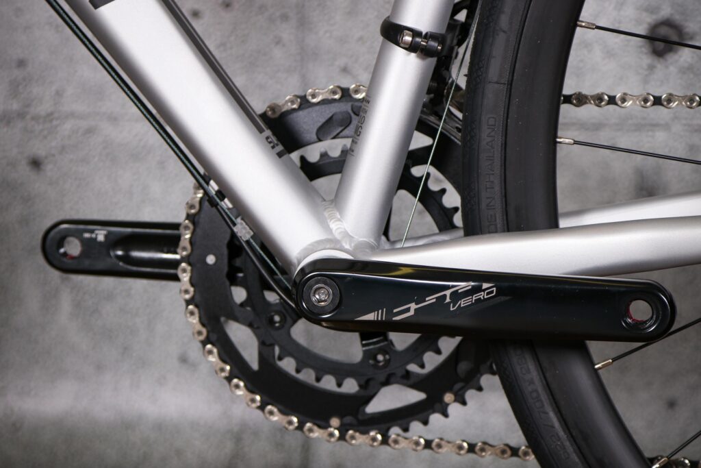

There is an FSA Vero Compact chainset, which requires an old school square taper bottom bracket, driven by a KMC chain.

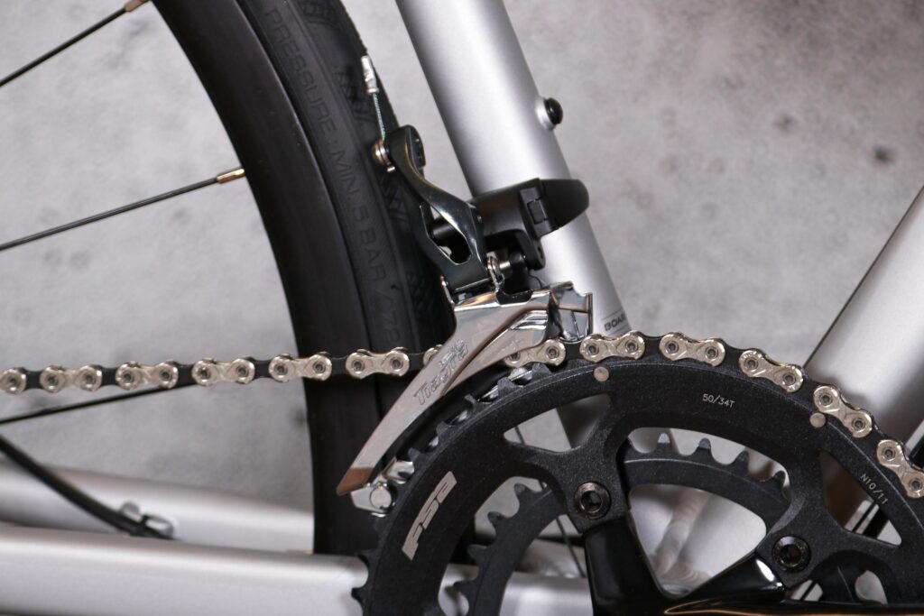

For the brakes we switch over to Tektro and its MD-C511 mechanically operated, flat mount disc brake callipers and 160mm rotors.
It’s all a bit pick ‘n’ mix but to be fair it all works, and it’s the kind of setup I’ve been seeing on bikes much higher up the price list from other brands.

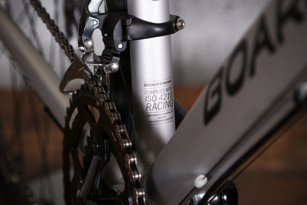

2022 Boardman SLR 8.8 – front mech (Image Credit: Farrelly Atkinson)

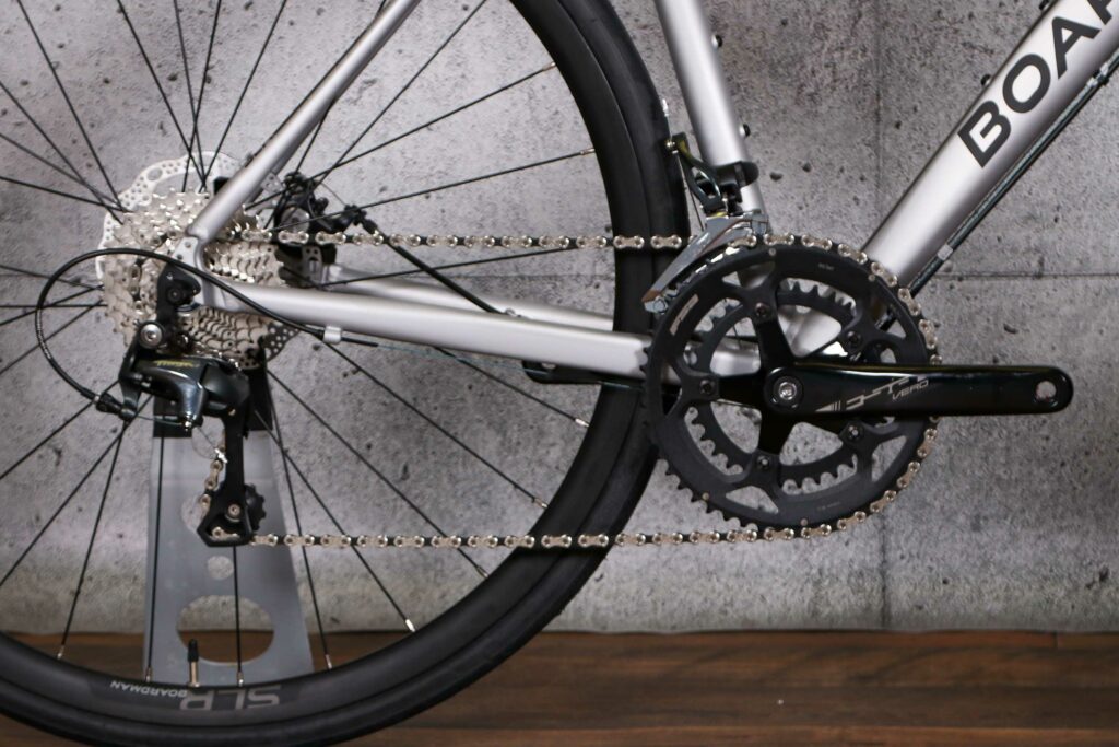

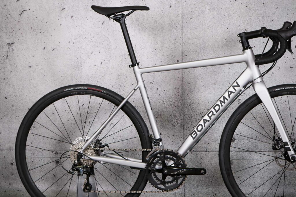

Starting with the gears, you are looking at a 50/34-tooth chainset paired to an 11-32 cassette. Not a massive spread of gears, but I’d say plenty for the majority of road riders. You can get an 11-34 Tiagra cassette, but with only 10 sprockets, going wider will create bigger gaps than there already are – although, on the flip side, if you are relatively new to the sport you’ll probably not find much need for the 50×11 top gear.
2022 Boardman SLR 8.8 – drivetrain (Image Credit: Farrelly Atkinson)
You can get a Tiagra cassette with a 12T smallest sprocket, but it only comes with a 28T at the other end.

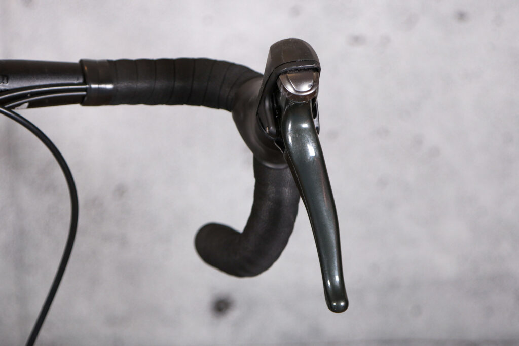

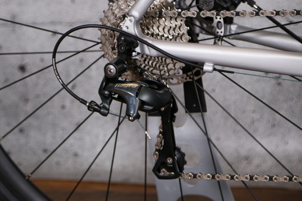

The shifting quality is good; it lacks the definition and weight in the click of Shimano’s higher end mechanical groupsets from 105 upwards, but it still can’t be faulted, especially when you take price into consideration.
Tiagra is available as a hydraulic braking groupset, but to keep costs down Boardman hasn’t gone down that route, instead mating Tiagra’s standard mechanical levers with the Tektro callipers.
2022 Boardman SLR 8.8 – lever (Image Credit: Farrelly Atkinson)

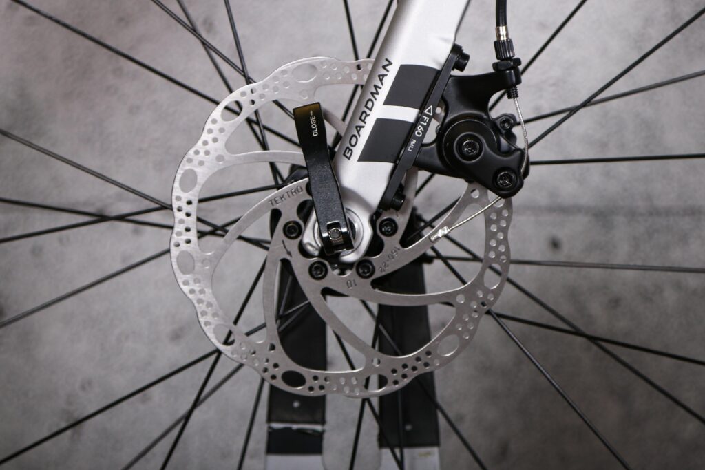

Regardless of the brand, mechanical braking systems lack the bite and modulation of a hydraulic system. In fact, some don’t even offer the performance of a quality cable-operated rim brake setup.
2022 Boardman SLR 8.8 – front disc brake (Image Credit: Farrelly Atkinson)
These Tektro MD-C511s aren’t bad, though, especially once they have bedded in a bit. The power on offer is pretty good, and once I adapted (I’m currently riding five different bikes a week with all kinds of setups), I had plenty of confidence in them, with only the steepest technical descents seeing me squeeze the lever as hard as I could.

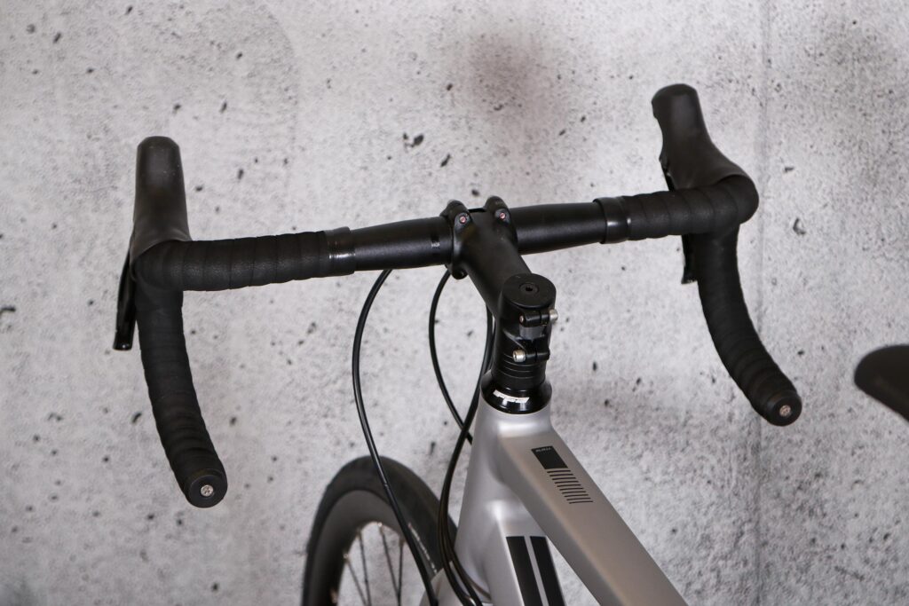

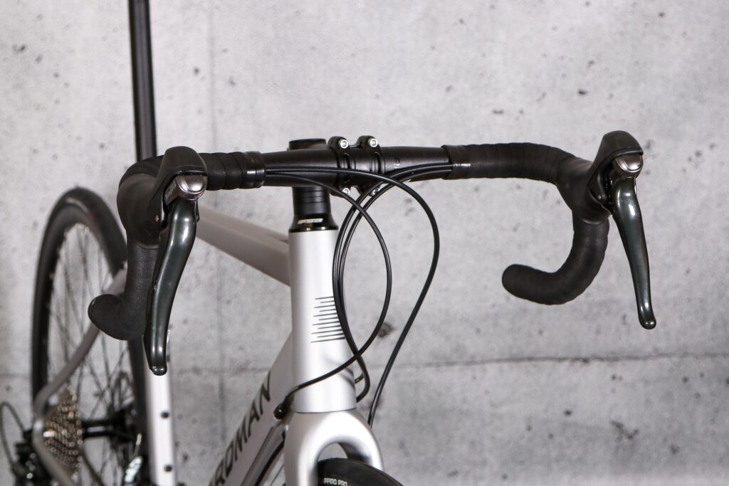

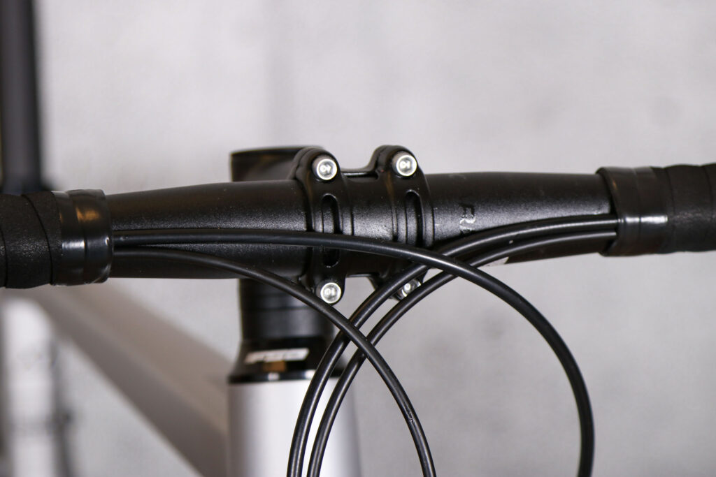

As expected on a bike of this price, the finishing kit is own branded and basic. There’s nothing wrong with that – how exciting can you really make a stem or seatpost in terms of the job it needs to do?
2022 Boardman SLR 8.8 – bars 1 (Image Credit: Farrelly Atkinson)
It’s all aluminium kit and decent enough. The handlebar is your now standard compact drop shape, while the seatpost is easy to adjust and holds the saddle securely.

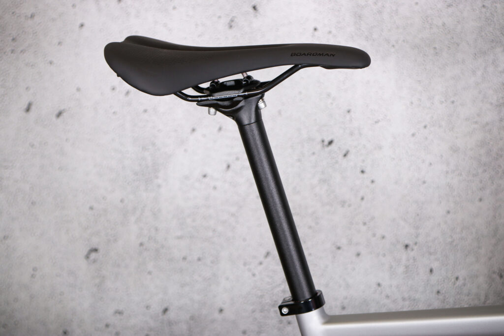

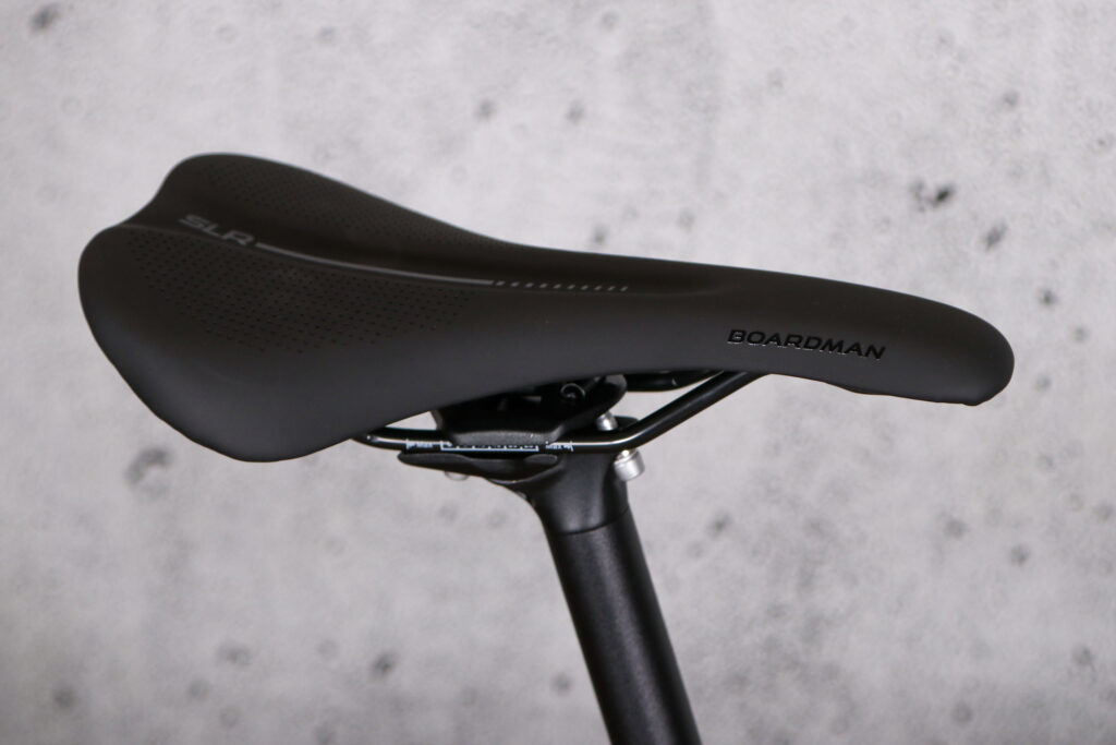

The stem is stem-like, while the saddle is a favourable shape for me – quite slender, with supportive padding.

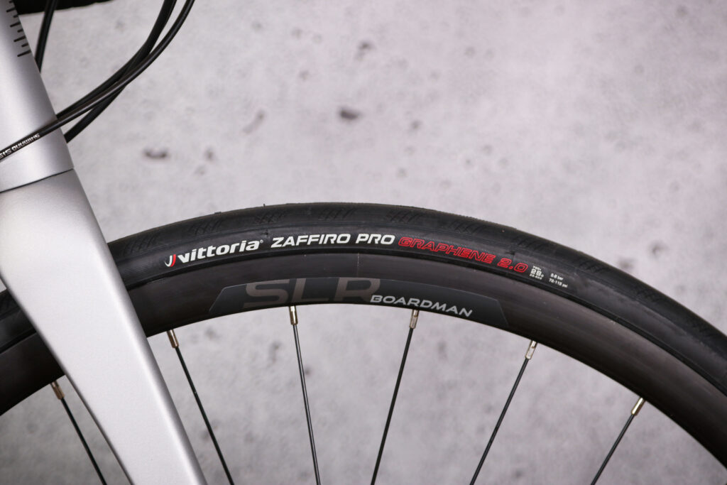

The wheels aren’t off the shelf either. It’s a mix of Boardman branded SLR rims, which are tubeless ready, laced to Formula DC-20 (front) and DC-22 (rear) hubs via 28 spokes.
Being tubeless ready is great, as it’ll just take a tyre and tape upgrade if you want to go down that route.
2022 Boardman SLR 8.8 – tyre and rim (Image Credit: Farrelly Atkinson)
On the whole, it’s a solid set of wheels. Not light, but dependable, and I had no issues with them throughout testing. As always, at this sort of money even a small upgrade can make a lot of difference in terms of weight, but it’s not something I’d be rushing out to do.

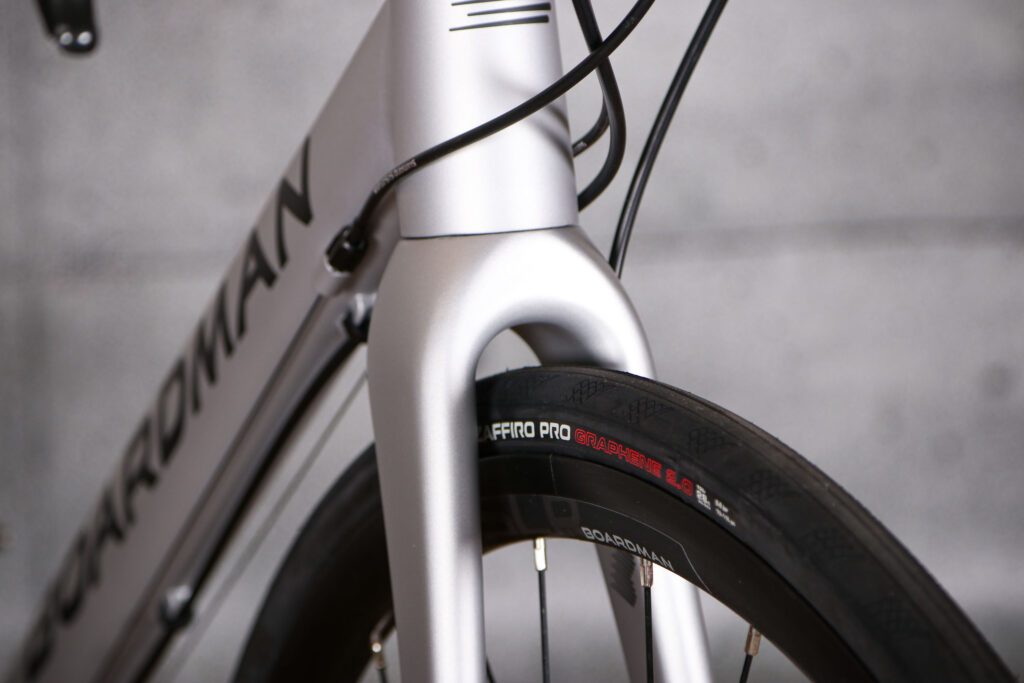

The tyres are 28mm Vittoria Rubino G2.0. Liam tested the TLR version and reckoned they’re a great option for high-mileage riders who aren’t so concerned about top speed. Rolling resistance isn’t bad, and the grip levels are reassuring in both the wet and dry.
2022 Boardman SLR 8.8 – fork clearance (Image Credit: Farrelly Atkinson)
With all of my testing taking place during the tail end of winter, durability was more of a concern than how they’d handle my favourite downhill at speed. From that point of view, they haven’t let me down, returning to Boardman without punctures or any small cuts to the rubber.

Did the bike feel stiff in the right places? Did any part of the bike feel too stiff or too flexible?
There is a hint of flex around the BB when really stamping on the pedals, but it is hardly a problem for 99% of your riding.
How did the bike transfer power? Did it feel efficient?
On the whole the SLR 8.8 feels efficient, especially considering the overall weight.

How would you describe the steering? Was it lively neutral or unresponsive? Neutral.
Tell us some more about the handling. How did the bike feel overall? Did it do particular things well or badly?
The Boardman has steering that is on the neutral side of things, but quick enough for tackling technical descents or long, flowing corners.
Which components had the most effect (good or bad) on the bike’s comfort? would you recommend any changes?
I found the saddle to offer a decent blend of comfort with support.
Which components had the most effect (good or bad) on the bike’s stiffness? would you recommend any changes?
I found the handlebar/stem combination stiff enough for out of the saddle efforts.

The drivetrain
Rate the drivetrain for performance:
7/10
Rate the drivetrain for durability:
8/10
Rate the drivetrain for weight:
7/10
Rate the drivetrain for value:
6/10
Tell us some more about the drivetrain. Anything you particularly did or didn’t like? Any components which didn’t work well together?
It’s a bit of a mixed bag components-wise, but the end product works fine. The 11-32T cassette gives a good spread of gears, but can feel a little gappy between the bigger sprockets.

Tell us some more about the wheels.Did they work well in the conditions you encountered? Would you change the wheels? If so what for?
A decent quality set of wheels for the budget and they remained true throughout the test period. Being tubeless ready is a bonus as well.
Rate the tyres for performance:
7/10
Rate the tyres for durability:
8/10
Rate the tyres for weight:
6/10
Rate the tyres for comfort:
7/10
Rate the tyres for value:
5/10
Tell us some more about the tyres. Did they work well in the conditions you encountered? Would you change the tyres? If so what for?
A solid set of training tyres that work well in most conditions.
Controls
Rate the controls for performance:
7/10
Rate the controls for durability:
8/10
Rate the controls for weight:
7/10
Rate the controls for comfort:
7/10
Rate the controls for value:
6/10
Tell us some more about the controls. Any particularly good or bad components? How would the controls work for larger or smaller riders?
Basic entry-level kit, but the shape is comfortable and very usable when it comes to the handlebar, plus the saddle offers comfort without being too soft.
Your summary
Did you enjoy riding the bike? Yes
Would you consider buying the bike? Yes
Would you recommend the bike to a friend? Yes
How does the price compare to that of similar bikes in the market, including ones recently tested on road.cc?
It’s very well priced. Ribble’s Endurance AL is £1,099 in a similar build, and Giant’s Contend AR 2 is a lot more at £1,349 with Shimano Tiagra and mechanical brakes.
Rate the bike overall for performance:
8/10
Rate the bike overall for value:
8/10
The Boardman SLR 8.8 is a very good bike that offers impressive finishing kit backed up by a great ride quality. The most impressive thing, though, is that it does all of this for a great price.
Overall rating: 8/10
