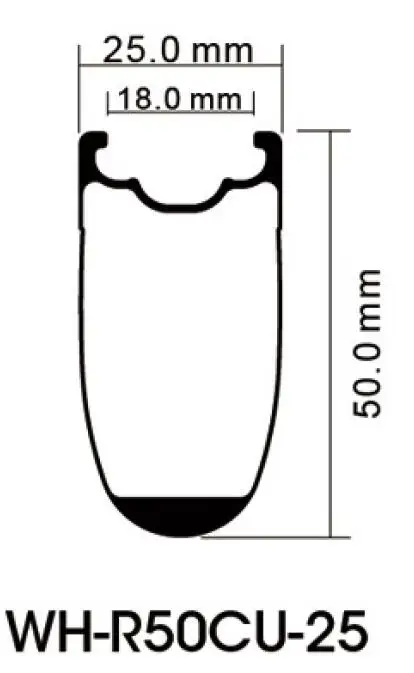

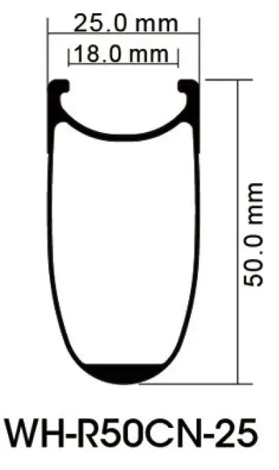

jchau | 6 years ago
Going with 25mm, the U Shape profile looks like this
Clincher only
Tubeless
Any comments on the design?

Miller | 6 years ago
Novatec hubs are excellent, I have three or four sets on the go both for rim and disc wheels. They're sensibly designed, light and with a range of sidecap options to cover various dropout standards. They take an easily available bearing size should a bearing crap out. It's easy to swap the freehub between Sh/Sr/Camp. Note that there are lots of different Novatec hubs, in general the bigger the number designation the better, eg D772 is a posher hub than D352, to take a random example.
I've also had two frames and a pair of carbon rims direct from China, all solid products giving great service.
