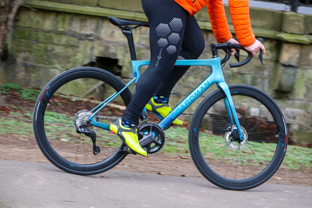

The ride
The SLR rides exactly how I was expecting it to after I’d cast my eye over the geometry table. The front end feels a little higher than a true race bike, so when in the hoods or even the drops for that matter, I didn’t feel too stretched out or that low.
It still felt aero enough, mind, and on flat sections of road into a headwind I could tuck in well enough to reduce drag.
The geometry gives a stable and balanced feel. Even at speed it feels easy to ride, with the front end feeling direct through the bends, with the rear happy to follow.
Rough sections of road don’t make it feel unsettled, and it just feels planted whether you are cruising along or giving it the beans.
There is plenty of stiffness around the bottom bracket area for sprinting or when climbing hard, and the chunky chainstays keep flex to the rear wheel to an absolute minimum.
Boardman has also focused on comfort, with slender seatstays minimising any harshness from the rear end.
It’s the same at the front, too: the fork legs are quite slender compared with many other performance road bikes. This gives a supple ride through the handlebar when riding along, but for more spirited efforts there is a small amount flex around the thru-axle mounting, showing itself as a tiny bit of rotor rub when really going for it.
Overall, though, the SLR feels quick without necessarily coming across as ‘urgent’. It delivers its speed in quite a relaxed manner, as in it never quite feels as quick as your computer screen is showing.
It’s still a capable racer, though, and because of that lowish weight and the frame stiffness, it certainly responds well to being ridden hard.

The SLR 9.6 has been around in this guise for quite a few years now, albeit with a couple of little tweaks, like losing the cable-guide entry holes on either side of the down tube to suit the latest wireless shifters from the Ultegra Di2 groupset, which gives a cleaner look to the bike as a whole.
It’s still constructed out of Boardman’s top-level C10 carbon fibre, a blend of Toray’s T800 and T1000 that creates a lighter frame than the grades used for frames lower down the range, without compromising stiffness.
That means an overall weight of 7.95kg (17.5lb) for this medium size, which is respectable when you consider the inclusion of an electronic groupset and deep-section carbon wheels.
Its design has a bit of an aero feel about it, but it’s not as sleek as some, with a lot of squared-off tube sections. But things like the hidden seat clamp assembly and the large junction between the head tube, down tube and top tube certainly give a smooth profile.
The hydraulic hosing for the brakes is directed down through the frame and fork, and you even get hidden mudguard mounting points, too, for some added versatility.
Without the guards you get tyre clearance of 30mm.
For the bottom bracket the SLR uses PF30, and while we’ve seen many brands moving away from this and going back to variations of threaded BBs, the press-fit cups here showed no issues with creaking even after some very wet rides throughout January and February.
Geometry-wise, the SLR sits somewhere between an endurance bike and a race bike.
Five sizes are available, with this medium sitting in the middle. It has a top tube length of 555mm, a seat tube length of 500mm, and a head tube measuring 160mm.
Stack and reach are 563mm and 388mm respectively, which gives a ratio of 1.45; that’s racier than some, but the overall position doesn’t seem too extreme.
Other dimensions are a wheelbase of 1,002mm, with chainstays of 415mm. The fork length is 373mm, with a rake of 48mm.
As for the angles, we’re looking at 72.5 degrees for the head and 73.5 degrees for the seat tube.
