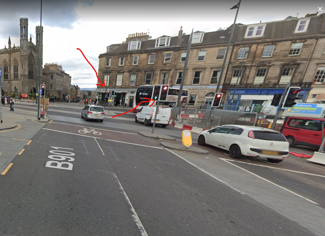

I don’t think a dual-head
I don’t think a dual-head will help, as you would still get an amber next to the ahead lane 2, when it’s only a signal for left turning traffic.
I think the best option would be to change the lights on the left to be the same as in this recent NMotD, so that no amber is shown when the left filter becomes active.

This light sequence and
This light sequence and arrangement has taken a bit of time to get my head around. As stated by others already – I think AN has totally failed to incorprate this analysis of the lights into that incident.
I think the cyclist has jumped the lights either a) on amber to get the head start without realising what the arrangement is or has been induced to by the (technically correct – I’ve asked a traffic signals designer) signals. The dedicated left turn does need a secondary signal. But, Lane 2 straight ahead is controlled by the left hand signals on the primary and the lane 3 turn right is controlled by the right hand set of signals. On the secondary set in the middle of the road, lane 2 straight head is then controlled by the right hand set of signals. The secondary for lane 3 is only a couple of metres behind the primary to the right of about where the white car is, you wouldn’t really associate that with the secondaries in the middle of the road to realise the right hand set controls lane 2 and not lane 3. That is most likely misleading and imo is the probable cause, as in the ASL you don’t look at the primary with the straight ahead arrow, you look at the secondary right in front of you. The left turn in the tram track avoidance marking sort of makes it look associated to the secondary left turn arrow. And all the signals are hooed to prevent see through, which makes the primaries harder to see from the ASL.
What my colleague did say is you would expect the right hand secondaries to be a dual head so you would have 3 sets of signal heads together that would mirror the primary heads. That, I think, would remove the confusion.
If this incident was reported it;ll be included in the stage 3 road safety audit on completion of the works and possibly bring about a change to the design that way (and also trigger a stage 4 to check up on it a year later).

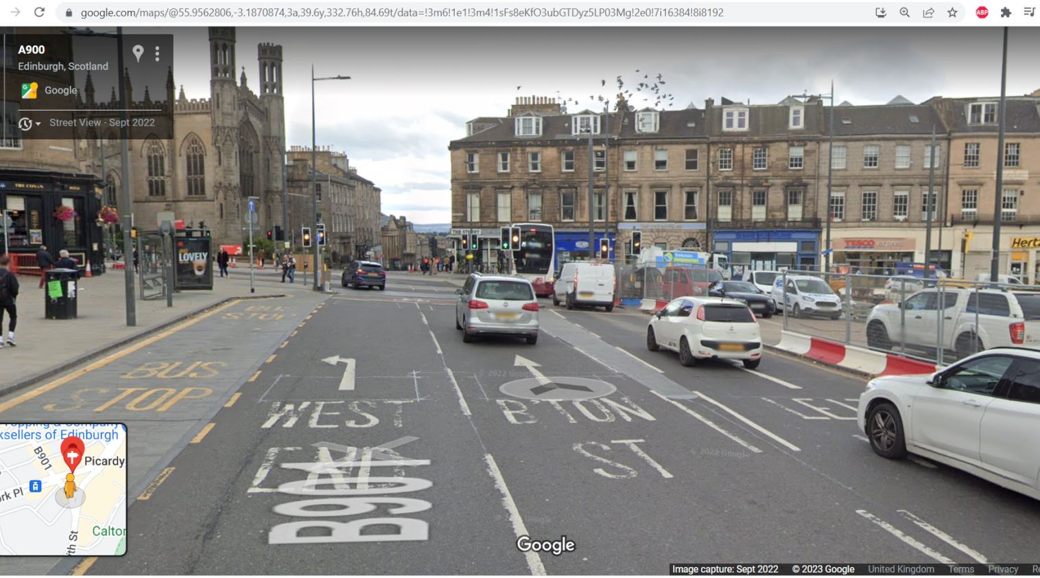

hirsute wrote:Still can’t get my head around why you would have a turn left arrow on the far ride right of a road where you can go more than one direction. How can that meet any basic design standard ?Looking at Streetview it isn’t actually on the far right side of the road. There is a third lane to the right of the traffic lights shown and the straight ahead lane crossing the junction, which peels off to turn right down York Place.
I really don’t know what that left filter arrow relates to – perhaps the left turn onto York Place, but it is placed to the RHS of the straight ahead lane.
chrisonatrike wrote:Here’s the junction with these highlighted. Note you are guided from right, over tracks then swing to left to line you up to go down Broughton Street ahead. Note also the lights – particularly the one on the right. Is it crystal clear that those in the left two lanes should only turn left and not proceed straight at this point?That junction/area is such a mess. TBH I’d probably just dismount and use pedestrian crossings, if faced with that…
(Hey, maybe that’s the intention: “If we make it confusing and messy enough, none of those pesky cyclists will actually use it”)

Excellent analysis, though I
Excellent analysis, though I think you are too hard on the cyclist. The sequencing seems to mean that they got a “green – go across”, follwoed by a “grren arrow – follow the cycle lane”, where both are entirely misleading due to the positioning of the traffic lights.
When the cyclist “went through on red”, he had a more suitably positioned traffic light showing green arrow ahead.
The blame is 90% on the murderous incompetence of Edinburgh Council.
I think the mistake that Ashley makes sometimes is to give insufficient weight to poor infrastructure. He’s right about the cammer in his vid being 0% at fault, but wrong in asserting that all that is left – 100% – is down to the person on the bike. Too much faith in junction designers on this occasion.

I’ve watched it again and I
I’ve watched it again and I think what’s happened here, is the cyclist is waiting in the cycle box at the red lights, then as the lights either side of them have turned amber, they’ve gone for it. I’m guilty of that sometimes, trying to get a head start over the baying drivers behind.
They probably didn’t even see the green light to their right was a left-turn arrow, they were past it before it illuminated. It’s a highly unusual arrangement and an illogical placement of a left-turn arrow. I can see this happening again if the junction signals are not improved.
