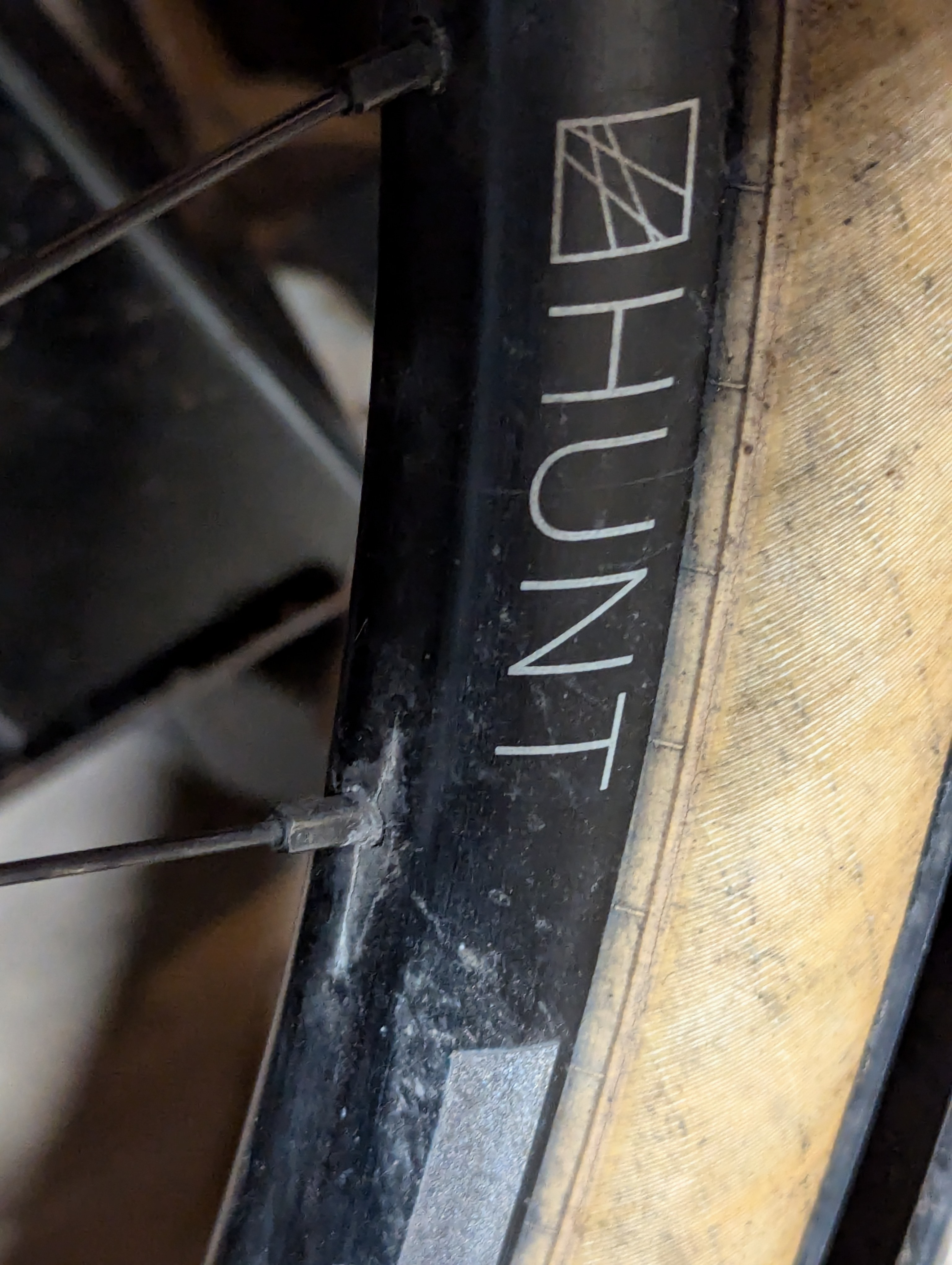

    I’ve sung the praises of the value of my Mason x Hunt 650B Adventure Dynamo Disc wheelset, which has been on my bike since I built it in early 2020, over 16000 miles ago, and needed only minor truing, but at the beginning of my LEJoG I noticed cracks around just about every other rear spoke hole. Fortunately they held up for the whole trip, but I obviously need to do something about it before it fails on a ride. I can either rebuild with a new rim on the same hub, or just replace with a new wheel that has a Shimano 11-speed compatible driver.
    The current rim is 28 hole, 25 mm internal, 28 mm external. Disc brake only, tubeless compatible. Possibly looking for something with eyelets this time. I’d like to get something that will last at least double that 16000 miles. I run 48 mm tyres.

    Here’s a photo of one of the
    Here’s a photo of one of the cracks, which I’ve sent to Hunt. Still awaiting a response.
    https://cdn.road.cc/wp-content/uploads/roadcc/PXL_20240922_055107867.jpg
