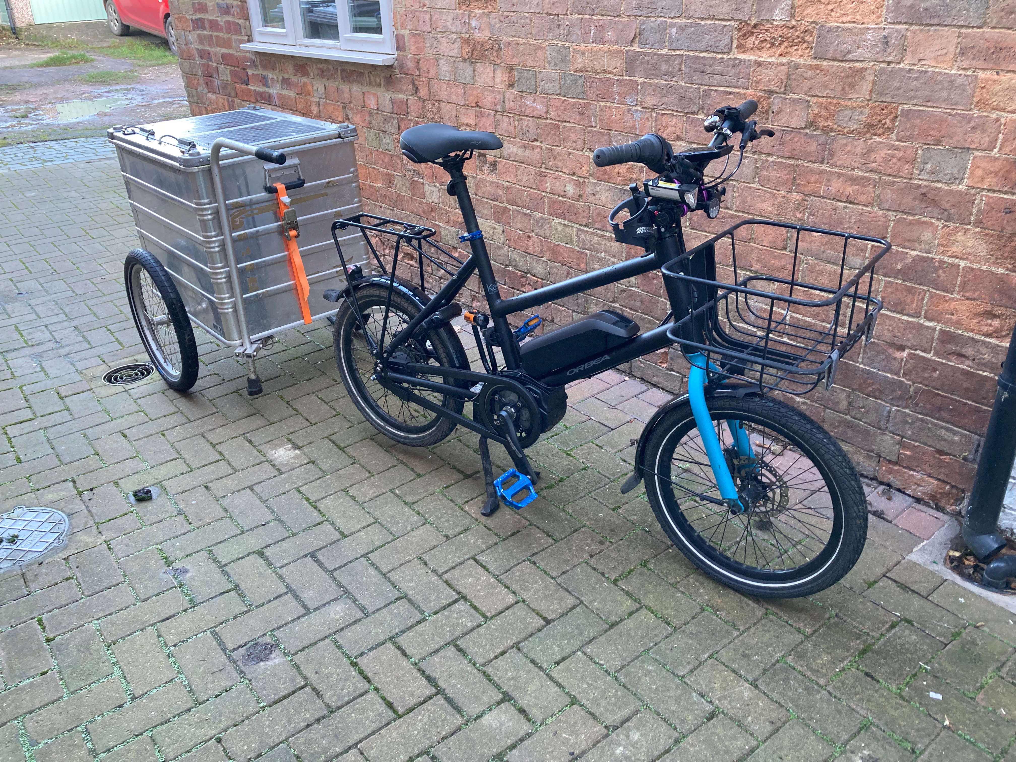

    #988149
    Creakingcrank
    Don’t give up!
    Don’t give up!
    An e-bike with a trailer is an amazing transport solution. Pic of my setup here for “inspiration”. The trailer is a Carry Freedom Y Frame and the box is second hand from a military type on Ebay.
     Hirsute’s messages below are absolutely spot on. The bike in the picture has solid axles, so was easy for the trailer attachment, but I have another bike with a through-axle that also works using a Robert Axle Project axle. The axle-finder on the Robert website is pretty good (Cargo type trailers are “kid” trailers in their nomenclature) , and both Robert Axle Project and SJS cycles will help you pick the right one if you have any doublts. On my other bike, I leave the original axle in most of the time and just swap them over in a few seconds if I want to use the trailer.
    https://cdn.road.cc/wp-content/uploads/roadcc/IMG_0409.jpeg

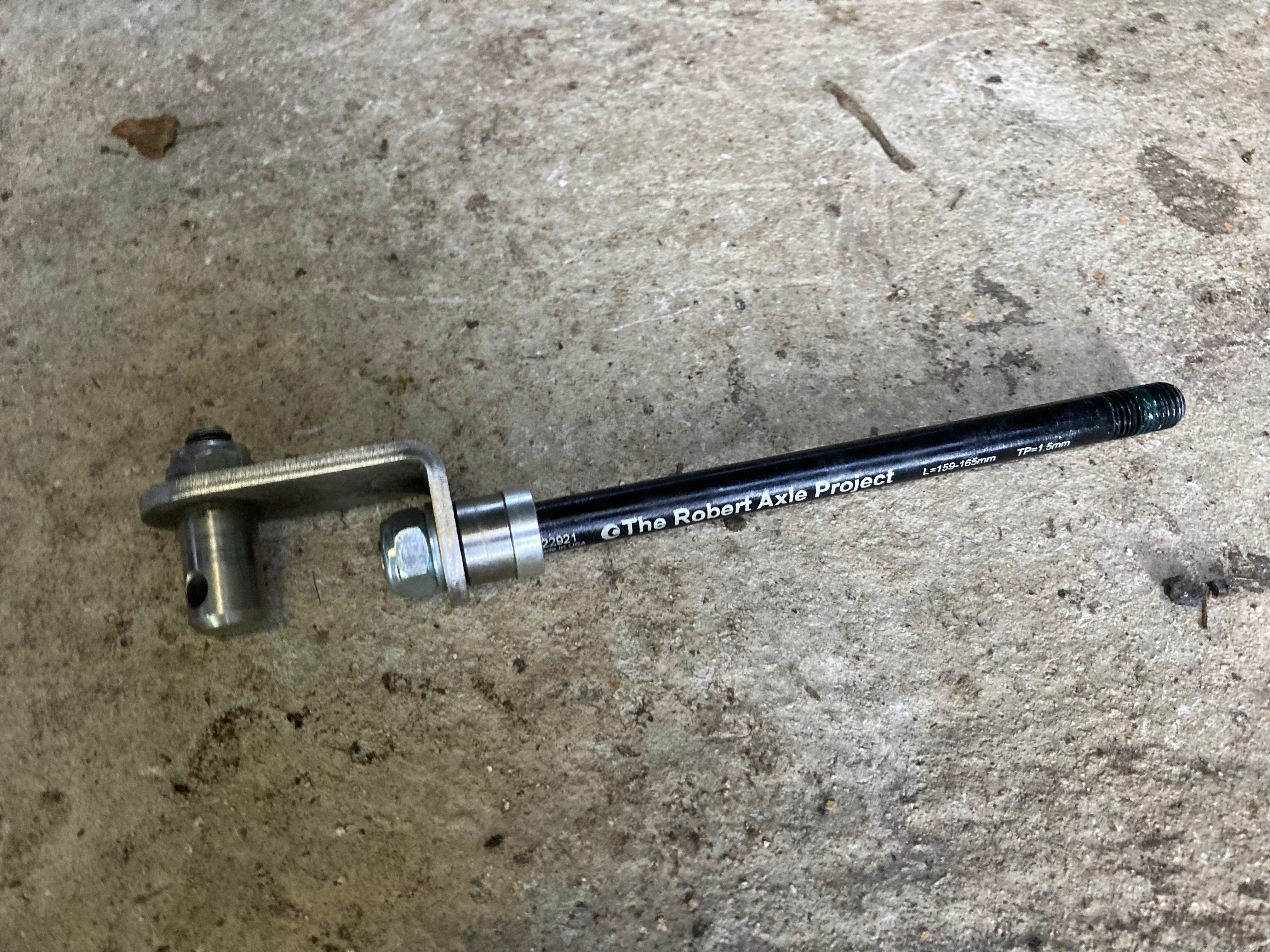

    Here is my set up.
    Here is my set up.
    The sleeve of the trailer arm fits over the hitch on the axle and then you stick the pin through to secure plus the safety line.
    In the case of QR, I’d expect a washer by the frame and the opposite side of the hitch to fit it.
    I would be very wary of screwing in a extention to an existing through axle as that to me is a significant point of failure when towing 30-40 kg.
    https://cdn.road.cc/wp-content/uploads/roadcc/axle.jpg

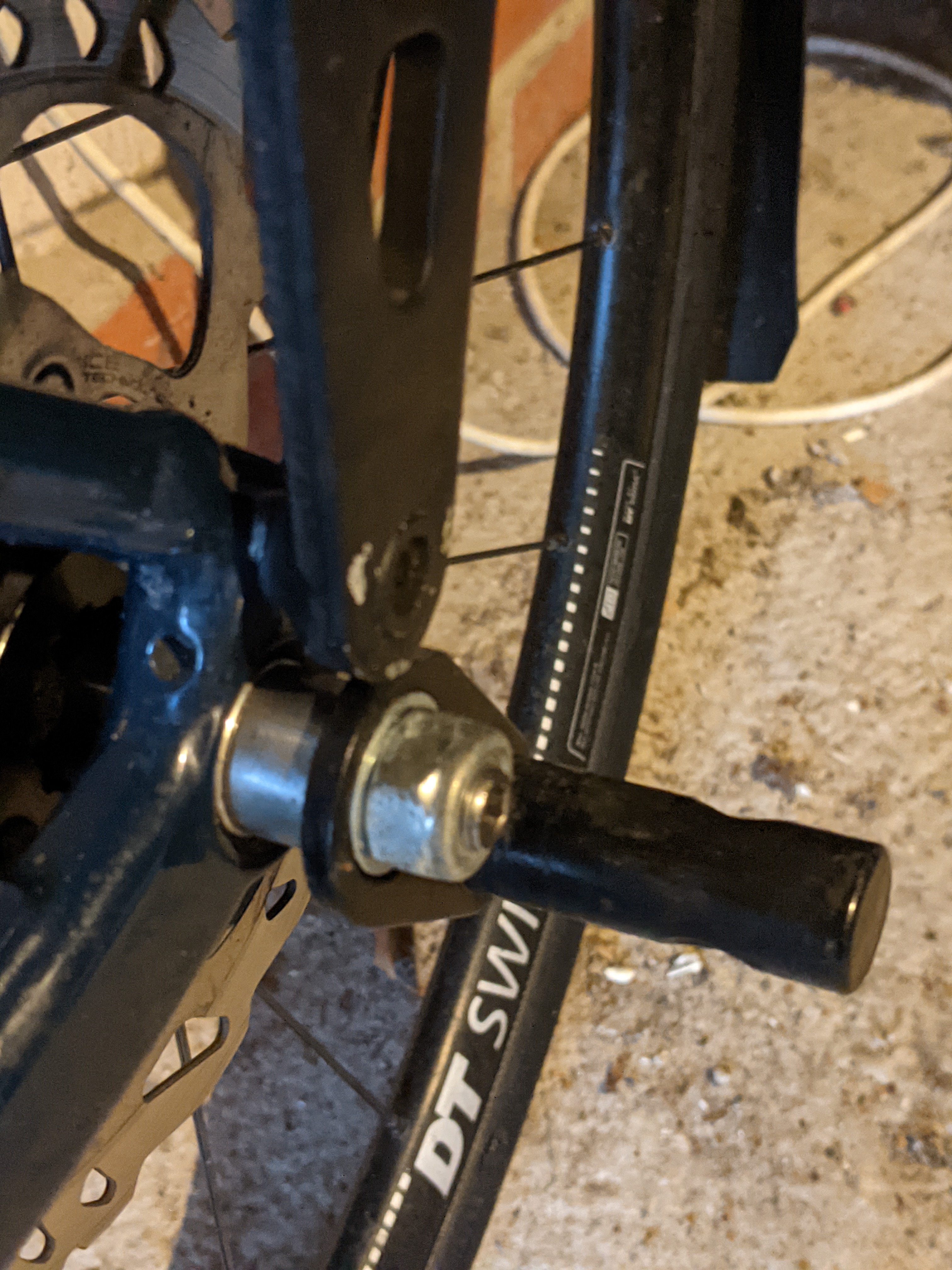

    The last time I had a trailer
    The last time I had a trailer it was connected by the type of coupling that Tom shows; however the bike had bolt on wheels and so it wasn’t a problem (or if it was I was blissfully ignorant of it).

    #988137
    Oldfatgit
    Thanks Ian.
    Thanks Ian.
    Please see my post below for an image of the thru-axles I am using.
    Currently, I have about 4mm / 3 full thread turns projecting through the drive side.
    Looking at the picture that Tom has posted of the universal hitch that he has:
    – providing that the central bore is >12mm and the counter-bore is about 1-2mm deep, in theory the existing axle could* work, providing their design parameters aren’t exceeded.
    * could because anything could work – it’s just how safely (and how expensive the fix).

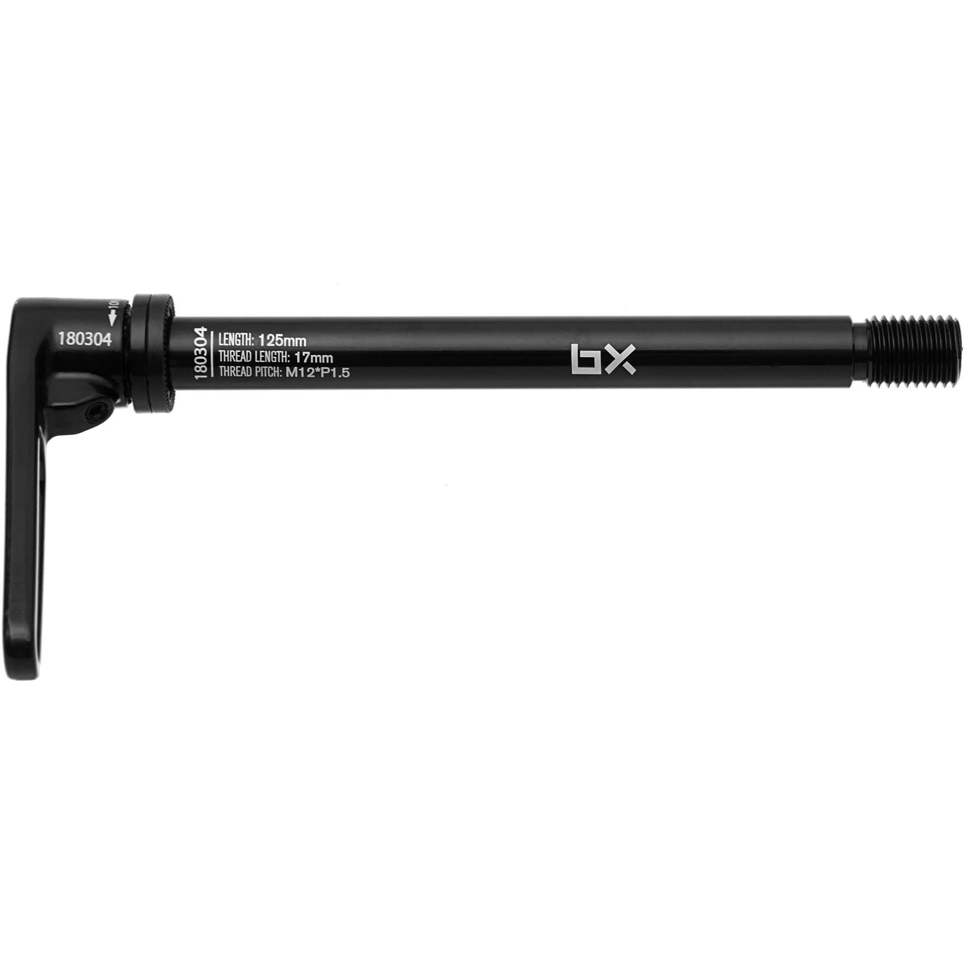

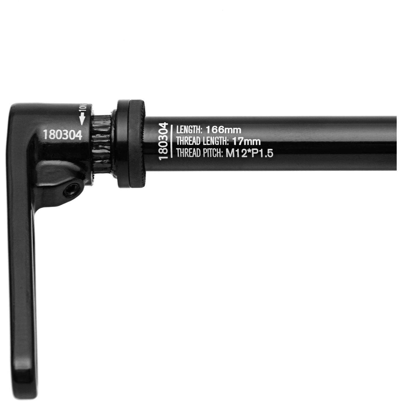

    #988135
    Oldfatgit
    It’s not a true QR as in a
    It’s not a true QR as in a skewer.
    It’s a QR head thats been fitted to a thru axle.
    Basically, there is a lever head that means you can get rid of having to faff around with a hex key to undo it.
    https://www.wiggle.co.uk/brand-x-twist-lever-thru-axle-1
    https://cdn.road.cc/wp-content/uploads/roadcc/Brand-X-Twist-Lever-Thru-Axle-Quick-Release-Skewers-Black-NotSet-BXTLTA12125.jpg
