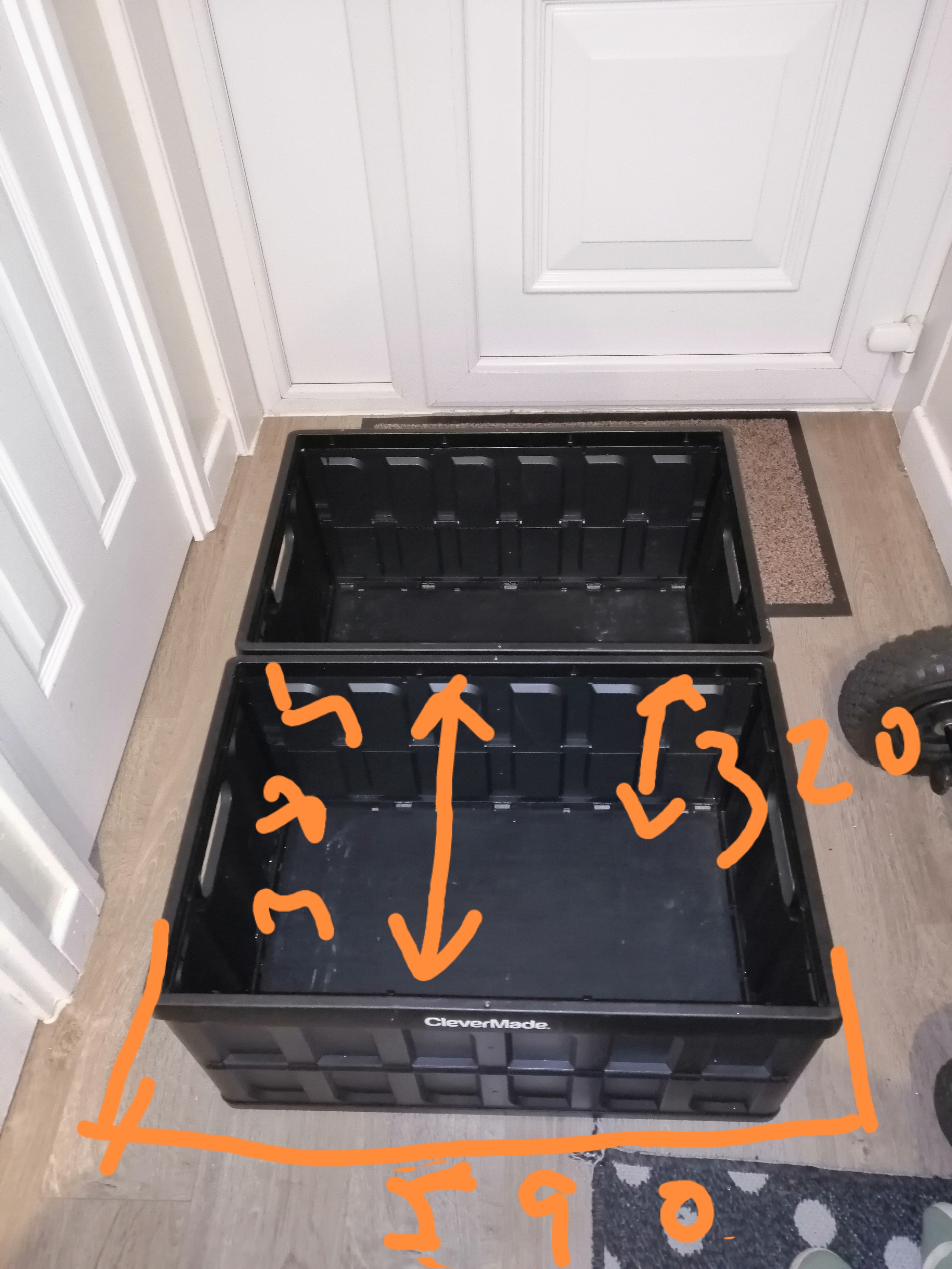

Oldfatgit wrote:
Oldfatgit wrote:Tom_77 I have a couple of crates that I use when shopping with the car. Will these be able to fit in your trailer and be secured? Length 590 X w 385 X h320 each unitThe internal area is approx 53 cm wide by 67 cm long. Height with the cover on is about 36 cm.
I use a couple of large Ikea bags along with a few reusable supermarket bags, take the cover off and stick a cargo net over the top.
