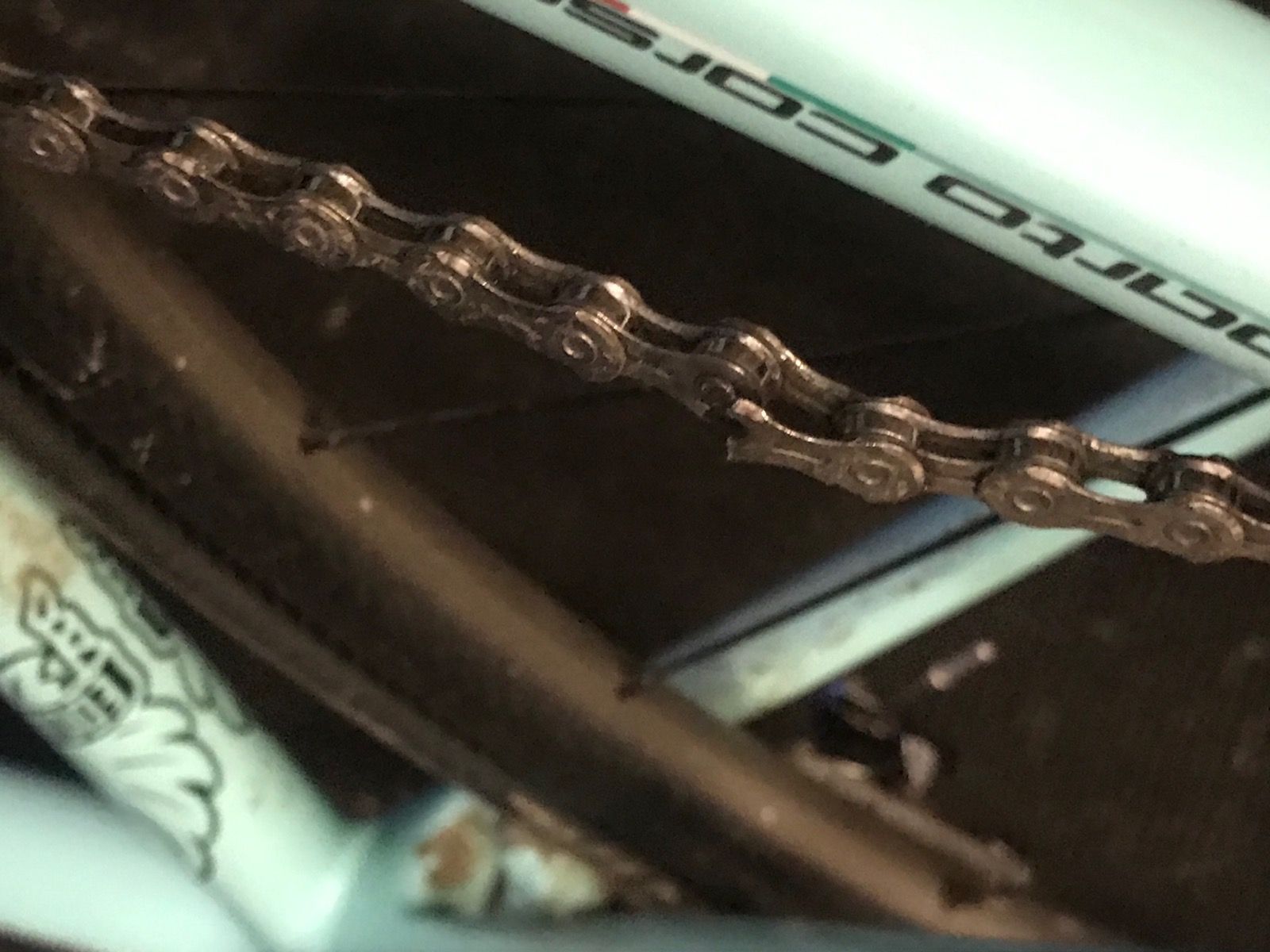

    This happened to a mate
    This happened to a mate yesterday evening. He, like you doesn’t carry a spare link and chain break tool. Luckily he was only a few miles from home and his wife popped out in the car to pick him up. I did 100 miles yesterday, and would hate to have to call someone out or try to get home via trains, or a lift to a bike shop, all for not carrying a tiny part and a small multitool with a chain breaker, especially when in the middle of nowhere in what was a freezing wind yesterday.
    It doesn’t happen often, but I can recall it happening to three mates over the last 5 years or so.
