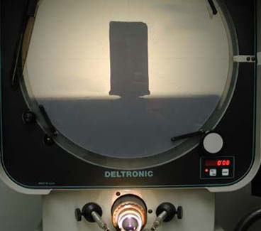

At the risk of being perceived as patronising again, your method of pushing a pin partially out and reusing it is not best practice and creates a weakness in the chain at that point. Here is an extract from a Park Tool blog as to why;
Chain Installation – Derailleur Bikes explains why you shouldn’t do it.
Some chains, including Shimano®, use chain rivets which are peened. This creates a “mushroom” effect at the ends of the rivets, which adds to the strength of the chain side plates. When a rivet is pressed even partially out, this peening is sheered off on the side pressed by the chain tool. If this rivet were reused, it would create a weak link at that rivet. In the image below, a Shimano® rivet is shown in an optical comparator, which magnifies the rivet. The original peening is seen at the bottom of the rivet. The top of rivet has the peening sheered off. This top section was pushed through the outer chain plate.
