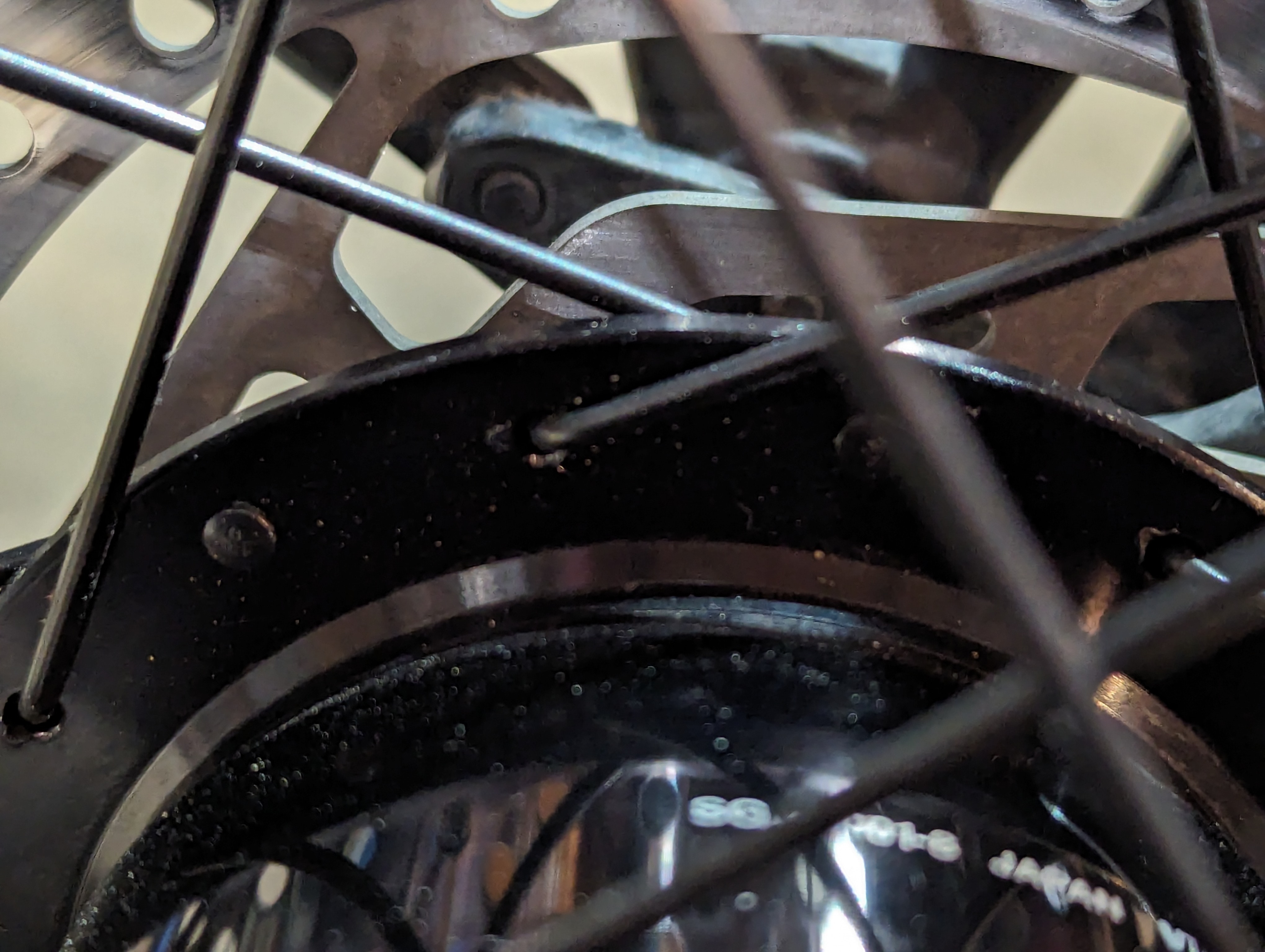

    I got it back a few days ago.
    I got it back a few days ago. The new and old spokes measure right at 2 mm, so 14 gauge. They’re built three cross, but the third cross is basically behind the flange.
    I still haven’t had a chance to check the tension.

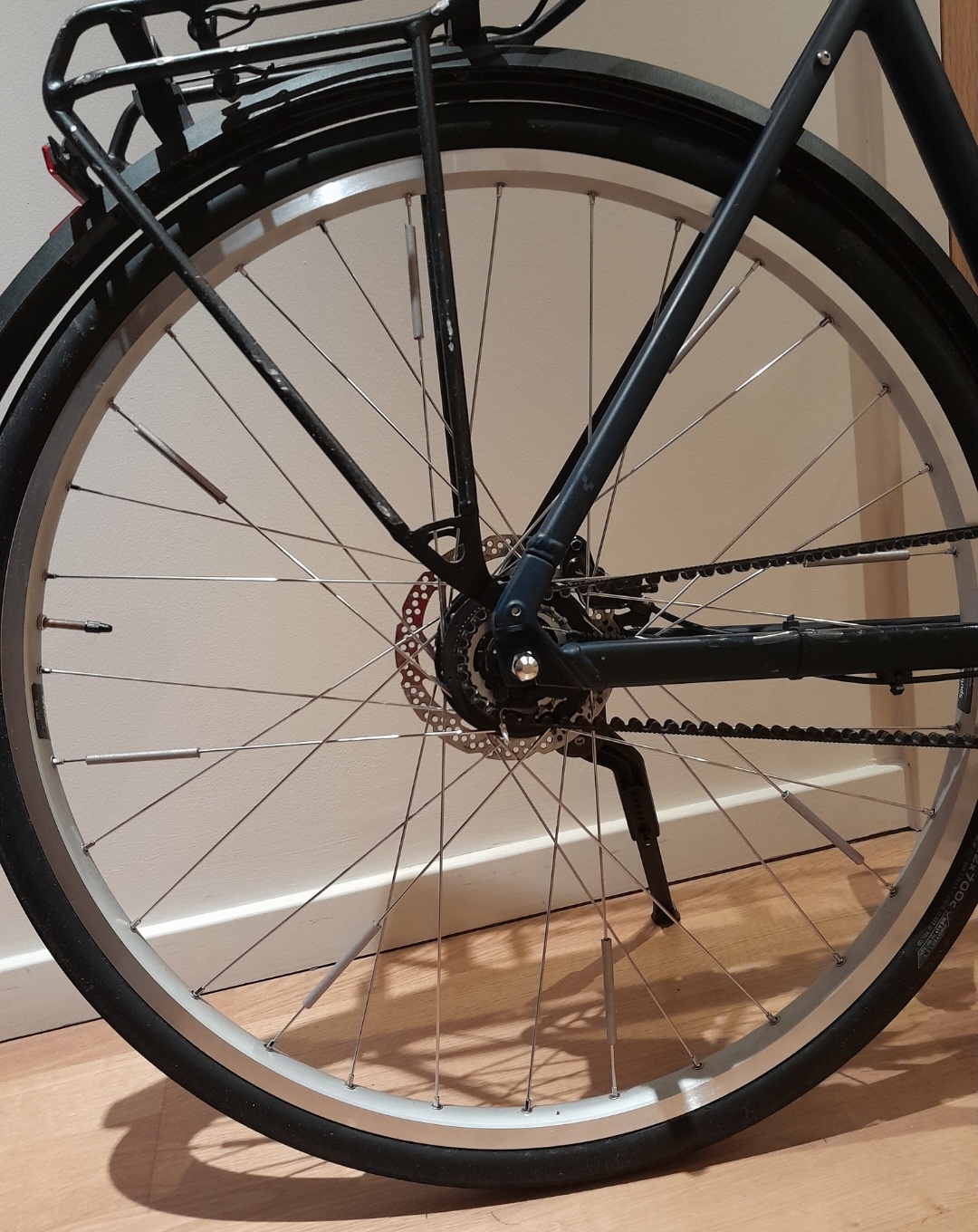

    I’ve one of these (also 32
    I’ve one of these (also 32 spokes, Ryde sputnik rim (622x19c rim), not sure the spokes, 3 cross). Just by eye the alfine hub appears to have a thick flange not just a wide one (but haven’t checked with a gauge). That wouldn’t explain issues at the nipple ends though. As others say perhaps lacing pattern?
    https://cdn.road.cc/wp-content/uploads/roadcc/Screenshot_20240210_215748_Gallery.jpg

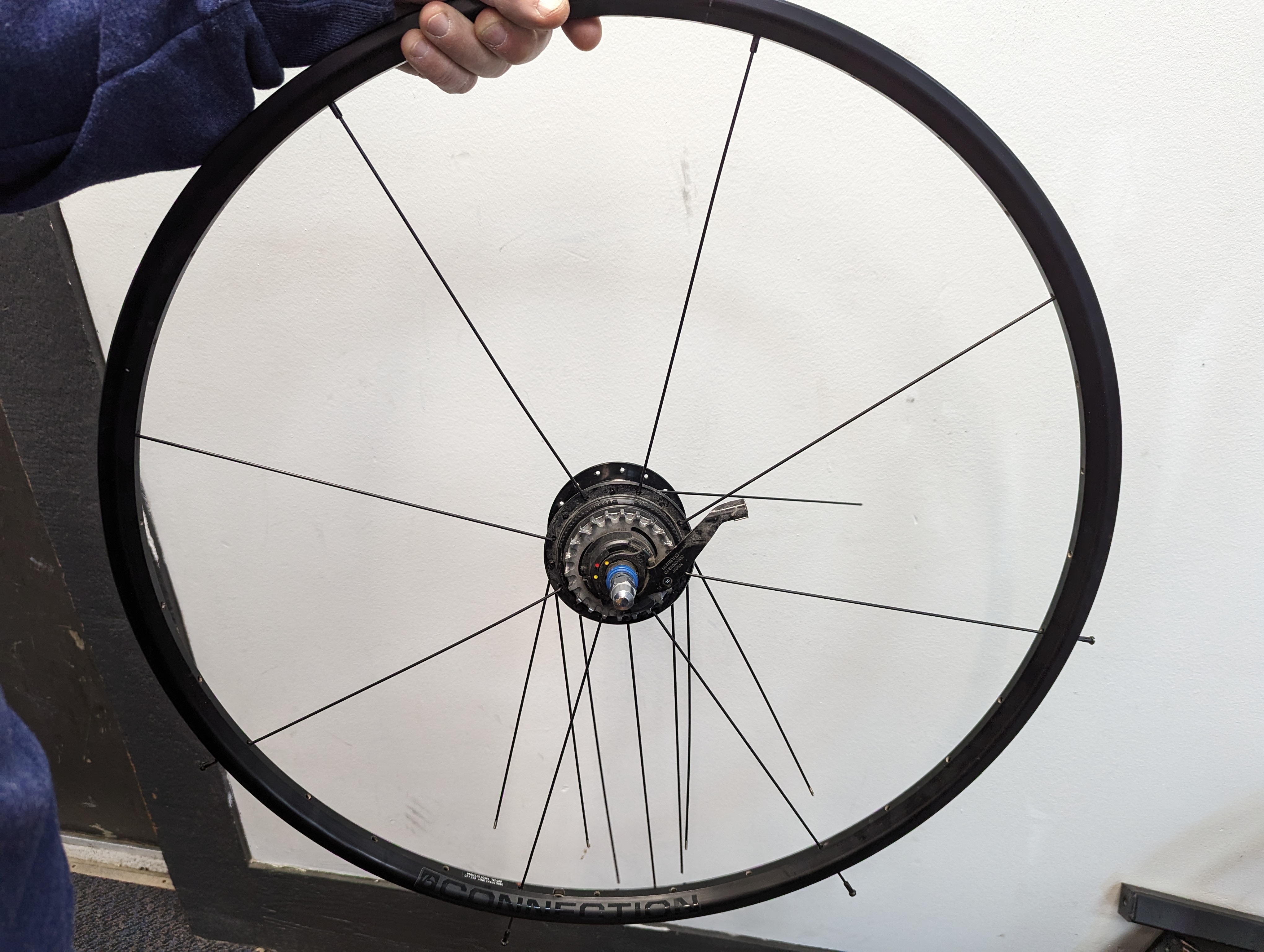

    I stopped by today to buy a
    I stopped by today to buy a couple of things, and this is the state of my wheel. He’s rebuilding it three cross with all new spokes.
    https://cdn.road.cc/wp-content/uploads/roadcc/PXL_20240210_194935401.jpg
