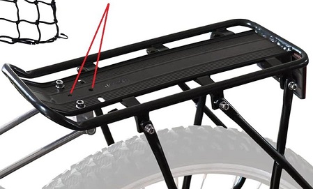

    If the single hole you’re
    If the single hole you’re referring to is the one on the brake bridge then racks which have a ‘bed’ (rather than just a frame) often have holes for a single fixing strap to connect to the brake bridge – see pic.
