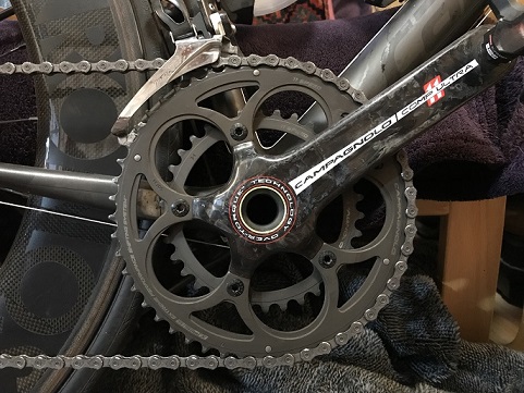

jaysa
I’ve run a Campy Ultratorque
I’ve run a Campy Ultratorque chainset on my Supersix Evo, which I think is Pressfit, for the last 5 years – no creaks, changes great with a Shimano front derailleur, its lasting well and looks great I think?

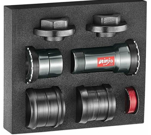

Themadchemist wrote:Just an update.. I bought the 5800 crank arms to use with some 6800 chainrings I’d bought last year. Turns out these chainrings are R8000,not 6800 as advertised,so they ended up on ebay and I’ve found a Rotor 3d24 with Q rings that will get fitted when I get the time during the winter. I’ll let everyone know how I get on with the Q rings when I use them next year. Again,thanks for all the help and suggestionsDid you find which BB is installed? Is the 24mm spindle running on adapters in a press-fit BB30/PF30 shell/bearing?
If that is the case and you want to replace it, then you could go for the Token Ninja kit. It will come with the suitable adapters for the BB30/PF30 shell and you’ll have peace of mind, knowing that you’ll have a “screw-in” BB. better to have the 24mm spindle load on bearings meant for a 24mm spindle, than on a 30mm bearing with adapters in between. This way the adapter interface is with the BB shell and it is all clamped together with the screw thread of the Ninja BB/.

If, as has been mentioned in
If, as has been mentioned in other posts, the SL4 generally runs with a BB30 set up, then go for Rotor 30mm crank and change the BB to suit.
The problem with fitting a bottom bracket to suit a 24mm spindle is that you’d need adapters. But, if the bike is designed to work with a BB30 originally, and is then fitted with a 24mm crank (cost? availability? – with adaptors), it makes sense to go back to the BB30.
Token do numerous Ninja BBs to suit, they’re not overly expensive, and once any pressfit (nuisance) has been removed, no more creaky BBs.
I have token BBs on 2 of 3 of my road bikes, and will certainly replace my 3rd bike BB with one when the time is due.
