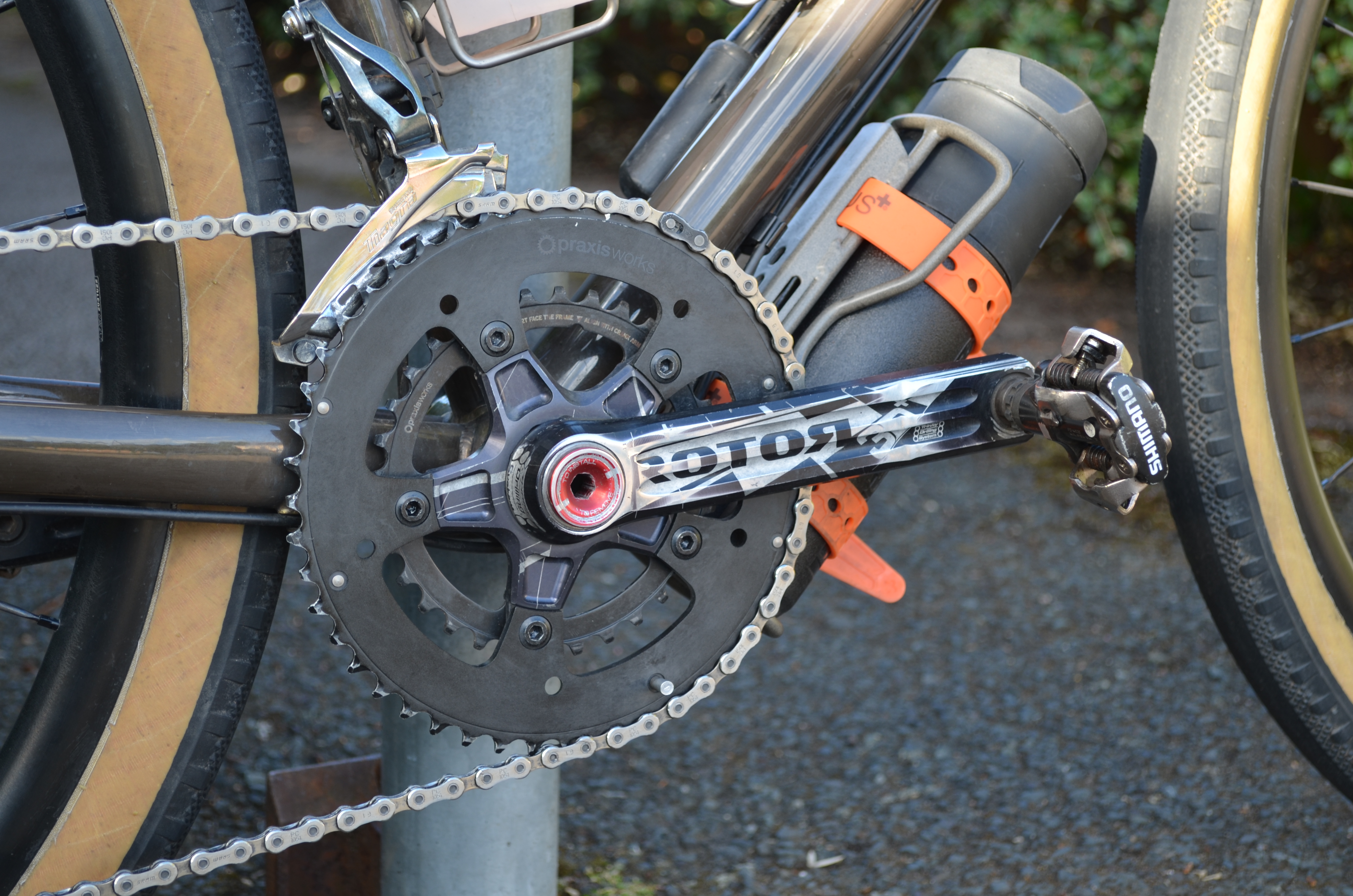

    Rotor 3D+ cranks are great. I
    Rotor 3D+ cranks are great. I have them in a 30mm spindle diameter to fit my Rotor T47 bottom bracket, but they do make them in a 24mm to fit a typical Shimano Hollowtech-II compatible bottom bracket. As with the Praxis cranks mentioned below, pretty sure you can also use direct-mount chainrings, a 5-tooth spider or a 4-tooth spider. I use a 5-tooth 110BCD spider, which very handily fits Praxis chainrings too so you’re not splashing out.
    Another plus – if subjective – they look fantastic, too!

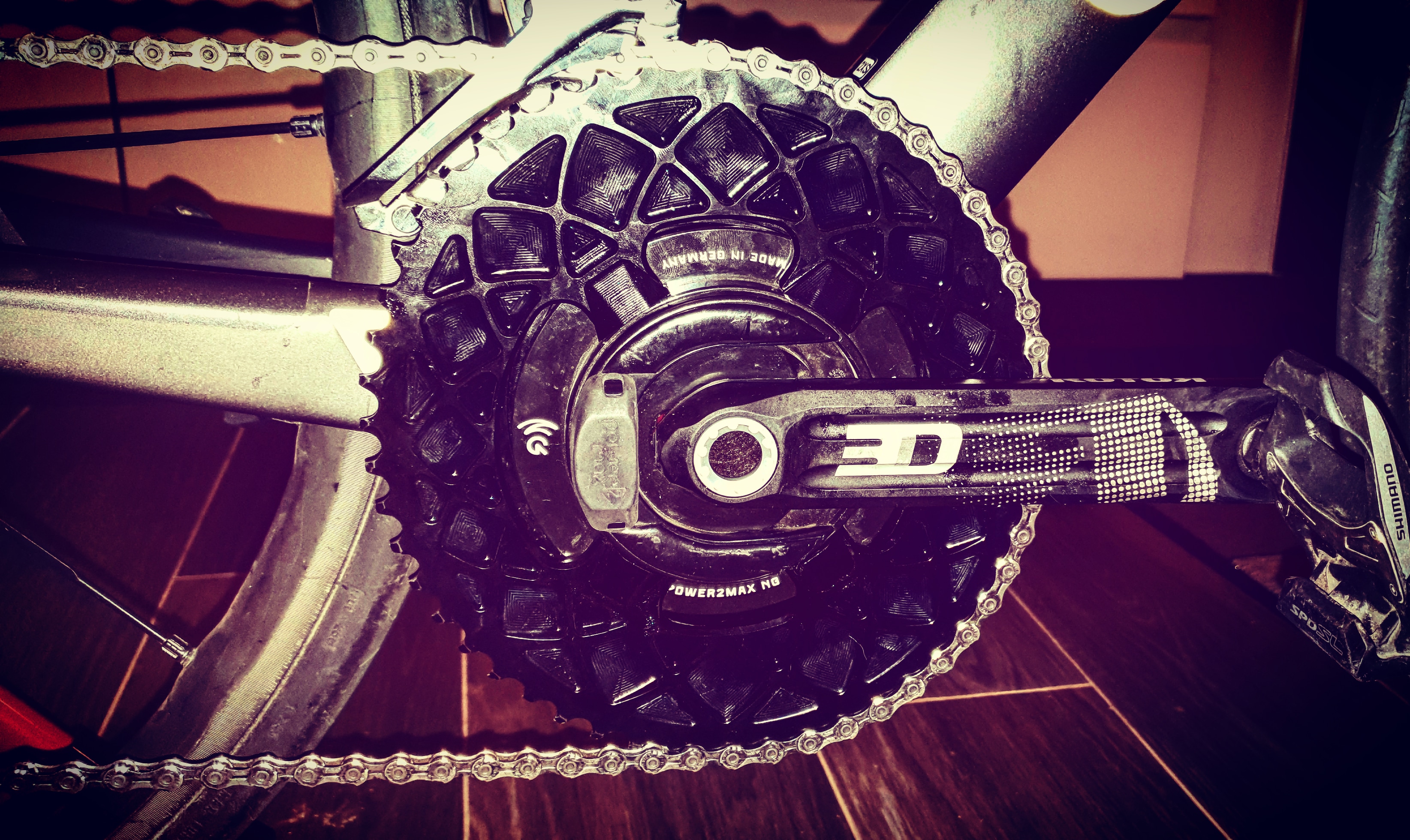

    I run Rotor 3D24, 165mm
    I run Rotor 3D24, 165mm cranks on a Power2Max NG Eco spider and 52/36 Absolute Black chainrings. These replaced a 6800 setup. Aesthetically better looking than the Shimano, and stiffer. Also replaced the BB with a Token Ninja TF24 so no more creaky pressfit shizzle.
