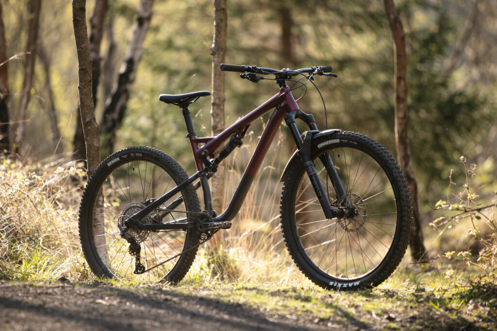

The Boardman MTR is a short travel trail bike which offers a range of functional specs at an accessible price. The 8.9 proves to be an engaging and rewarding ride on the smooth-flowing trails, yet thanks to some competent suspension, it can equally handle the rougher stuff. A higher-rise bar and longer dropper post would help with confidence on the steeper descents however, it’s a solid performer for the price tag.
Boardman MTR 8.9 – Technical details
The MTR is Boardman’s offering for a short travel trail bike with up-to-date geometry and a range of spec options to make mountain biking accessible without breaking the bank. The aluminium frame offers 120mm rear travel through a four bar layout with a pivot on the chainstay. The suspension layout is said to be progressive giving suppleness for grip and support deeper into the travel through compressions and drops.
The frame features internal routing, mounts for a bottle cage and utilises the readily available Universal Derailleur Hanger (UDH).

Available with 29” wheels only, it’s clear this bike is intended to carry speed and be efficient on the pedals. The geometry backs this up, reinforcing the trail intentions with reach numbers starting at 440mm and growing 20mm per size, with the large sitting at 480mm. A 65.5 degree head angle keeps steering lively whilst the 440mm chain stays (across all sizes) should keep things stable at speed.
An effective seat angle of 77.5 degrees is purposefully steep clearly aimed at a strong and efficient seated position. A slight kink in the seat-tube approximately half way down may not be useful for anyone looking to fit big-drop dropper seat posts. On that note, the MTR comes with sizes specific dropper post lengths – the S and M get 125mm drop whilst the L and XL see a 150mm dropper. The stack height is on the low side, which will help with weighting the front tyre for grip, but could be less inspiring when the trails start pointing downwards.
