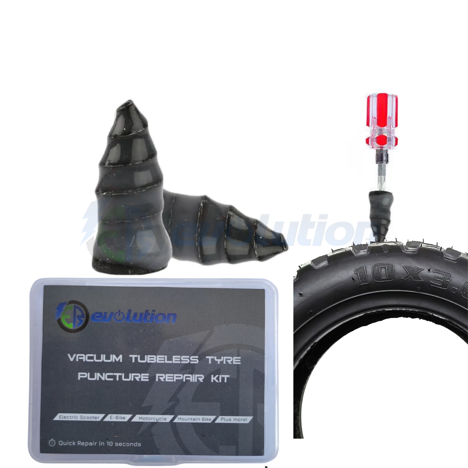

    mark1a wrote:
    Dynaplug looks good if it does as it says (reacts with Stans sealant to seal that is).
    edit: I’m thinking of Stans Darts, I’ll look at Dynaplug.
    Their Racer kit is nice, though a bit pricey: http://www.dynaplug.com/racer.html
    I like the way they use a pointy tip to push through the tyre (which you just leave in place) as I’ve tried a cheaper kit that uses a tiny fork to push the anchovy in and I just ended up breaking one of the fork prongs off.
    Just seen that Dynaplug do a carbon fibre version of their racer kit – I think I can resist the allure of that.
    Just had an idle search on eBay and there’s tons of Dynaplug alternatives on there. Was intrigued by these bad boys: https://www.ebay.co.uk/itm/304747839252
    https://cdn.road.cc/wp-content/uploads/roadcc/s-l1600.png
