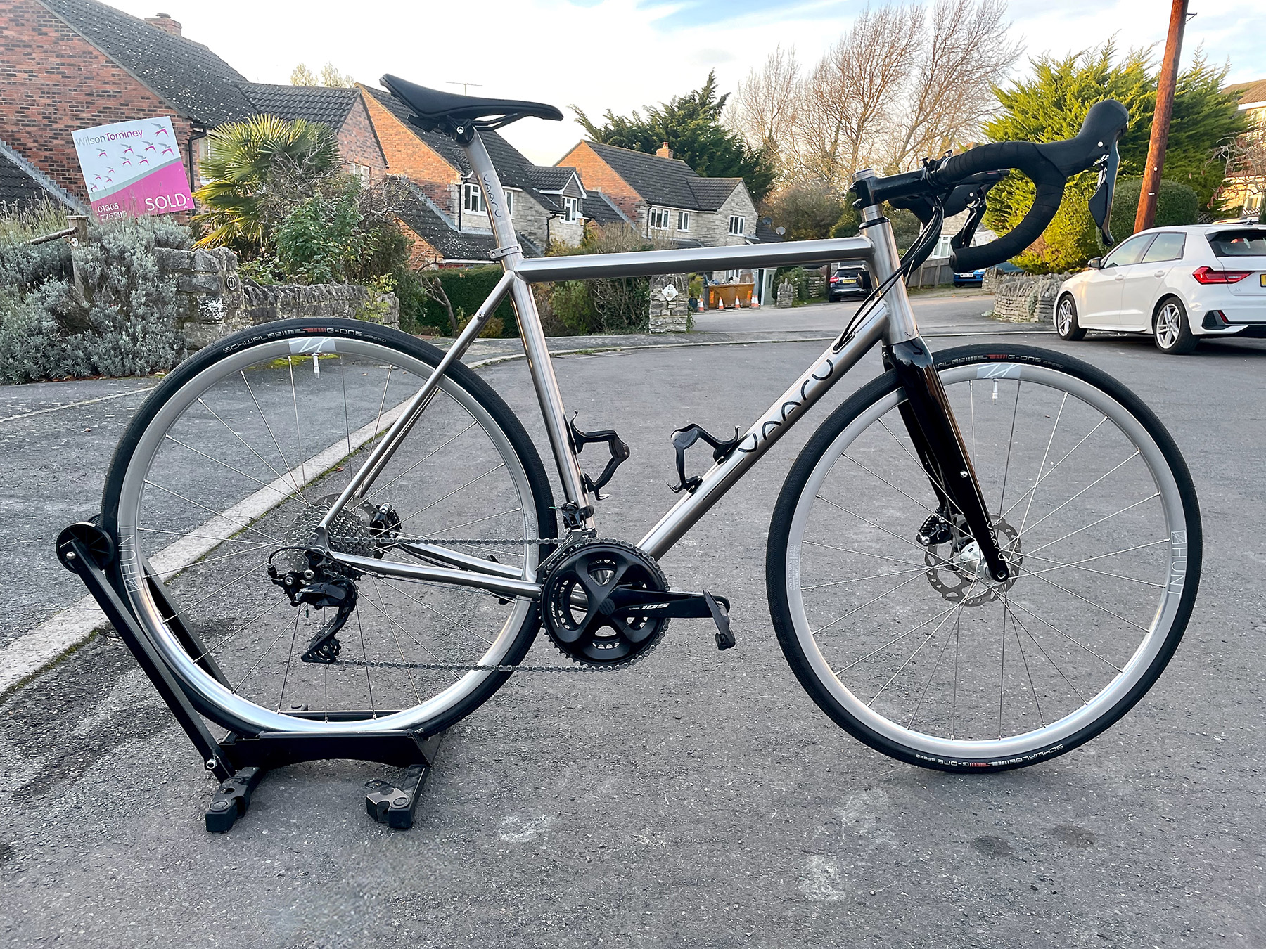

    mark1a
    I don’t think I’ve seen a
    I don’t think I’ve seen a disc brake compatible road fork with the aesthetic you describe, I’m not sure but it could be that the thin, curved design does not lend itself to the increased structural requirements that a disc caliper needs on a fork.
    Also, I’d be careful with putting a curved fork onto a bike head tube angle designed for straight forks, it’s possible that any small difference in trail and rake measurements could adversely affect handling. I’m not an expert on this, but it might happen.
    Anyway, good luck with your search, I scratched the Ti itch a year or two ago, with a Vaaru MPA. It’s not quite what you’re looking for as it has a straight carbon fork (the Ti fork option is also straight), but as my winter hack it’s a lovely bike to ride.
    [cue yet another gratuitous photo opportunity…]
    https://cdn.road.cc/wp-content/uploads/roadcc/vaaru_mpa_0.jpg
    #1022689
