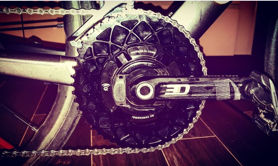

    I have a 2016 Cayon Aeroad.
    It’s fitted with a Token Ninja TF24 (BB86), a set of Rotor 3D24 cranks, Absolute Black non-round chainrings. (Power2Max NG Eco powermeter/spider)
