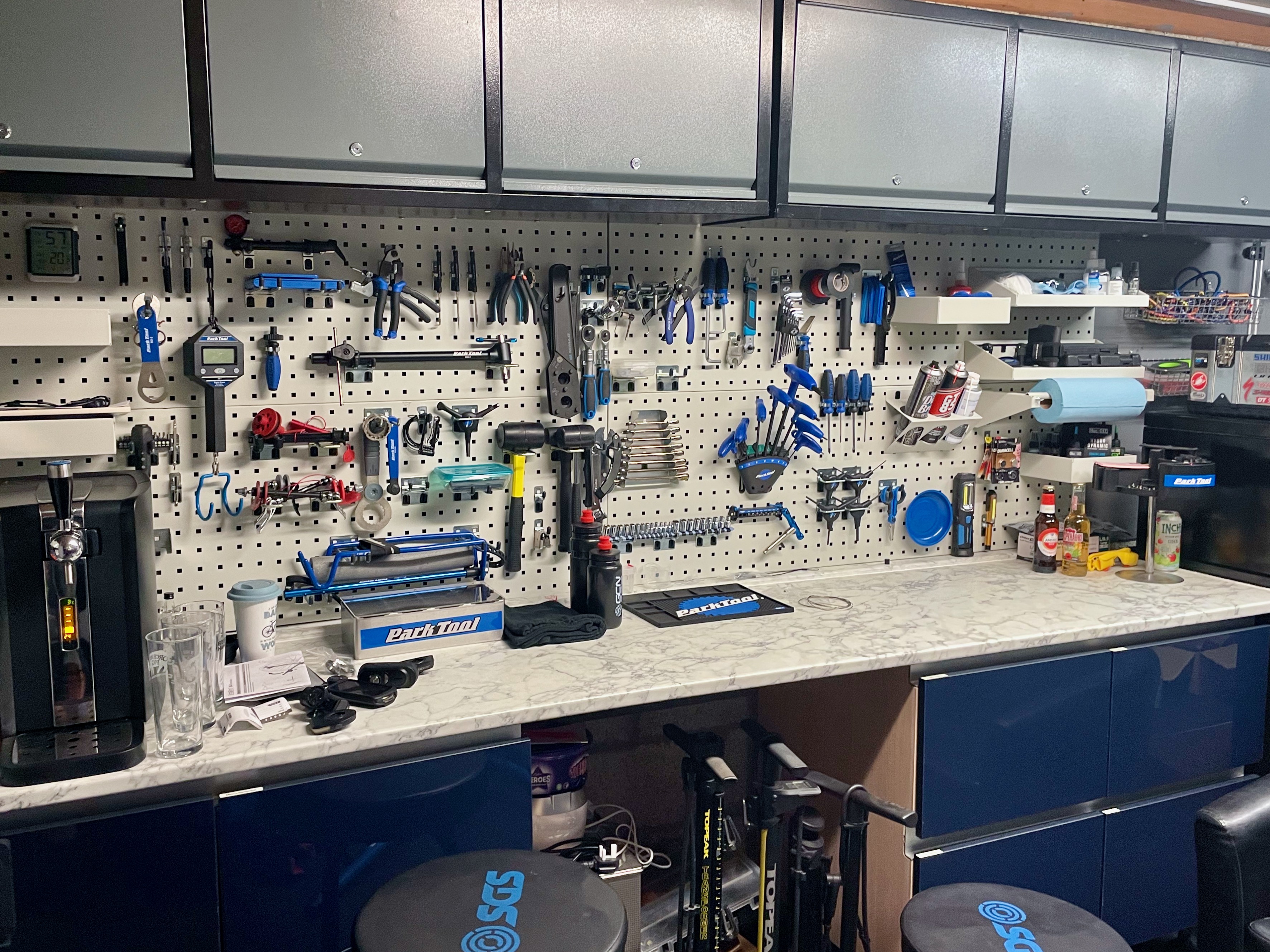

    ktache wrote:
    Are you not tempted to silhouette the tools on the peg board?
    I was at first as it happened, I remember as a kid visiting RNAS Portland/HMS Osprey back in the 80s when my dad was in the RN and all of the workshops had this, presumably to avoid leaving tools inside parts of aircraft where there shouldn’t be. However I then went on a Cytech home mechanic course and all of the workbays had this Perfolock system and I decided that was the way to go.
    My reason not to silhouette these is that the hangers & clips are very easy to move around as I decide, for example on the RH side, are the most commonly used tools, batteries, lubes, etc, and on the LH side, the less frequently used stuff.
    Sorry to hijack the ultrasonic cleaner thread, but here’s the rest of it.
    https://cdn.road.cc/wp-content/uploads/roadcc/m1a_workbench.jpg

    Thank you, although it’s not
    Thank you, although it’s not all about size apparently(!), the extra width means I can fit the MTB cassette in. Also I was expecting some stick about the “easy” gears and looking back at the photo, I forgot to hide the disc brake cleaner. Joking aside, the fact that in 2020 I got permanently based at home for work instead of an hour each way daily commute in my van meant I had the time to refurb my garage.

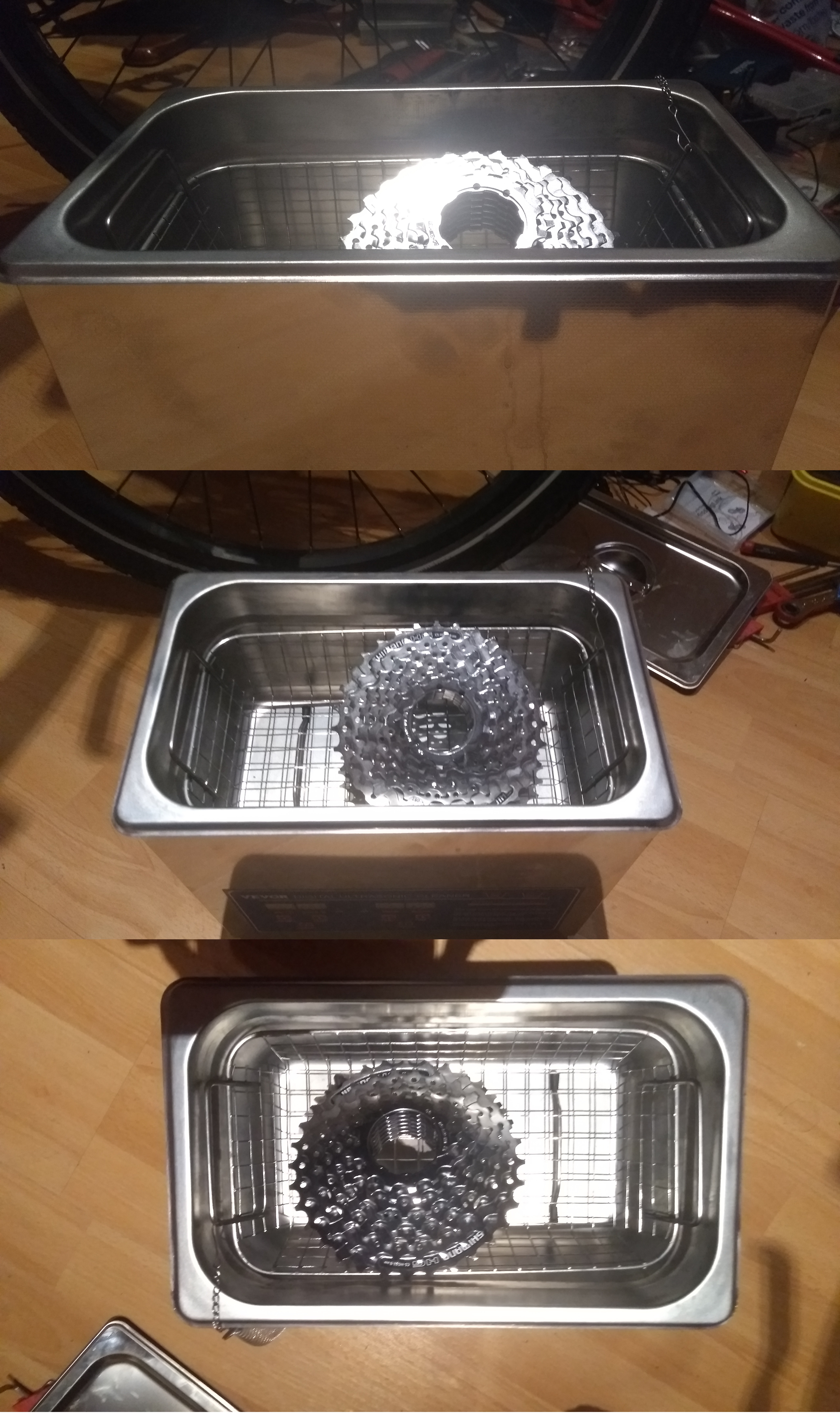

    Wow! I thought a 2 litre
    Wow! I thought a 2 litre would be plenty. I’ll take a look at the tank dimensions and measure the largest cassette I have…then maybe time for some good old trigonometry (or AutoCAD). Thanks for the pics. Food for thought.

    I’ve got a Vevor 3.2l and an
    I’ve got a Vevor 3.2l and an 11-32 8sp cassette without the little ring doesn’t quite fit under the fill line.
