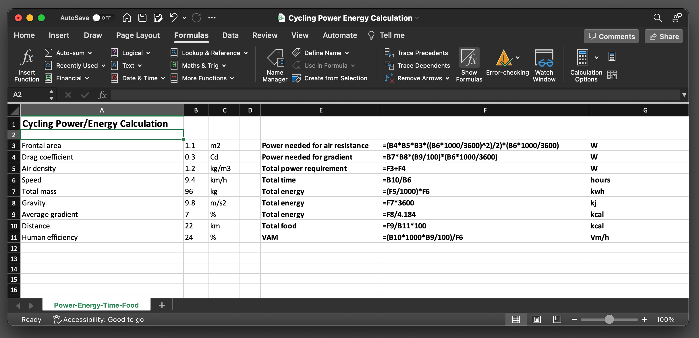

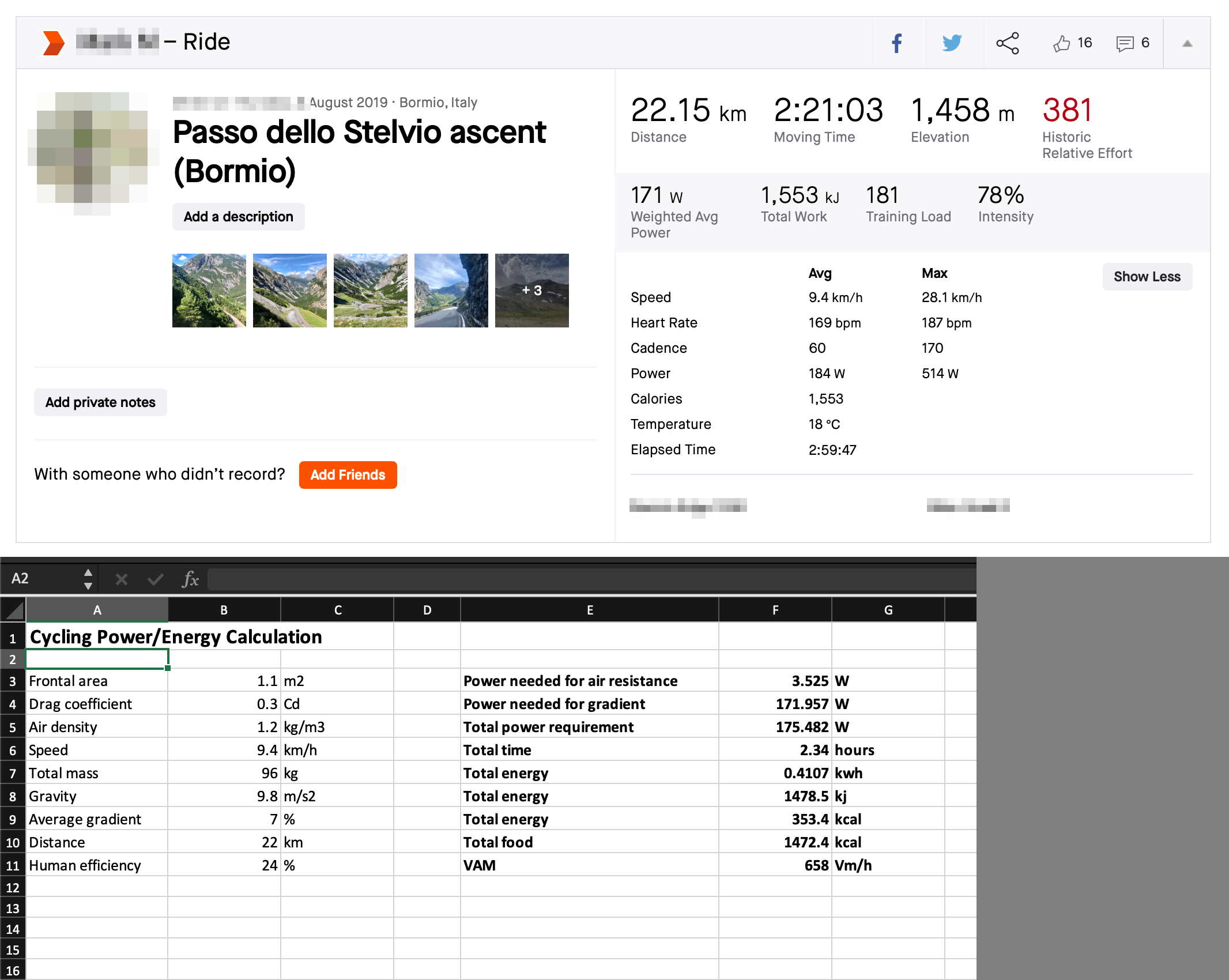

Interesting question, the
Interesting question, the answer is… sort of.
I have a spreadsheet that I made some years ago to work out what power I would need to do a particular climb at a particular speed, and staying well below FTP. As this needs weight as part of the calculation, time can be extrapolated from change to speed keeping the power constant. I couldn’t find an online calculator at the time, so scraped some formulae from various sources, including distant memories of 80s physics lessons, Sheldon Brown, etc.
Power to overcome elevation can be calculated from slope x speed m/s x total mass x g^2. Then I took account of wind resistance which is air density x drag x frontal area x (wind or speed) /2. I ignored rolling resistance and drivetrain losses for the purposes of the spreadsheet.
I also added in some other factors such as metabolic efficiency so I could work out what fuel I’d need, extrapolated from work done in kJ.
This is all a bit “back of a fag packet”, however after I’d climbed Stelvio, the figures matched up fairly accurately.
mark1a
Frontal area, drag
Frontal area, drag coefficient and air density and human efficiency are guesstimates, total mass is all up rider plus bike. Distance and gradient are Stelvio from the Bormio side.
mark1a
Here’s the formulae in the
Here’s the formulae in the cells, feel free to have a play, improve, etc. One day I may get around to making an online version, but it seems to work in Excel for the few times I use it.
