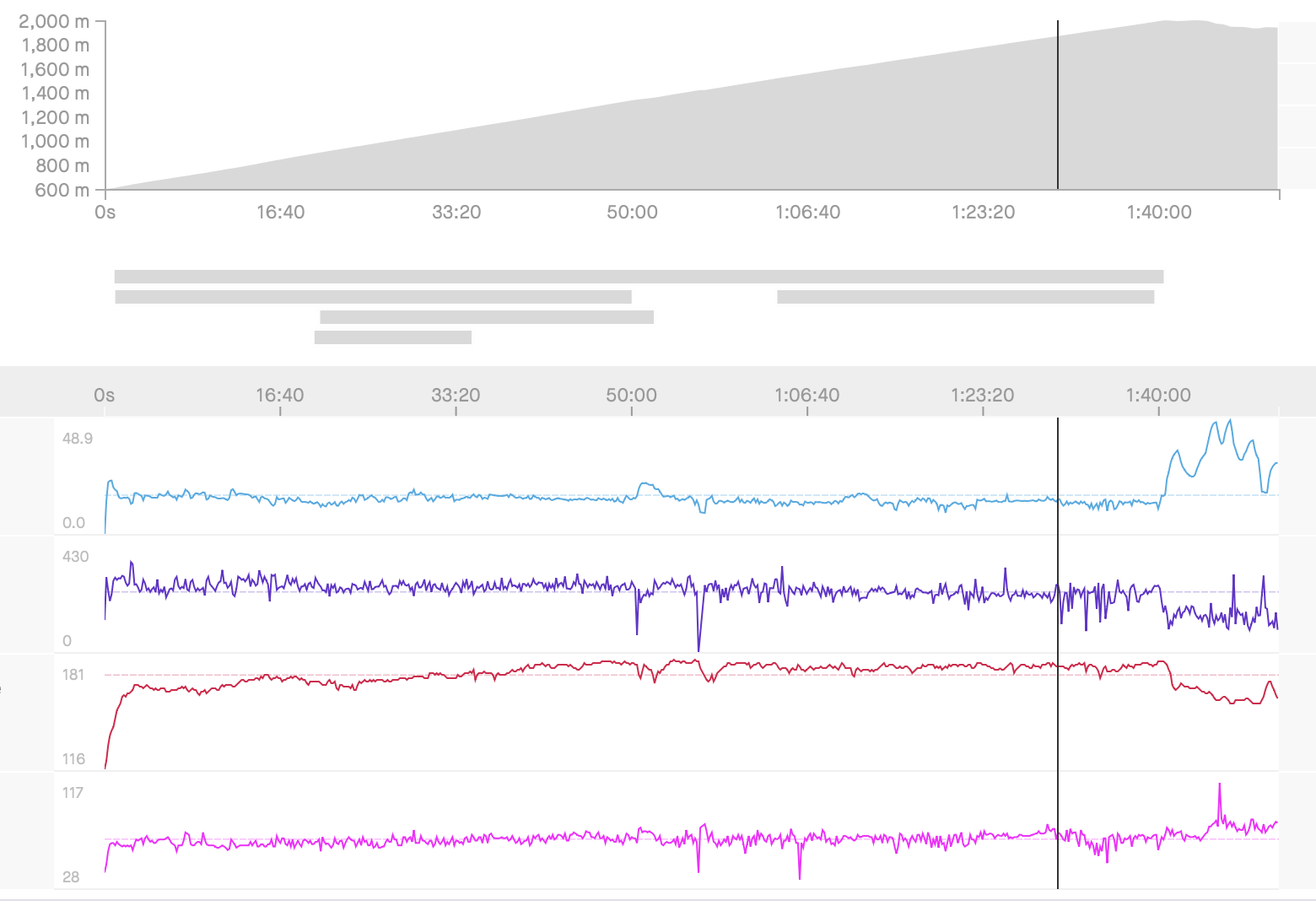

I expericence some strange behaviour of my kickr core. After riding about 90 Minutes, 90 Minutes and 30 Secondes to be exakt, the kickr looses about 30 to 50 Watts. First I thought this is a problem with Zwift, as I experienced it there first but today I rode the Chio -> Teide Route in Rouvy and there, after 1:30:30 the kickr again looses 50 Watts. And I can see it clearly in the Powerline on Strava … before the line is relative even, and right after 1:30:30 it goes up and down like crazy.
Does anyone else has this problem or even a solution? Calibrating does not help 🙁
