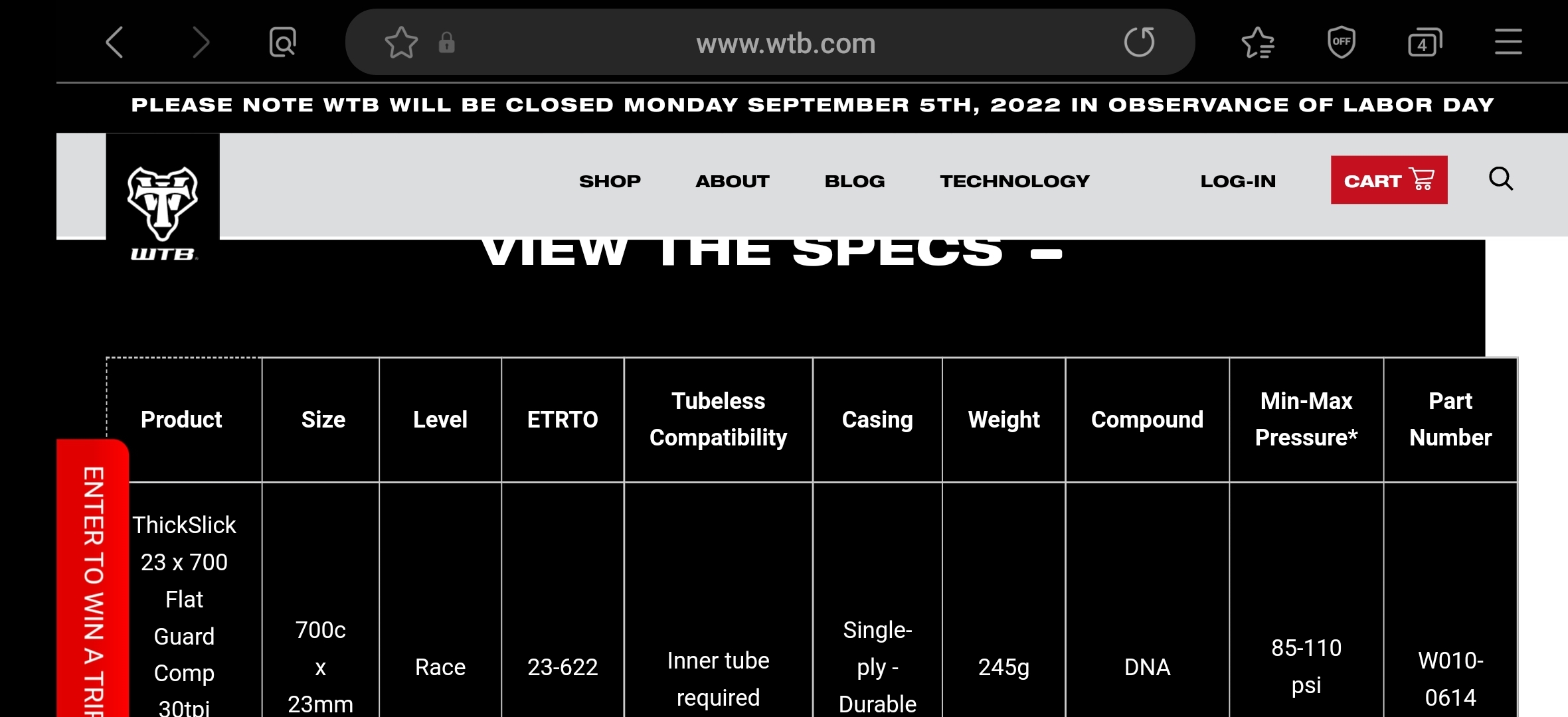

    Sriracha
    WTB show their tyre pressures
    WTB show their tyre pressures too…

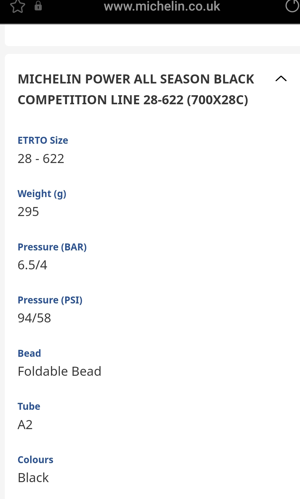

    Sriracha
    Michelin show the tyre
    Michelin show the tyre pressures on their website.
