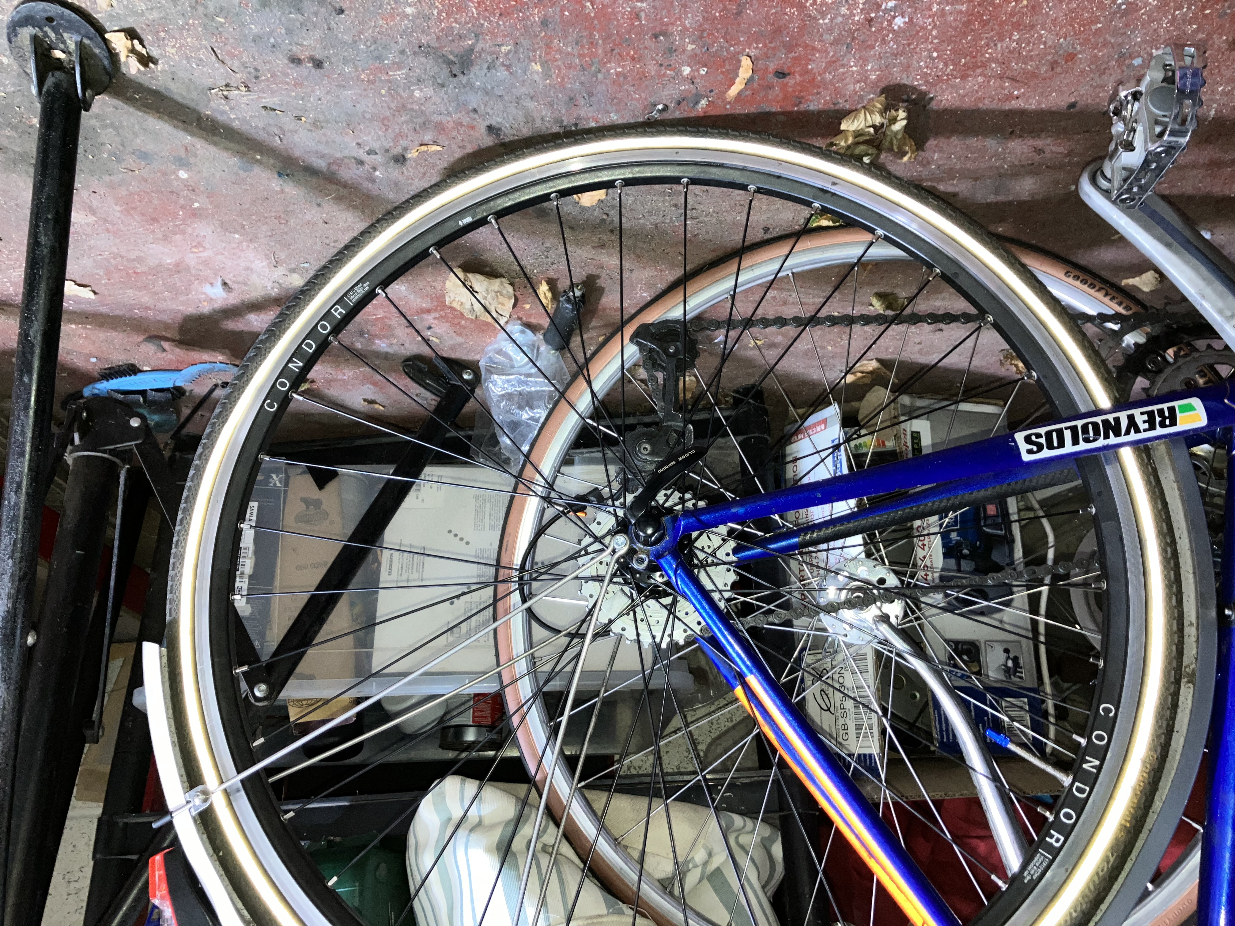

    Photo coming up, but I’ve tried three different tyres, of different widths, and all sit wrong when mounted – about one-sixth of the tyre sits inwards by 2-3mm. The lumpy ride is really noticeable on smooth tarmac.  I’ve tried fatter tubes. I haven’t yet tried different rim tape.
    The rim width is 19mm, so 28s should be OK on the Sheldon Brown table of wisdom.
    Interestingly, I had to get to get the ERD from Condor, and the spokes turned out to be on the long side.
    I am beginning to wonder if the rim diameter is 2-3 mm off? Or can anyone else suggest what is wrong?

    Seems to be sorted, thanks
    Seems to be sorted, thanks all.
    Three metallic clangs were heard as I got past 70 psi.

    It’s the shorter bit that
    It’s the shorter bit that hasn’t climbed onto the shelf.

    Thanks. Do you think the 1
    Thanks. Do you think the 1/6th of the circumference area that is “in” is the problem, or the 5/6ths that are “out”?

    As suggested some lubricant
    As suggested some lubricant then overinflate until it seats.

    soapy water along the bead?

    The problem area is around 4
    The problem area is around 10 o’clock / top left on this inverted picture, pretty much next to the Condor decal.  As I say, it makes for a very lumpy ride. I’ve got some 700 x30 tyres lying around, but I’m not sure they’d clear the SKS mudguards.
