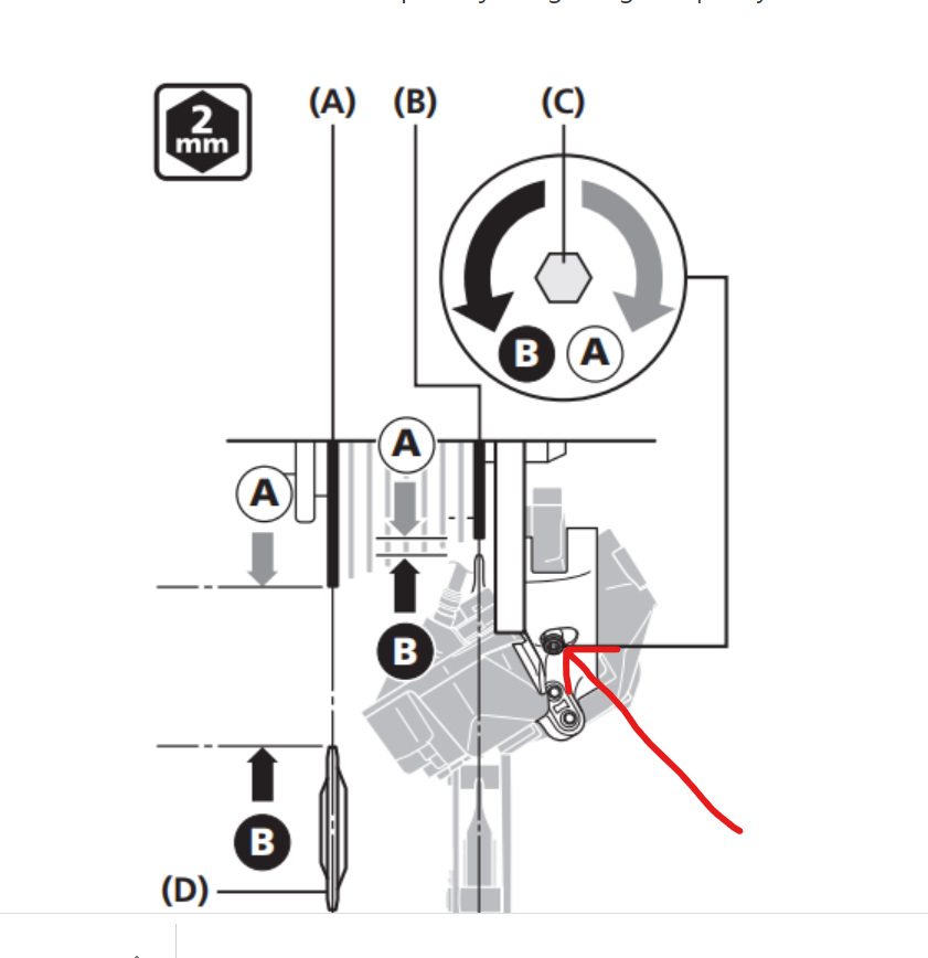

    Hi everyone, maybe someone has a good tip for me. I am currently failing to setup my shiny new Ultegra Di2 R8050 on my Cervelo R2 (the older one sharing the frame geometry with the Rca); First time I ever had Di2 on a bike, so I didn’t expect it to be create this much trouble compared to over one and a half decades of working on mechanical equipped bikes.
    For the life of me, I can’t get the Rear Derailleur cage to not touch my spokes in the biggest cog. For as good as I can tell, my hanger is straight as it should be.
    When I set the L limit screw as far in as it goes, it stops rubbing (just so), but when I shift into the lowest gear, the derailleur moves over makes an electronic clicking sound and then moves back one position and drops the chain on the 10th cog instead of No. 11.
    There is one way I managed to get it away from the spokes, and that was to use microadjustment so far over that it runs in the next gear up, BUT now it won’t shift into the smallest cog and shifts kind of badly, skipping some gears when moving to a bigger cog and shifting sluggishly when shifting to a smaller cog;
    Does anyone have any idea / advice on what I should do?

    This may be well off field here but check that the Derailleur has been bolted onto the frame correctly. A cross thread, or not getting correct position so that the derailleur sits on the hanger where the notch is will mean it does not sit straight and could be leaning into the wheel.

    Be careful, the adjustment for the small sprocket is not the same as for a mechanical system, you need to adjust the limit screw with the chain on the small sprocket then back the screw off by one whole turn, Di2 over-shifts slightly then trims.  If you have the stop setting too tight you will hear the clicking sound you describe as the mech tries to move slightly further than the limit screw will let it

     I would personally start by ensuring (rather than just thinking) your hanger is correctly aligned, using a hanger alignment tool. Even if it looks straight it can be significantly off. That will make getting precise shifting in all gears almost impossible.
    pretty unlikely in an existing bike that’s been running fine IMO.
    B mech screw is the place to start as RecoveryRide noted.
    I did first time di2 (grx) about 6 months ago.  I was surprised how much of a faff it was.
    #982157
    Pilot Pete
    You would do best following
    You would do best following the Shimano Dealer Manual guidance exactly. Page 180 onwards here https://si.shimano.com/pdfs/dm/DM-R8050-02-ENG.pdf

    Forgive me if this is totally obvious, but you have started with the adjustment screw to set pulley distance, right?  See pic
    Sequence for Di2 is
    1. Set pulley distance with adjustment screws
    2. Index with adjustment mode
    3. Set H/L  limits
    I’ll go through it one more time this evening (maybe third time is lucky); My order so far was 2 and 3 switched, so maybe that’s why.
    Sequence for Di2 is
    3. Set H/L  limits
    https://road.cc/wp-content/uploads/roadcc/Screenshot 2021-07-13 095341.png
