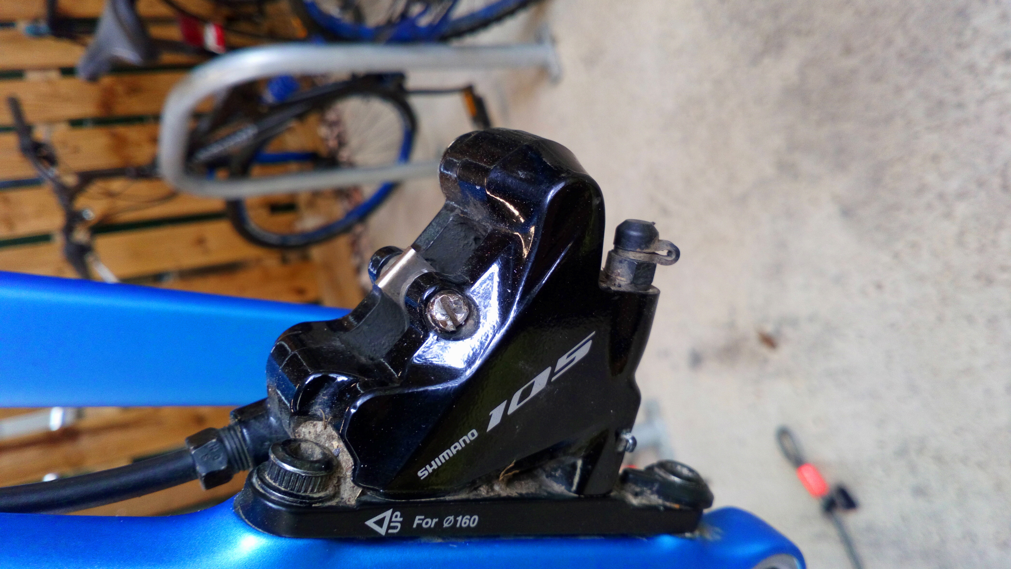

    Changed the pads on my disc brakes today (105 hydro). The rear caliper was v straightforward, bolt unclipped, unscrewed, old pads out, new pads in – job done. Went to do the front and the screwdriver has striped the head off the bolt which seems to have seized with dirt.
    Can order a new bolt online easily enough but any suggestions on how to get the old one out? Needle Nose pliers would be my first thoughts….

    So the pliers arrived and
    So the pliers arrived and seem to be a nice quality pair. But they’ve had no effect except to make it worse. The bolt metal is so soft it just deforms with any approach. Think I may have to drill it out…
    https://cdn.road.cc/wp-content/uploads/roadcc/DSC_0475.JPG

    Thanks for the tips folks – I
    Thanks for the tips folks – I like the look of those pliers so I may give them a go. I’m reluctant to drill the bolt out but have seen drill bits you can get that remove bolts so those’ll be plan B and then bike shop as last resort (assuming it’s open).
