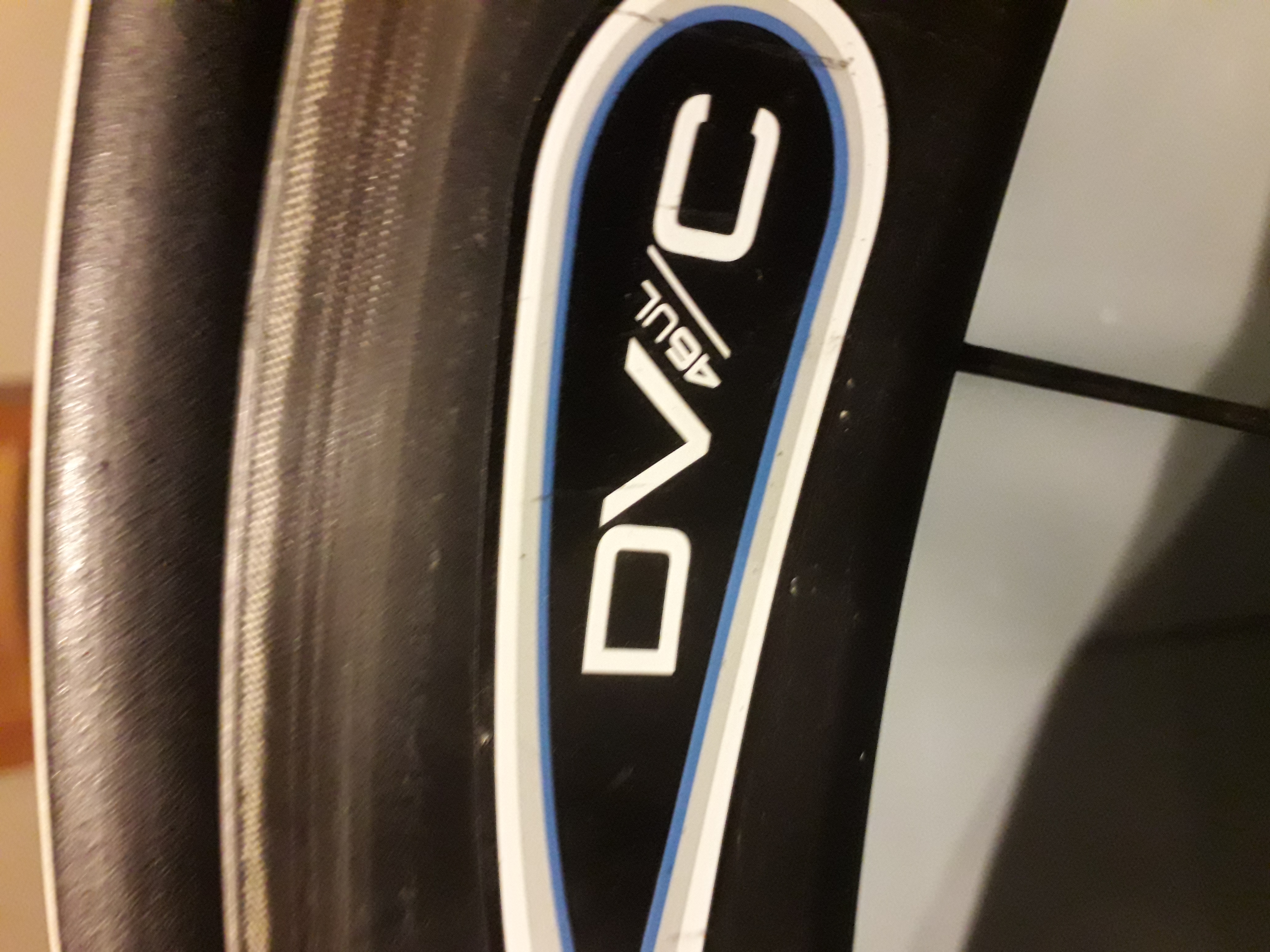

    #980491
    benwright79@googlemail.com
    Picture of the wheel.
    https://cdn.road.cc/wp-content/uploads/roadcc/20210515_002539.jpg

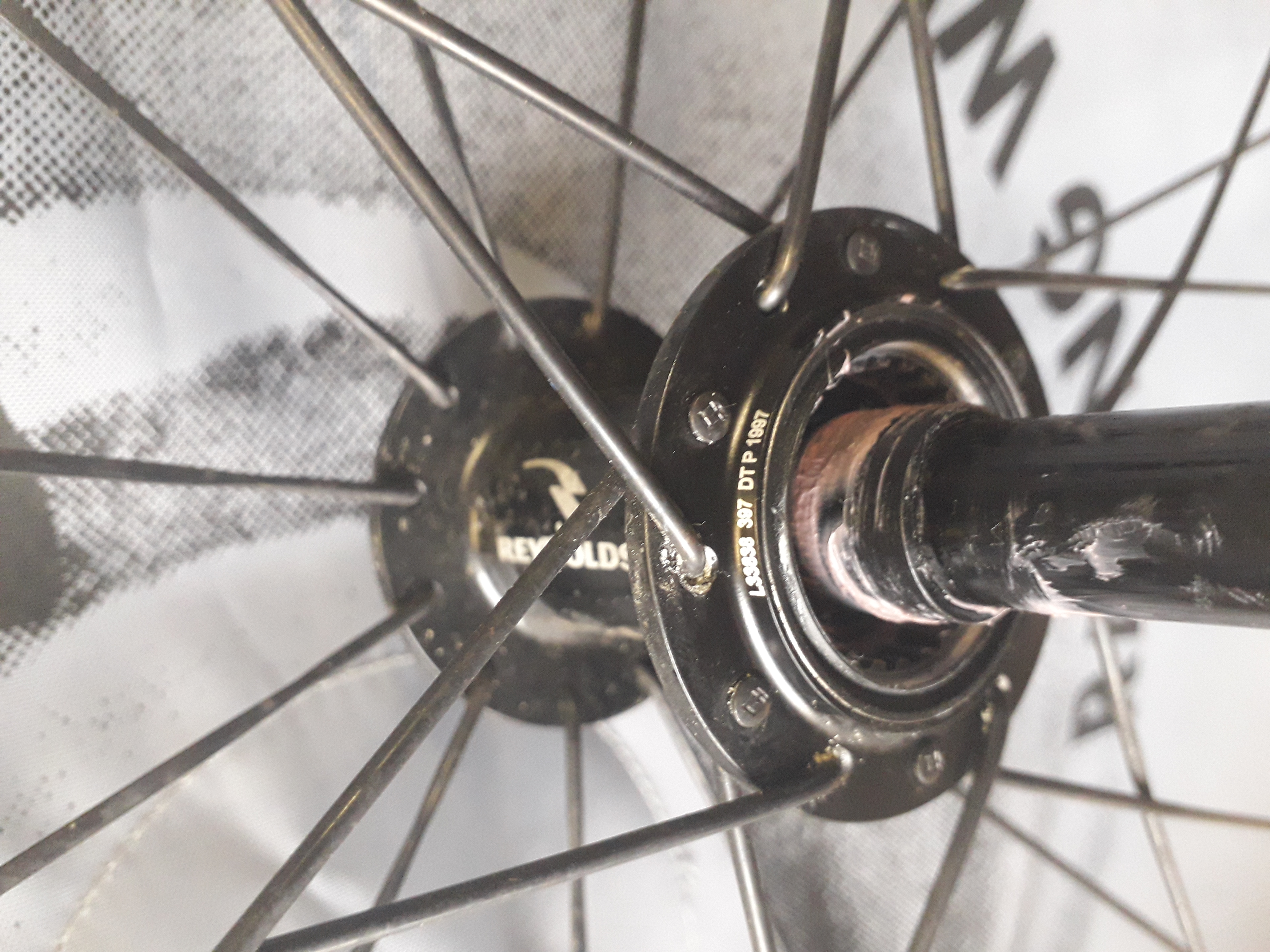

    #980489
    Picture of the hub.
    Picture of the hub.
    https://cdn.road.cc/wp-content/uploads/roadcc/20210521_125824.jpg
