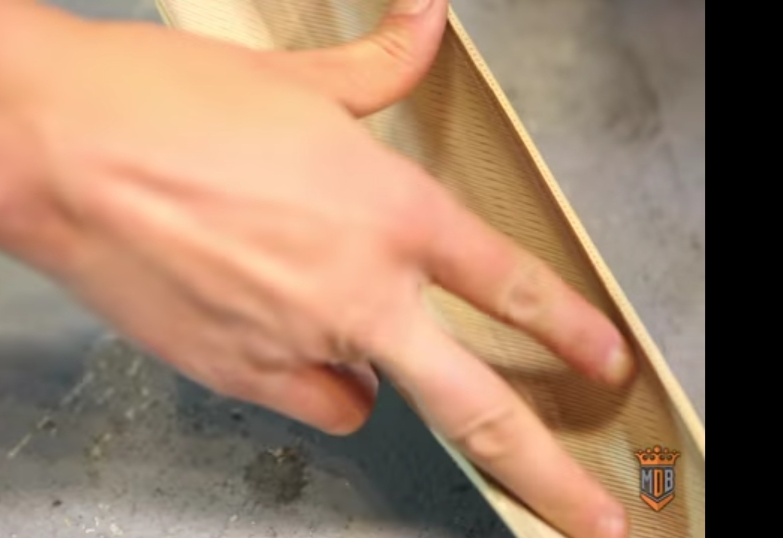

Apologies if you’ve been there already but I thought the canonical way (for minor repairs) was not to bother, but just get the tube out of the tyre:
(I do note it looks suspiciously easy in that video though…)
