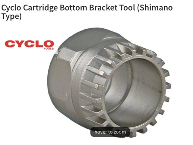

Once the cranks are off, then
Once the cranks are off, then it’s one of these. It looks like it’s a Shimano copy, but check the number of splines is the same – your first photo looks like between 9 and 10 o’clock there’s a bigger gap.
If it’s standard English BSA threads, it’s the opposite of pedals – the right hand side is a left hand thread. You’ve probably got a sealed unit in there – check how smooth it’s running – you could replace it if it’s old.
The bottom bracket may need some welly, e.g. setting up in a vice if it’s stiff – just don’t end up doing yourself or your bike a nasty. A Replacement Shimano unit like UN 300 should be right – the width of the body should be 68 mm for a road bike, and you need to check the spindle length.

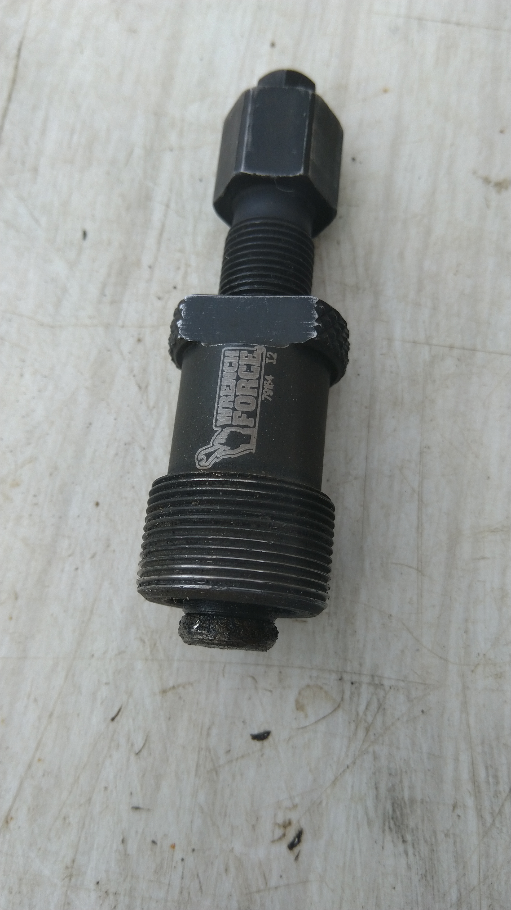

peasantpigfarmer
Like this!
Like this!
peasantpigfarmer
Just need a standard crank
Just need a standard crank arm extractor tool. About £5-10. A common tool stocked at any local bike shop. -
