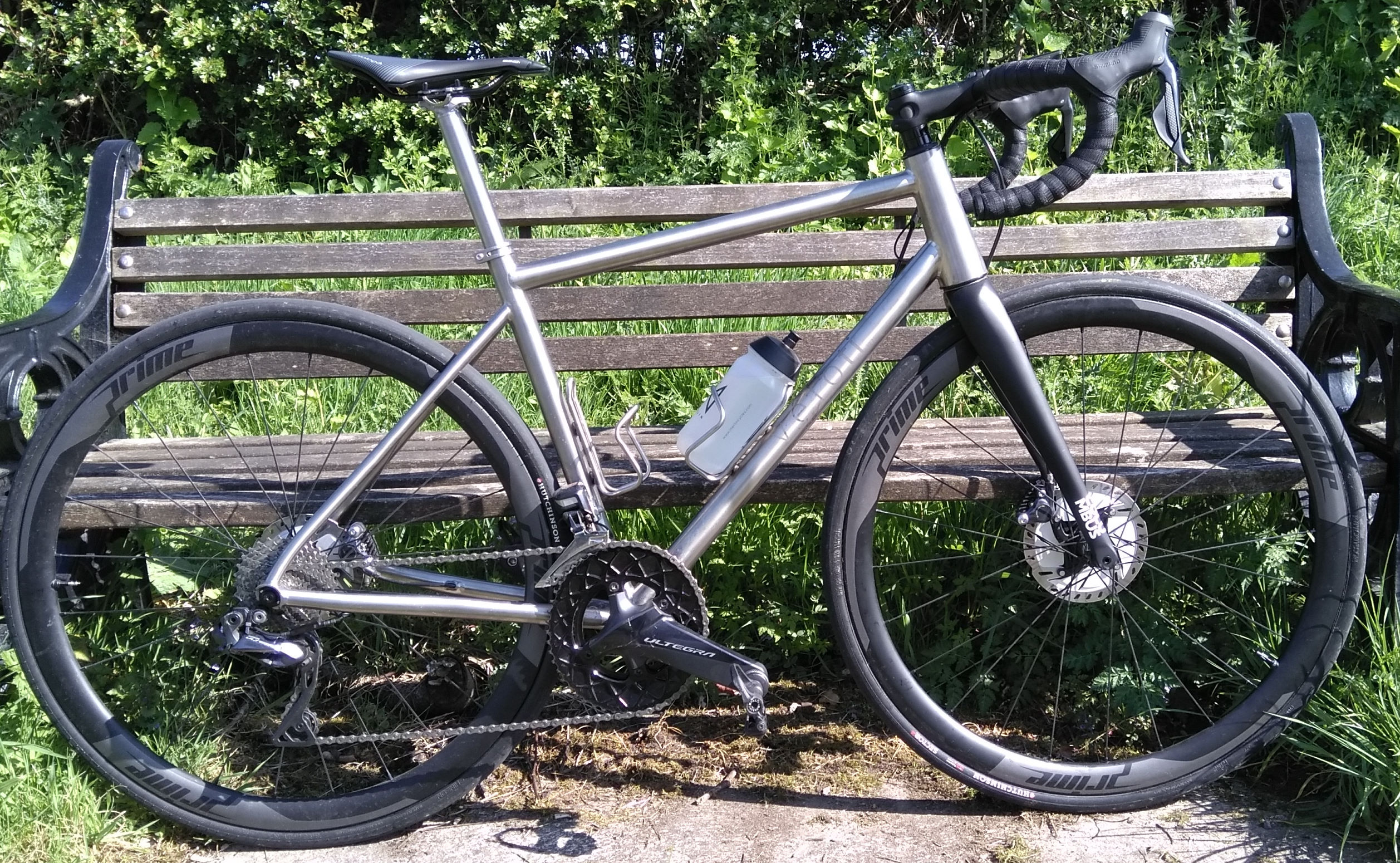

I’ve owned a Gradient for
I’ve owned a Gradient for about a year. Can’t recommend it highly enough, it is just good at everything. I got it for winter club runs and light touring, now I’m riding it through the summer in preference to my Domane.Zigster
