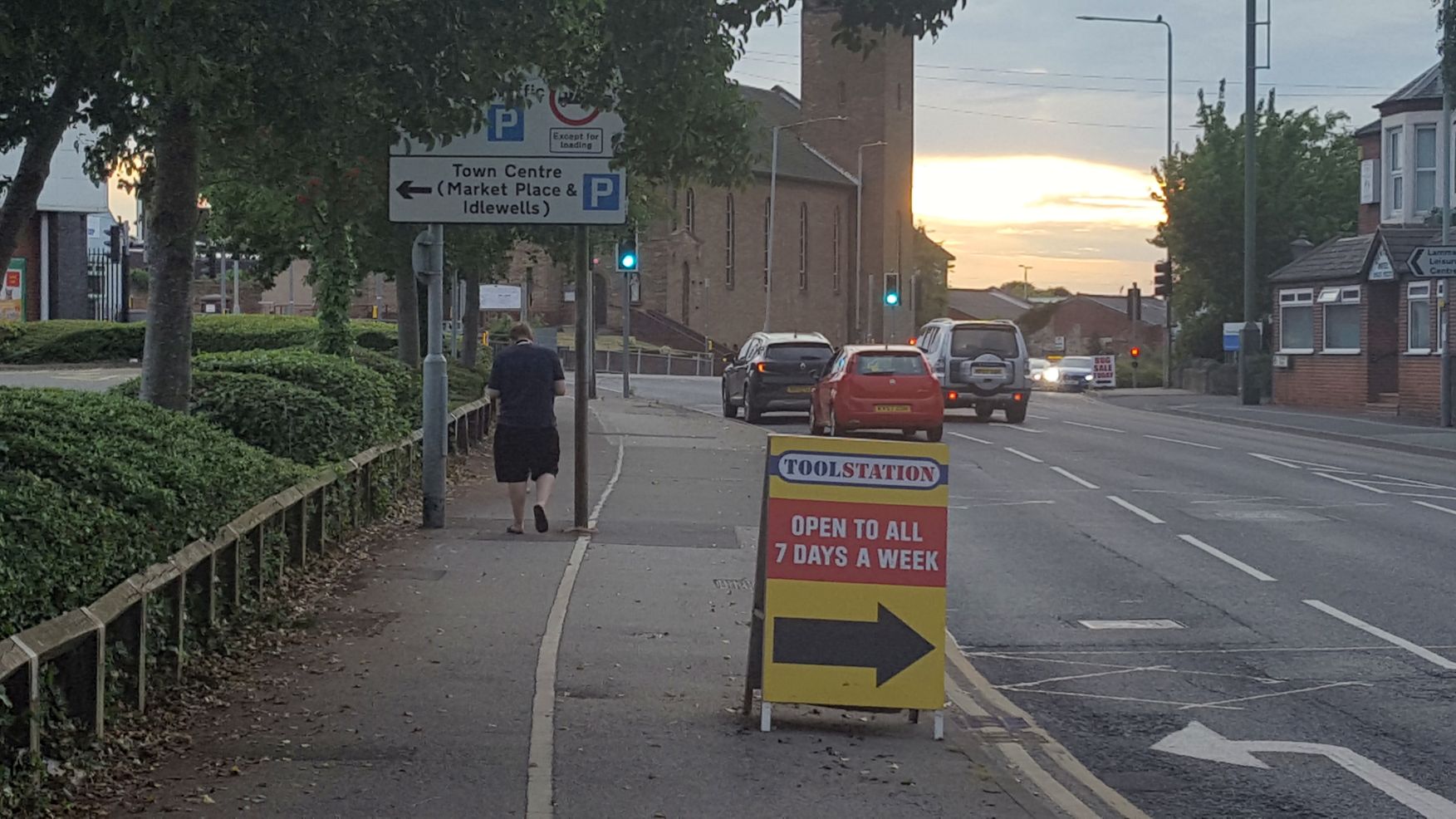

    First small complaint submitted for a persistent advertising A-sign obstructing a shared footpath, which is put out every day by Toolstations for the last couple of years, when they have a bloody great sign on their plot on the other side. We’ll see what happens.
    It’s possible they have Planning for it, but I doubt it there.
