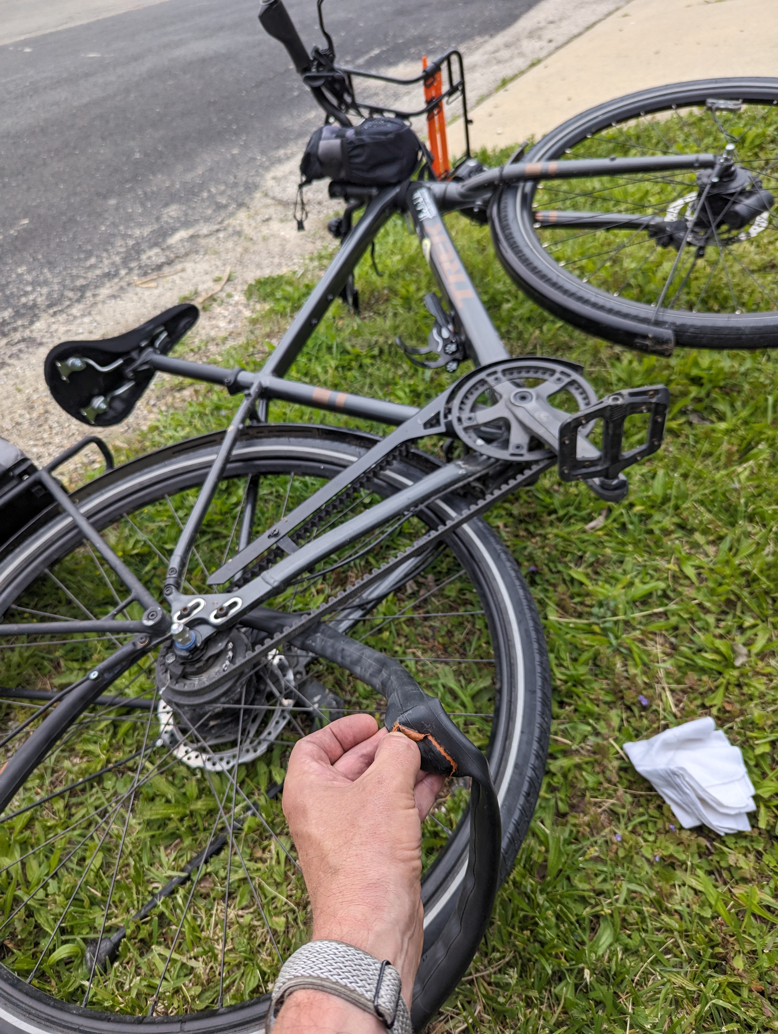

I had to fix rear punctures on my afternoon commute both this past Friday, and yesterday (Monday.) Both punctures were on the inside of the tyre — the rim side. As it has hub gears and is a pain to remove the wheel, I patched without removing the wheel, so I know it’s not from the same location as they were in different places on the tube.

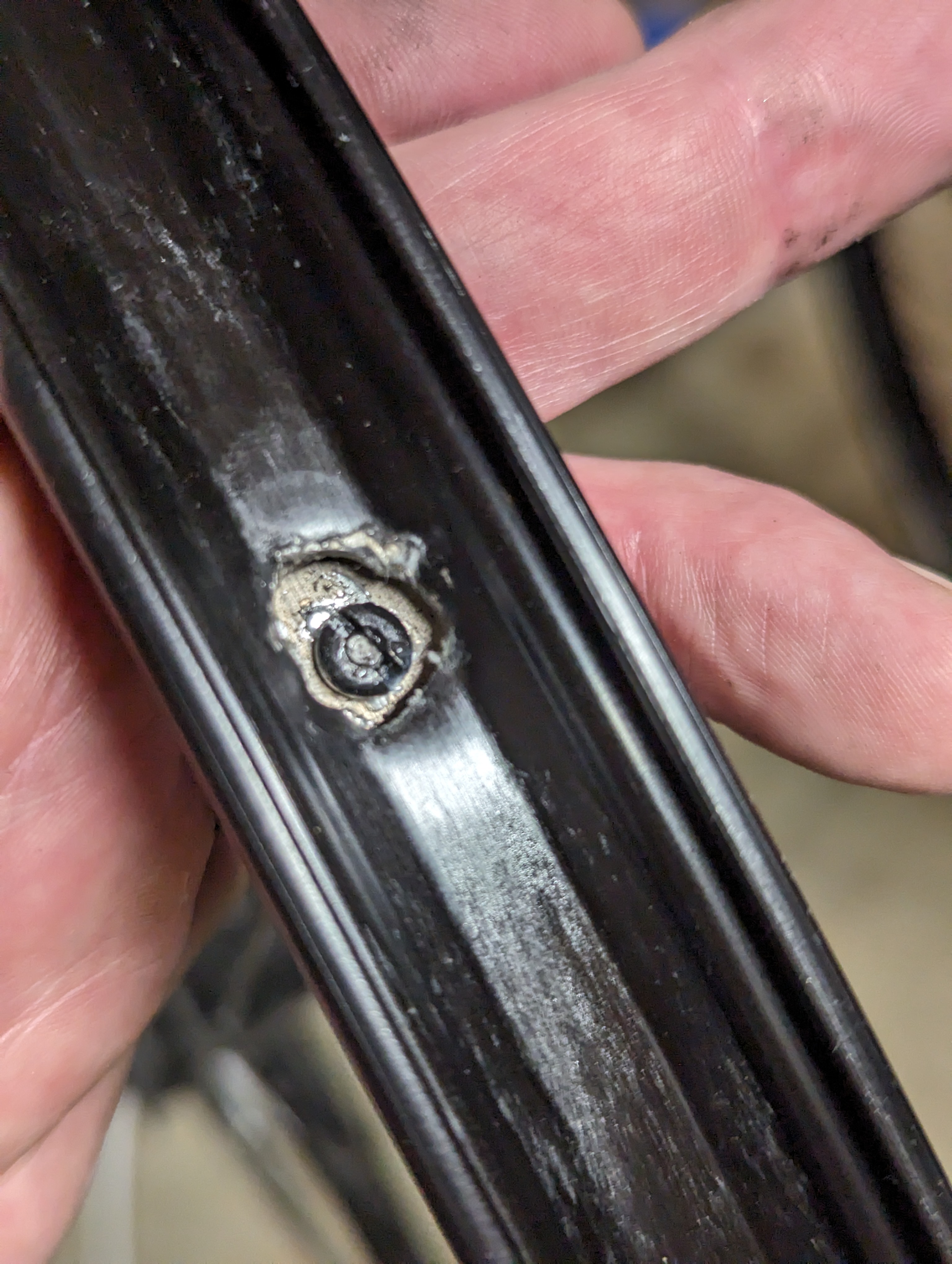

No spokes are anywhere near proud of the spoke holes, and the rim strip has no holes in it. I’ve experienced this before, a few years ago, and my theory is that this new-fangled one-piece plastic rim strip shifts sideways, and exposes sharp edges to the tube, eventually wearing them down. I’ve never had this issue with Velox tape.
See how it waves side to side?
This edge feels sharp enough to wear a tube, and sticks up proud of the rim bed at the edge.
I have a tick over 5000 miles on this bike, original tyres and tubes, but I think this rim tape was new a couple of thousand miles ago when my rear wheel was rebuilt after a few broken spokes. I’ve had about a half dozen punctures on this bike.
