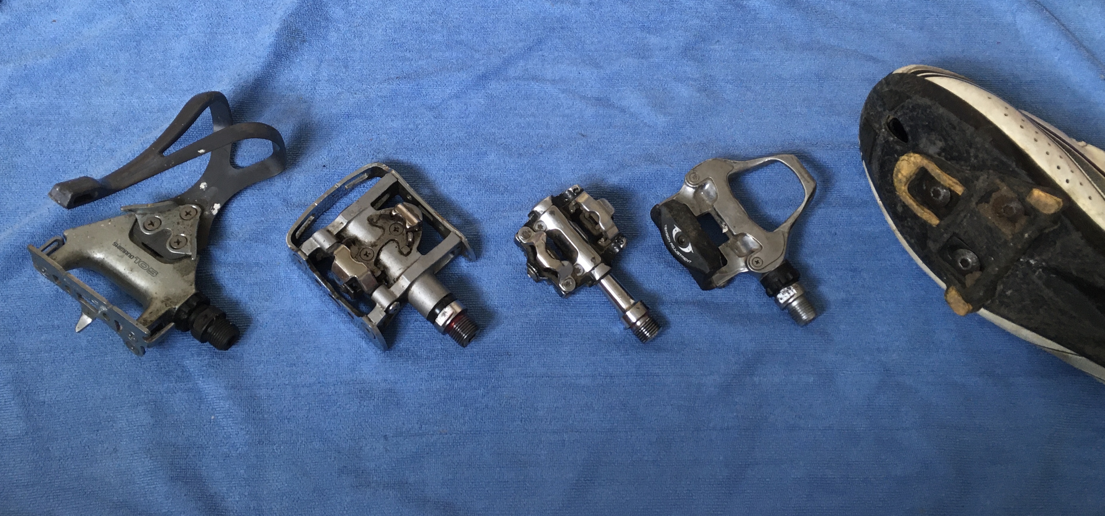

Below are some pedals and some thoughts. Left to Right…
TOE CLIPS/STRAPS: In the olden days I had toe clips and straps. More recently I used the clips and kept the straps loose. Perfectly fine for your current needs.
SPD/FLATS: For my commuter/MTB I bought Shimano M324 pedals as mentioned already. My thinking was that I would buy some SPD shoes (I did – they don’t fit) with the intention of also fitting them on my road bike, and on my MTB use the flat side riding to work in regular shoes. So one side has never been used as I just never bothered. The pedals are now on my touring bike (it’s been doubling up as a shopper which I load with panniers and do early morning essentials shopping). I take them off and put SPD-SL road pedals on my tourer when I’m going on a ‘proper’ ride.
DOUBLE-SIDED SPDs: Put these type on your bike and you’ve got to buy in to the SPD shoes. (I’ve never used these ones either.)
SPD-SL: if you are or you will be using your bike as an out and out road bike these provide a wider platform for your feet and are designed for the job. If the act of clipping in is worrying you I don’t believe this type of pedal will be any harder or easier than any other. You’ll just have to practise whatever type you get.
Some points to consider:
WEAR AND TEAR: On the far right you’ll see the yellow plastic on a Shimano road shoe cleat that is beginning to wear away. When it’s gone the cleats should be replaced. About £10. You get them with a new pair of pedals. (You can also get little rubber things for your road shoes/pedals. You can slip them over your cleats when you teeter in to Tesco or clip other types on to your road pedal to give a flat surface when wearing normal shoes. I have no experience of either.)
REFLECTORS: only the second and fourth pedals below are capable of taking amber pedal reflectors. Technically – ie legally – any bike manufactured since the mid 80s must have front and rear facing amber pedal reflectors fitted if ridden between the hours of darkness in the UK. Is that likely to be a consideration?
