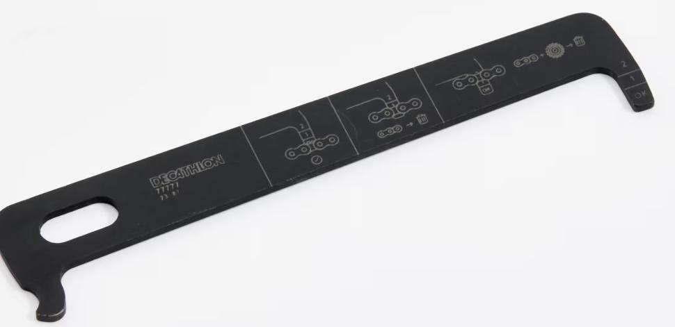

    cheap chain checkers are a
    cheap chain checkers are a bit naff, not all actually work, get a shimano one or measure with a ruler (not across the quick link if your chain has one)

    You might want to get a chain
    You might want to get a chain checker for that (Chain wear indicator as referred to in the article).
