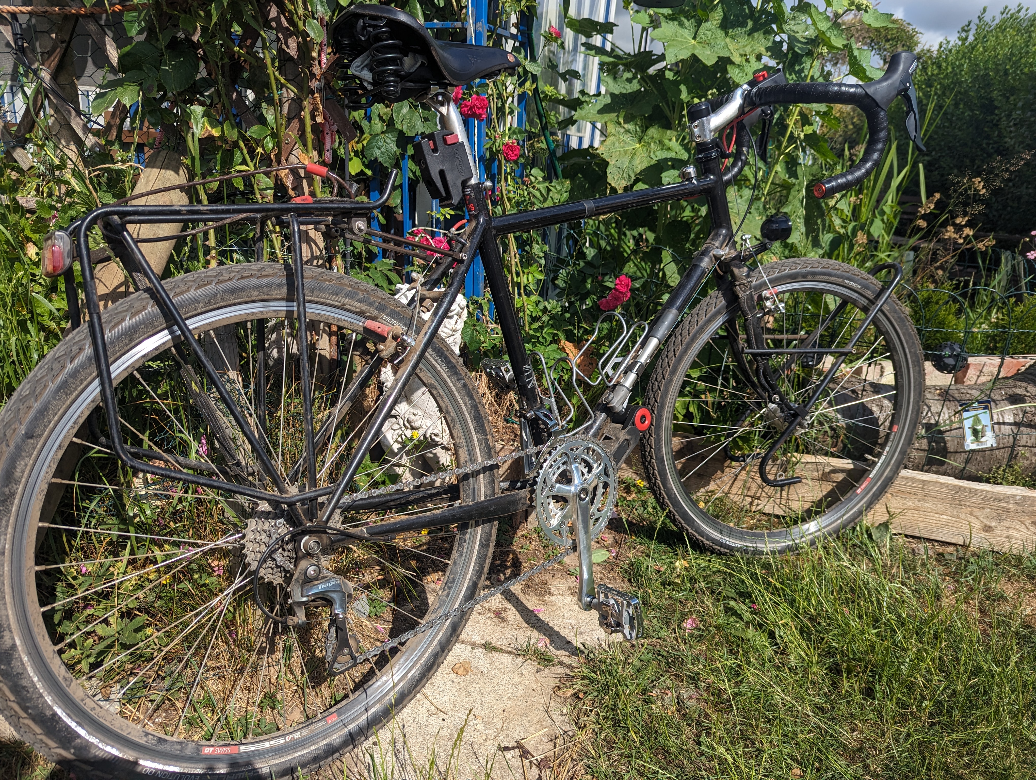

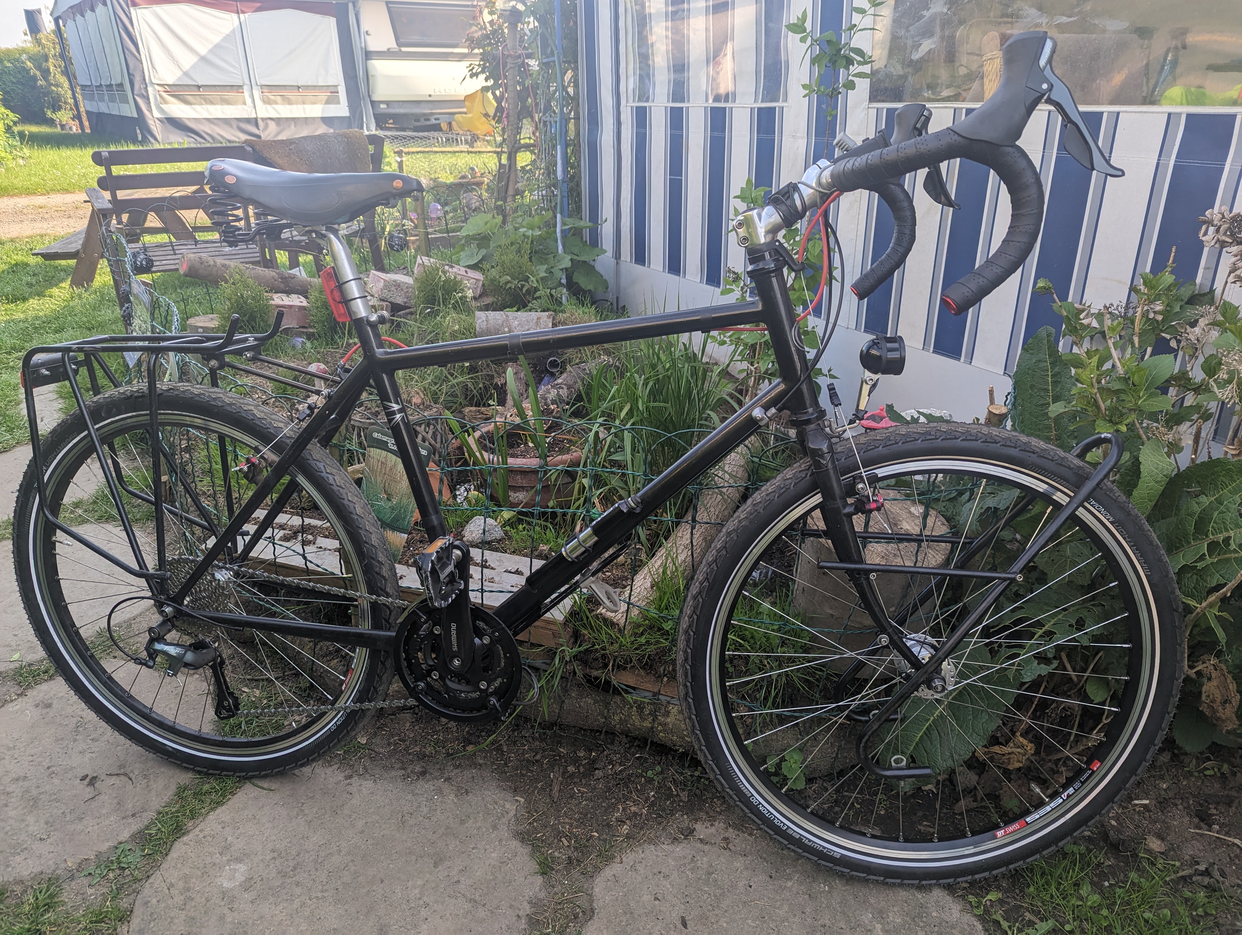

It’s a bit of a frankenbike, but I love it. Picture link below. Campag ergo levers on drop bars with 9s rear racing t, and racing t front. Schmidt dynamo front, xt rear on 26″ Mavic rims, avid shorty cantis. I’ve a compact 3x sugino crank on a Shimano BB. Cassette a Shimano 11-28 and 9sp chain. Campag seat post. I’ve done thousands of miles on it the last 20 years. Never a buckle, never a problem. I did stick a new BB in and grease the xt rear hub a couple of years ago at the same time I replaced the old Shimano cantis from my long gone Dawes galaxy with the avid shorty pair. The Schmidt has never been touched…which is remiss of me.. it’s the older beer barrel one.

[Roberts Roughstuff ](https://i.imgur.com/2RbGmIf.jpg)
