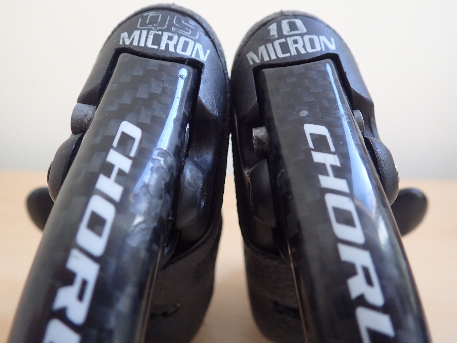

    #1007029
    See the metal rod thing just
    See the metal rod thing just above the C in Chorus. Push one way it releases the lever, push the other way it is a stop – it isn’t the hinge..
    https://cdn.road.cc/wp-content/uploads/roadcc/s-l1600_25.jpg

    #1007019
    bobbinogs
    Photo attached…
    Photo attached…

    #1007009
    Dnnnnnn
    Might be worth a photo so we
    Might be worth a photo so we can see which Chorus they are, and so we know ‘what you mean when you say…’ .
    I’ve Choruses, which lack the quick release cam than most rim brakes have, and they also have the rubber ring around the barrel adjuster (which seems less sensible than the usual knurled barrel adjuster). So it’s an allen key for me too, although it doesn’t feel much of a hardship. But maybe we can both learn something here!
