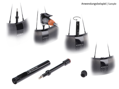

An additional factor is the novel (to me) concept on these rims, with detachable valves that you only put on for inflating and which otherwise stay tucked inside a valve tool (with the resulting hole in the rim covered by a click-on cover). I’d imagine that screwing and unscrewing them when inserting them will also result in sealant being shot out?

They are Newmen Streem Advanced R50.
Don’t know if I can add YouTube links here but their website has a video about set-up, and it skips taking the pump on and off the valve (and also inflated it from empty, meaning you don’t have the problem of screwing in the valve when it’s under pressure and with sealant already in).
