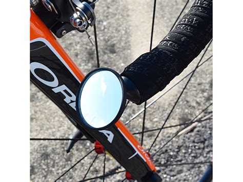

    You should try the Cateye
    You should try the Cateye BM45 bar-end mirror – I’ve been using one for a few years. It’s the best combination of being easy to adjust whilst riding (on a clear bit of road obviously) so that you can get it in exactly the right position and yet it also stays put so that you don’t have to keep re-adjusting it (unless you knock it with your knee or lean the bike against something).
    (generic photo – not my bike)
    https://cdn.road.cc/wp-content/uploads/roadcc/bm45mirror.jpeg

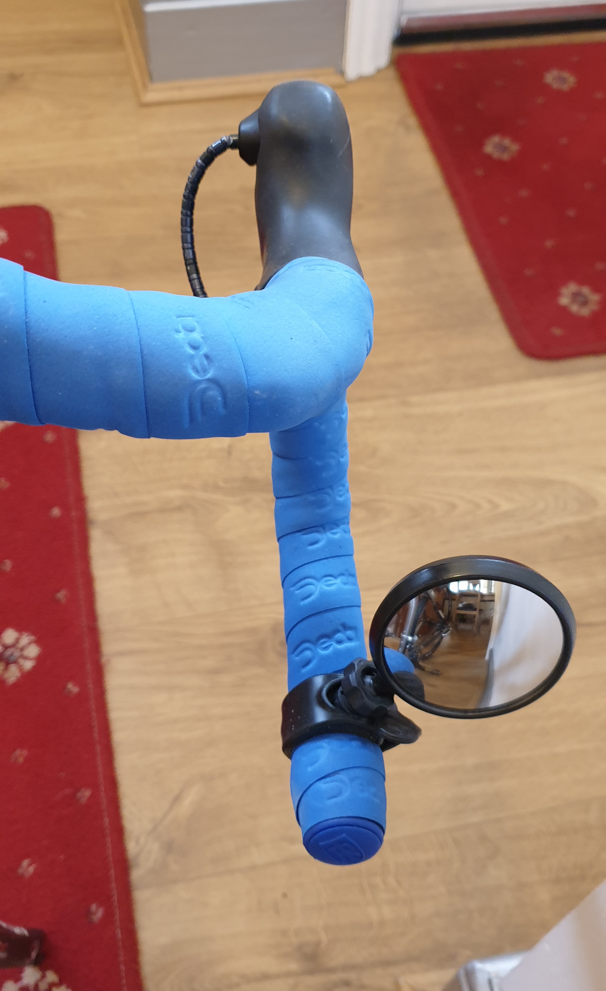

    Thanks for the reply and the
    Thanks for the reply and the photos. This is the mirror I use at the moment, but its not all that good…… but better than nothing. I like your idea and did you make the bracket yourself for fixing to the brake hoods ????? I have recently found this website :- https://hindsight.store/  that says it supplies bike glasses that enable you to see whats behind you because of the clever design of the lenses they use. Not tried them yet, but was thinking of giving it a go in case it helps. But first, I will give your idea a try. Many thanks for the advice. I’m waiting an eye op where they will stitch my eyelids together permanently to try and ease the discomfort I get evry minute of the day , so just hoping it works ! Cheers Jimmymerlin

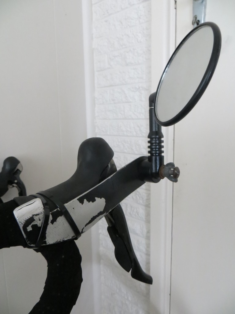

    I use a rear view mirror
    I use a rear view mirror because of right side vision limitations. I’ve got one on each of my bikes and a bike feels naked without one. I bastardised an Mirrcycle MTB mirror to come up with the one below just by cutting off the shaft that would normally fit into the MTB bars. They do make them for drop bars, but I felt that they compromised the construction of brake levers because they were designed to be a part of the lever. If you fall with them, there’s a possibility that you can damage the lever because of the attachment method, whereas mine are just securely attached by cable ties. I use the same attachment method for Ultegra or just brake specific levers.
    The Mirrcycle mirrors are available in Australia from
    https://www.kogan.com/au/buy/psh-mirrycle-mtb-bike-mirror-mirrycle/?utm_source=bing&utm_medium=cpc&utm_campaign=Bing+PLAs&utm_term=1101400107879&utm_content=Ad+group+%231
    https://cdn.road.cc/wp-content/uploads/roadcc/IMG_1578.JPG

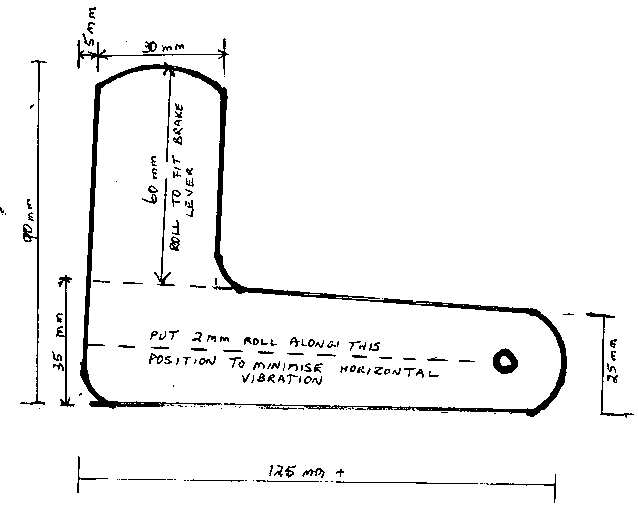

    This is the rough idea of of
    This is the rough idea of of the design. Later versions don’t have the arm going over the handlebar, so instead of it being 60mm as shown on the drawing, it’s only short as shown in the pic above. I’ve been using this for over 25 years and had no problems and the cable ties don’t impede the gear change mechanism. .
