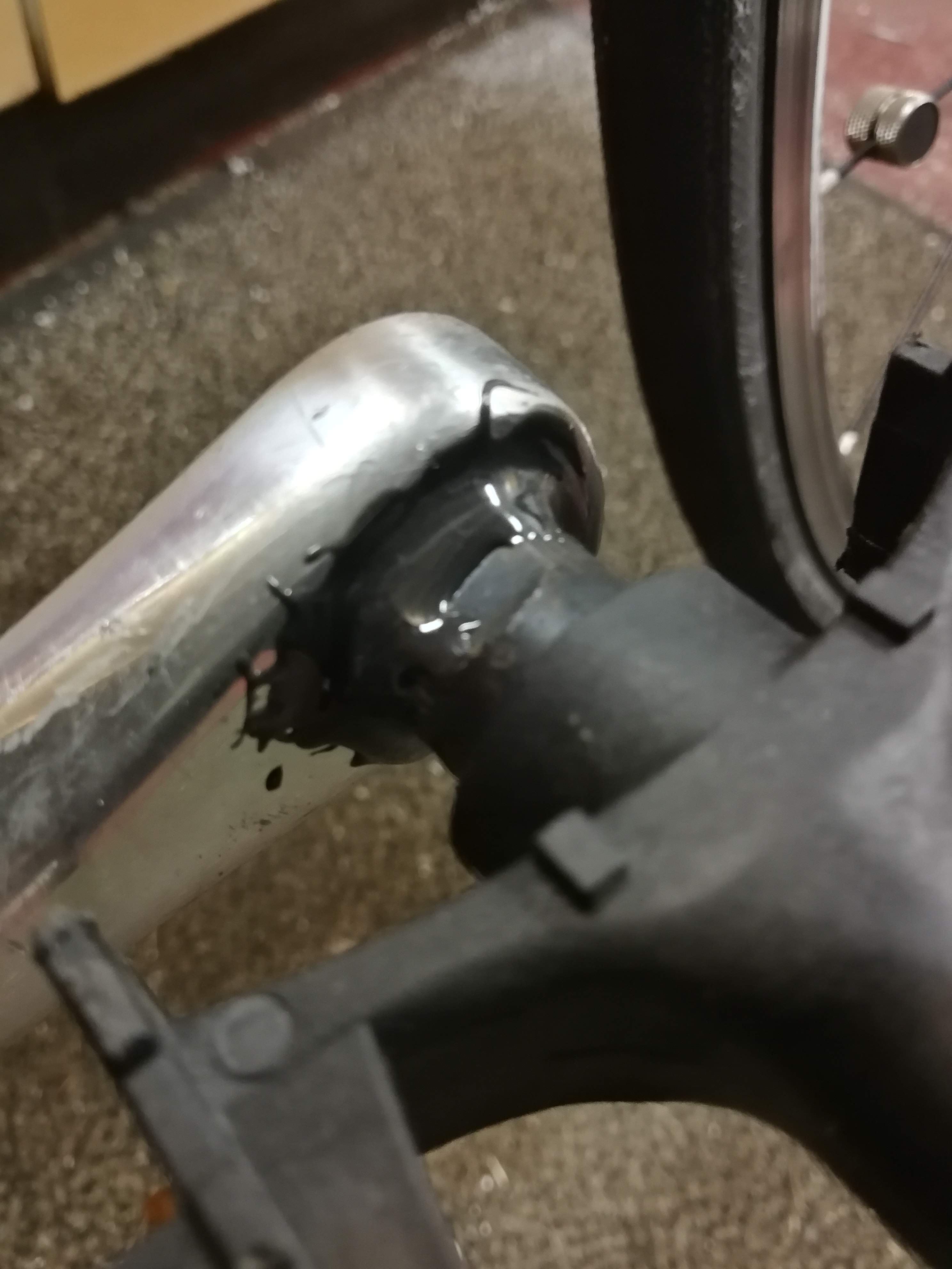

My son has been given a Shimano ultegra but the threads on the right crank are knackered and I’m going around in circles trying to find the correct extraction tool and a new crank with pedal.
I’m now wondering if it’s worth the effort as it seems to be quite an old bile. Can anyone identify it please? Does it have any value? Would it be worthwhile getting the pedal welded to the crank rather than messing about with it trying to locate parts?
I’ve posted an image of it under my account.
Thanks, Stephenc

I think the pedals are on the wrong way round from your description of LH and RH threads so you’ve probably completely buggered the cranks and pedals.
Your options depend on what you’re going to do with it. If it’s just going to be a pub bike, you can probably leave it as is and accept that your bodge will probably fail at some point. If it’s going to be an actual commuter / leisure bike then it’s worth getting a new (or new old stock) chainset and pedals. You can pick up a s/h chainset like that one for about £40 off ebay or you could get a new BB and chainset for not much more than that, it’ll still work with 9sp.
Not sure if you bought the bike like that or have adjusted it to fit, but the saddle is way too low for the frame size by the way.

I really don’t like the look of the glue-ing : I wouldn’t ride it.

Hang on – the spare pedal has
Hang on – the spare pedal has a left hand thread? Now we understand why the threads in the crank are so chewed up!
Drive side crank is standard right hand thread, non-drive side is left hand. Sounds like previous user managed to mash the pedals in the wrong side.

Although that looks a good
Although that looks a good job, I’d be wary of using it for long, since if it lets go, the results can be a crash.

As all the local bike repair shops are closed here, I thought I’d try a repair so I got some 2 pack Epoxy Weld glue. In answer to pockstones question, the pedal was already off the bike when I got it. It’s on a left hand thread and I think there was around 2 threads left at the furthest point, so I cleaned it all off, slathered both the pedal and crank threads with the glue, inserted it and tightened it carefully on the last 2 existing threads. Then is placed a washer in the inside as a gripping point and added more glue. Not the prettiest repair but will hopefully hold out. I took it out on a short ride around the block and it felt firm enough.
I’ll get the bike back to my son tomorrow and see how it goes. Again, a big thanks to everyone for help and advice.
