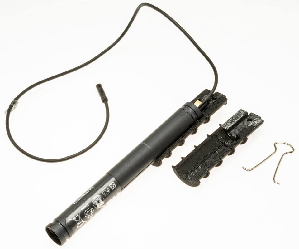

    Hi I bought a new genesis zero disc frame a while back. I’m just about to put it together and I found these rubber things I can’t figure out what they would be for.
    Does anyone know what they might be?

    Nunchuck grips. You do use
    Nunchuck grips. You do use nunchucks on dopey drivers when you commute, don’t you?

    Here’s a picture showing how
    Here’s a picture showing how they fit around the battery (not sure what that metal clip is for – I don’t have one of them). The ridges on the outside of the holders allow the battery to friction fit into the bottom of the seatpost.

    Yes – they certainly look like the Di2 battery holder.
    Unquestionanably.

    To mount a di2 battery in a seat tube?
