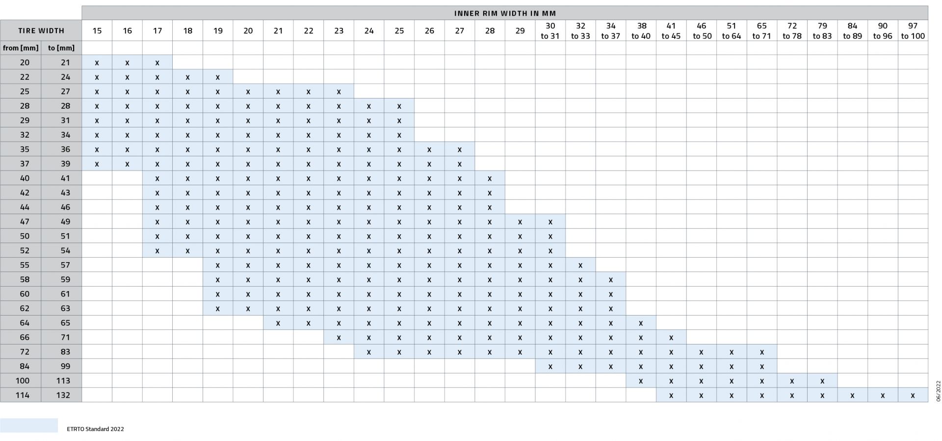

I have a Giant TCR Advanced Pro 1 and it comes with the Giant SLR 1 42mm wheel: hookless rim, inner rim width 19.4mm; Rim width 23 mm.According to Giant, the SLR 1 is best for tubeless and Giant has a list of tires that will fit their hookless rim.
Since I mostly ride in the summer and with tubeless you have to replace or add new sealant every 6 months or so, otherwise the tire sticks to the rim, I think a tube/clincher is better for me.
Can I buy the Schwalbe Pro One Tubeless ready (which is on the list) ride with a inner tube/clincher?
What should I pay attention to?More specifically, I will use the 32mm wide tire and 28mm tube (suitable for 28mm – 32mm tires). Is this width too big for a 23mm rim width?
Is it more suitable if I use the 28mm or 30mm tires?Thanks in advance!
