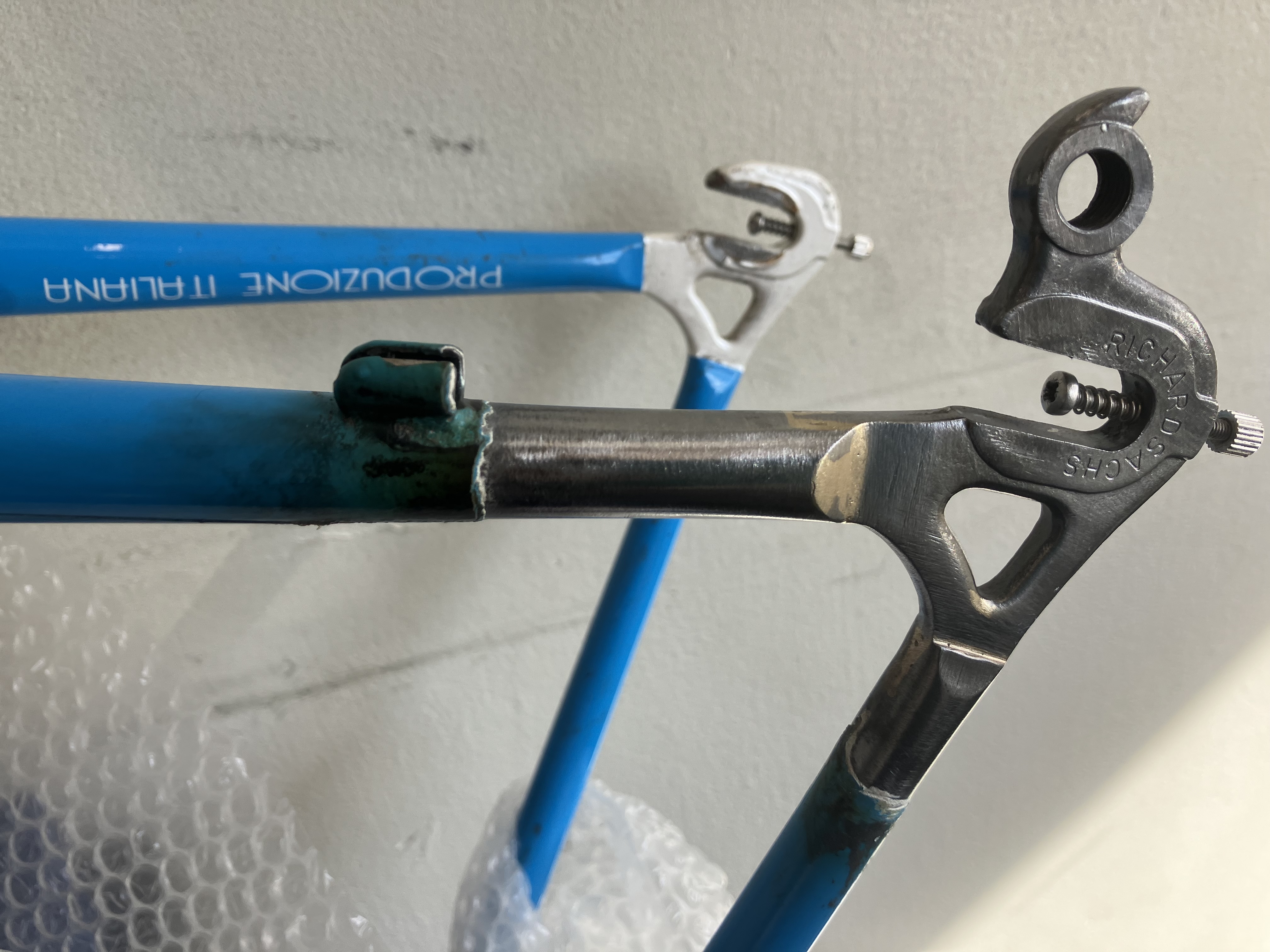

    Here we are – fixed for £80.
    Here we are – fixed for £80. I’ve colour-matched and blended some new rattle can blue paint (I didn’t attempt the pearl white contrast).

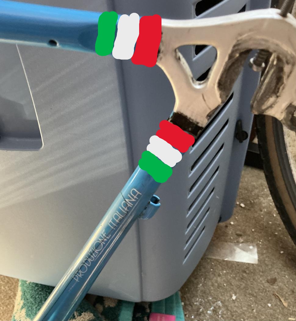

    The tricolour idea could work
    The tricolour idea could work for this bike as it has it on the main tubes as well. I assume a repairer have to clean off the existing paint for as far as the heat from the brazing will travel?  (I should know this, I did a frame building course 10 years ago!)
    I presume you’re talking about Humbrol liquid paint and brushing, rather than sprays? Anything I do with brushes (except possibly nail varnish for scratches) looks terrible (as does a lot of my rattle can spraying), but I’ve never tried Brasso before.  Would enamel work for lug infills?
    When I’ve tried to do spray paint contrasts, I usually end up with an accumulation of paint against the masking tape.
    #1156117
    Aluminium can
    Humbrol or Revell enamel
    Humbrol or Revell enamel (hobby model plane or car) paints are perfect to touch up bike paints.  You just need to buy a can in the closest colour you can find, then white, black and take a guess at what other colour/s you would need to mix to match the paint.  Hopefully someone in the shop could help, if you bring your frame into the hobby shop.  You then get a small empty paint jar and mix the paint, using a bamboo skewer or toothpicks.  You buy a bottle of thinners as well.  Basically, you actually do test painting on the frame, then decide if you need to add more white or make it a bit darker or more blue (etc..) and keep mixing until you can hardly see the difference.  As you do test patches, you then also (within a few minutes) wipe the test spots off the frame using either the thinners or white spirts on a rag.  When the colour is correct enough for you, then you thin the paint down and apply it in several layers, allowing time to dry between each coat.  When the paint has hardened for a week or so, you can use a tiny amount of brasso on a damp cloth to rub the paint down to the same level as the original paint – this will also bring up the shine of the new paint.  Just be sure to only use a small amount of brasso, you could polish off the paint entirely if you use too much.
    Alternatively, paint in a completely different colour but use masking tape to get a sharp edge (model shops sell masking tape that will give a razor sharp edge) , paint a larger area and do it on both sides so the scheme looks deliberate and maybe part of the original paint scheme.  Could use model spray paint in this case.
    Example of a deliberate looking paint scheme in the picture using the italian flag…
    Note that Enamel paint is much easier to use than acrylic, because it takes a long time to dry.   So buy enamel!
    https://road.cc/wp-content/uploads/roadcc/deliberate paint scheme.JPG

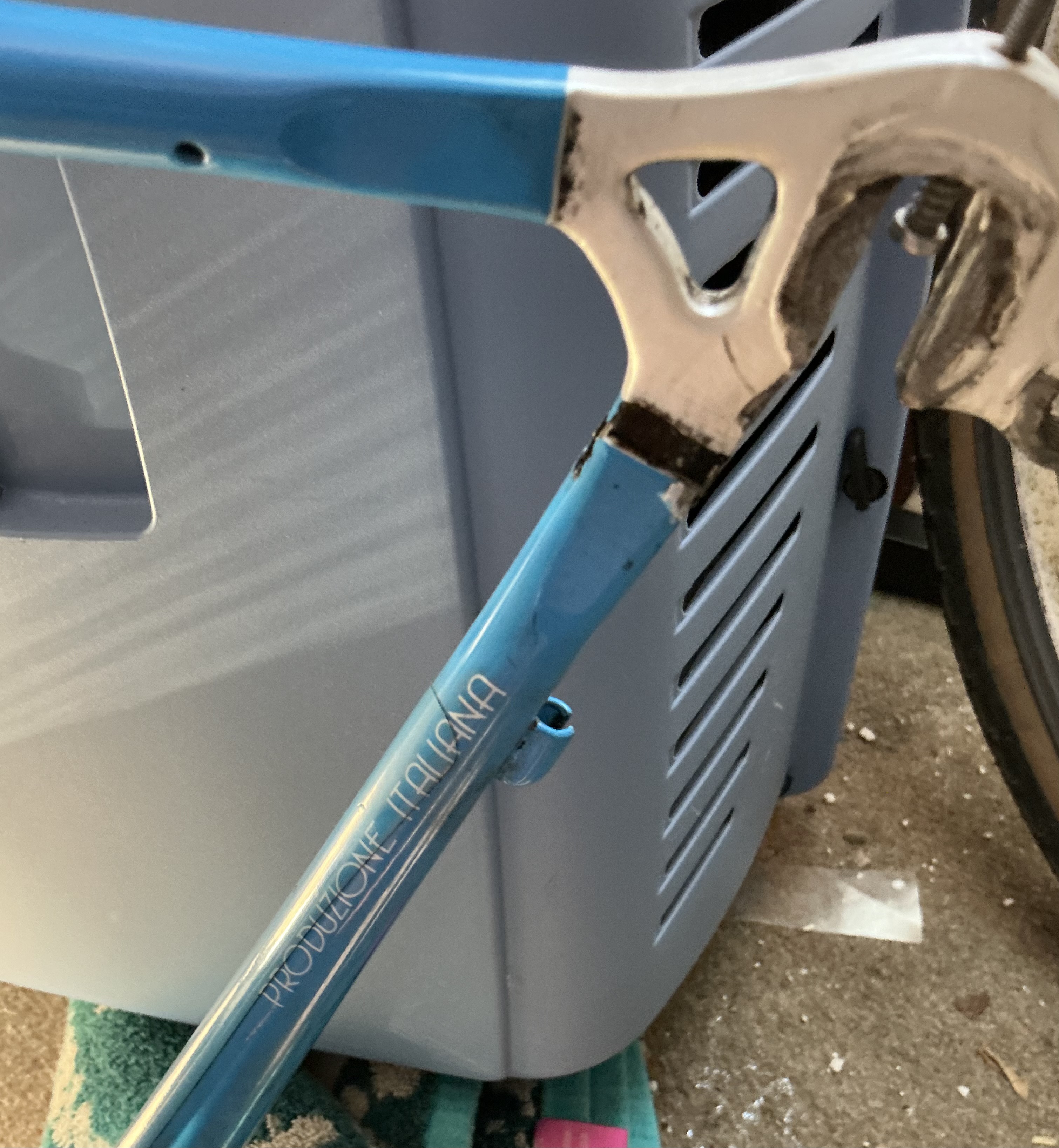

    Backladder
    Is that a shadow or a
    Is that a shadow or a corrosion stain on the blue at the seat stay join? If a second joint is failing then all the others are suspect and the frame should be scrapped.

    Here’s a picture of the break
    Here’s a picture of the break. I’m bending the seat stay out for effect.
    https://cdn.road.cc/wp-content/uploads/roadcc/IMG_6685.jpeg
