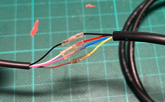

I purchased the CP2502U10OS
I purchased the CP2502U10OS Cannondale Smartsense wire kit. Used the the exact same wire color combo from the picture above. 3D printed the bracket and everything is 100% working including the audbile warning.

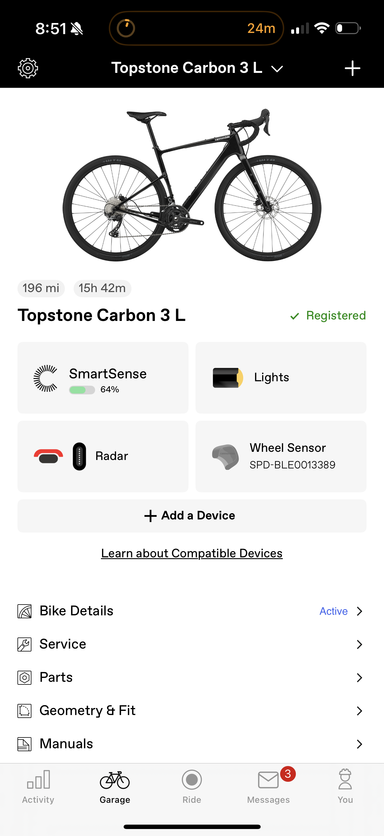

Just wanted to share a quick thank you to everyone who helped out in this thread.
I was able to get the Garmin radar fully working on my Cannondale Synapse. It’s now properly detected in both the Cannondale app and on my Garmin head unit, and everything appears to be functioning as expected.

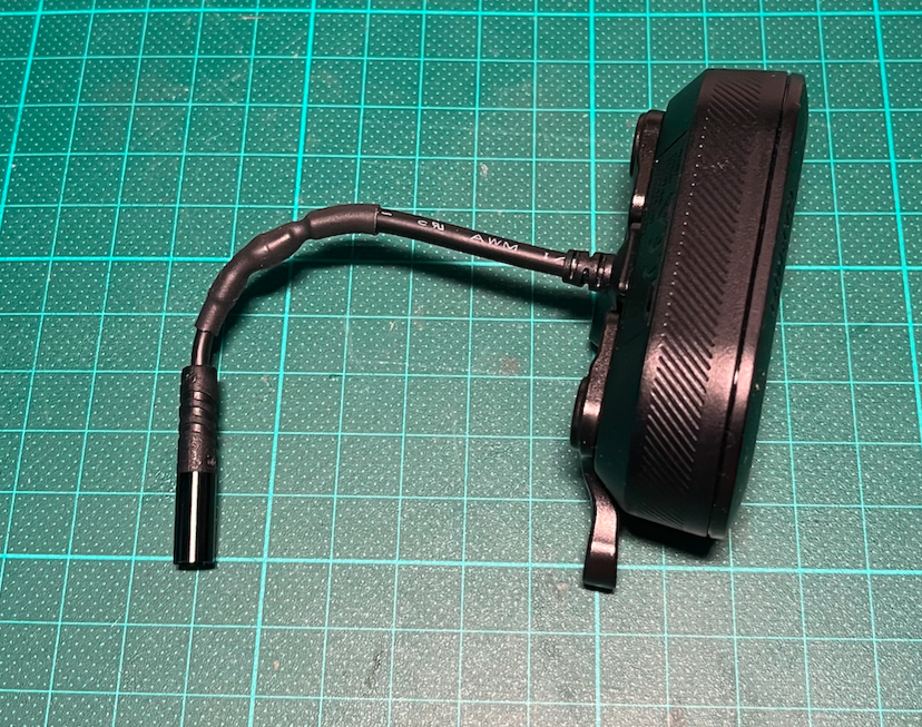

I cut the two wires in excess
I cut the two wires in excess. Maybe there is some current in them so isolate them after cutting.
Connector: https://shop.e-bike-technologies.de/en/connectors/signal/micro/higo-micro-q/higo-s6-mq-detail
I solderer the wires together, then individual heatshrink followed by an overall one.
For display I use a Magene C606, so Garmin Edge should work no problem.

Finished product, total cost
Finished product, total cost 40€.

So, success.
So, success.
It is working on 2023 Synapse 2 LE and paired to a Magene C606.

Creakingcrank
I’m not sure of the pinoouts,
I’m not sure of the pinouts, but assuming the wiring colours on those Higo connectors are standard (it certainly seemed logical on the ones I bought), it is:
Red: voltage + (4-12v)
Black: ground
Yellow/blue: CAN high/CAN low (not sure which is which, just wire same to same)I tested mine with a 9v battery on the display unit – connect to the correct power wires and the light on the unit comes on. The two wires you haven’t used are the CANbus.
