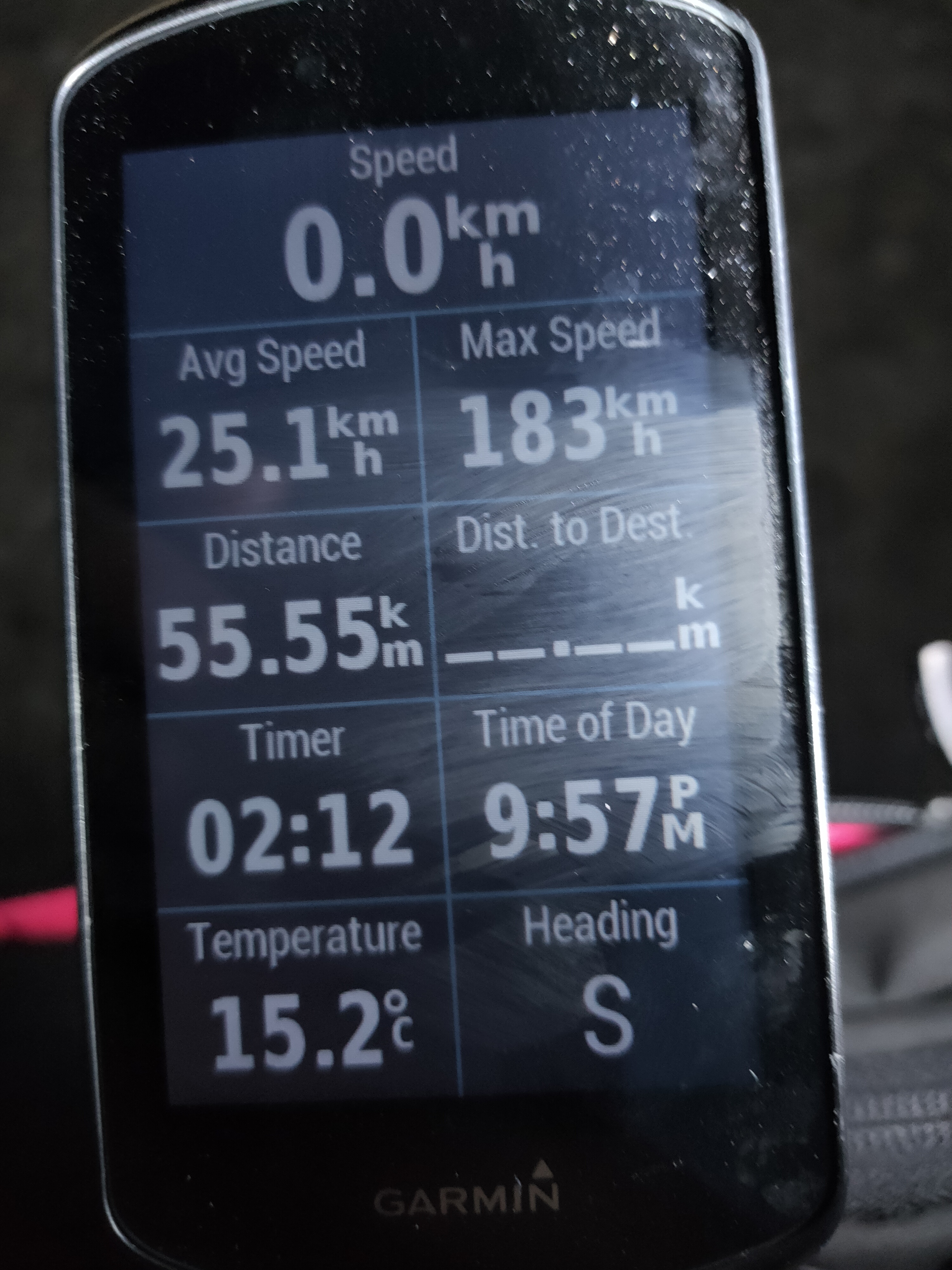

    GPS based speed readings are
    GPS based speed readings are entirely accurate, as shown by my top speed last night.
    https://cdn.road.cc/wp-content/uploads/roadcc/IMG20210710215746.jpg
