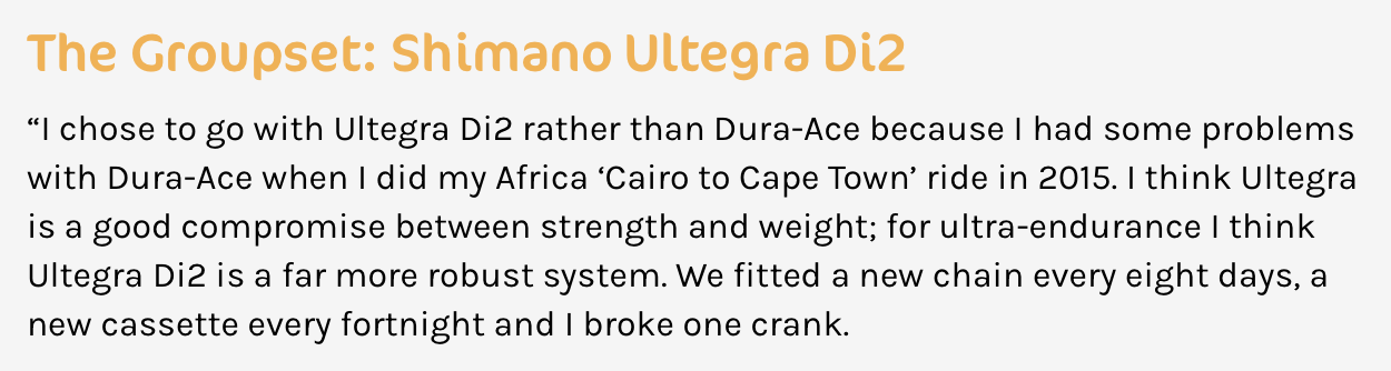

HoarseMann wrote:…even if you are racing it might not be the best choice. Mark Beaumont went for Ultegra on his round-the-world ride, as he found it gave him better durability than Dura-Ace.A while back on Facebook I expressed surprise that Ribble’s newly revealed flagship team bike was equipped with Ultegra Di2, not Dura Ace: Harry Tanfield (it was in the brief period that he was contemplating moving to Ribble Weldtite) told me “the only real difference between Ultegra and Dura Ace is that Dura Ace breaks more easily.” Obviously he would be naturally inclined to defend his team bike but interesting to hear that from a pro.
andystow wrote:I wouldn’t buy a DURA-ACE cassette period. If you’re not racing at a high level, you’re not the target market.and even if you are racing it might not be the best choice. Mark Beaumont went for Ultegra on his round-the-world ride, as he found it gave him better durability than Dura-Ace.
