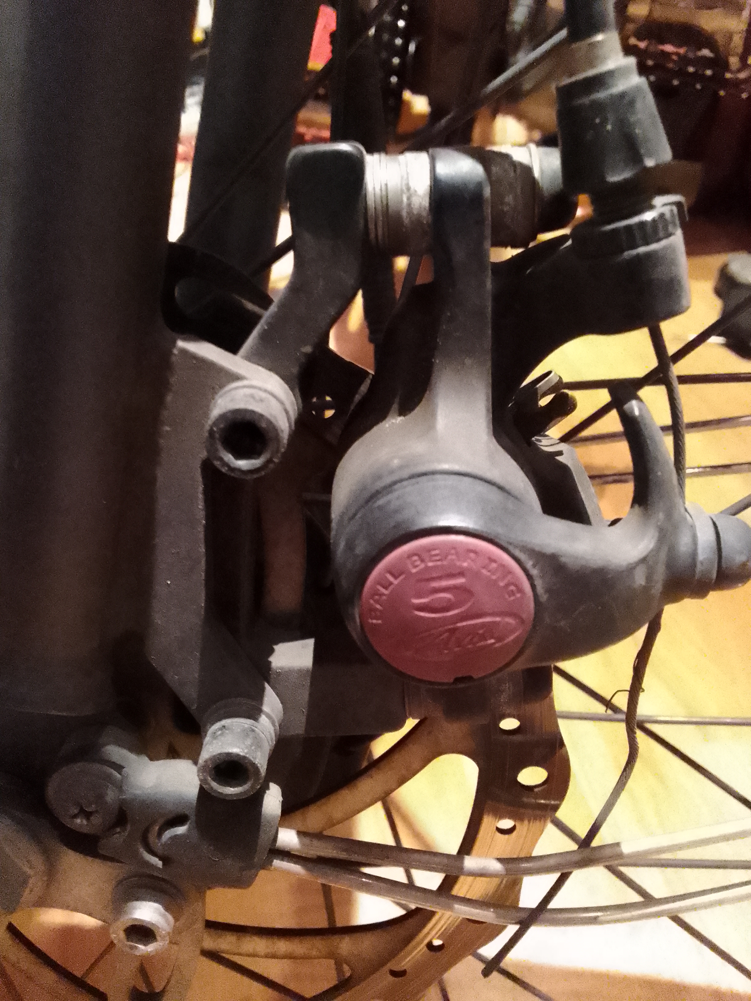

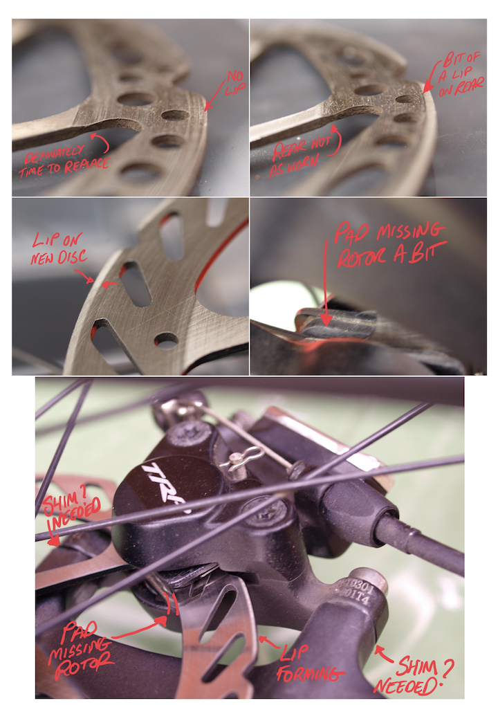

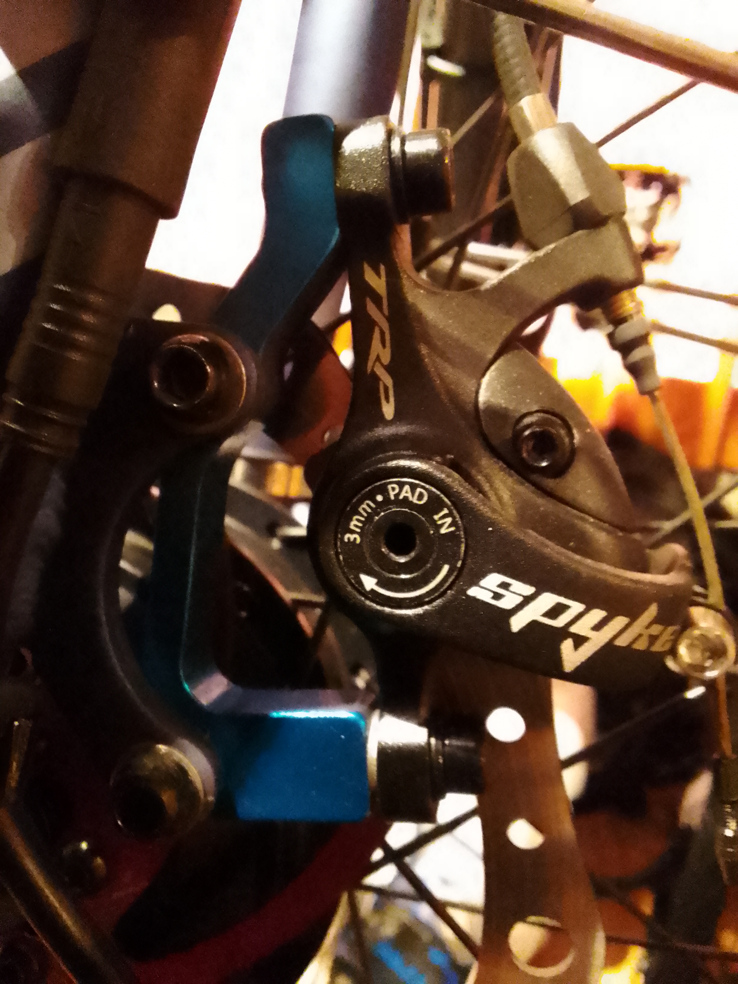

Having just replaced my rotors and put new pads in, I’ve noticed that the swept area of the rotor is not as good as it could be.
On the internet there are lots of articles for adjusting the caliper side-to-side aligment to prevent brake rub, but I can’t find anything for adjusting the area swept by the pads.
Inspecting the old rotors, the front had no lip on the outside of the rotor, but the rear did have a small lip. A quick survey of other bikes in my garage shows that they vary, some do have an external lip, some don’t.
I am tempted to add a couple of shims between the post mount and the caliper to increase the contact area of the pad on the rotor, but I read online that adding shims to brakes that don’t have them originally is not advised.
So, although it looks imperfect, as it hasn’t caused me any trouble in the past I think I shall just leave it as is, but I wondered if anyone else shims their calipers for swept area adjustment?
(photos below)
