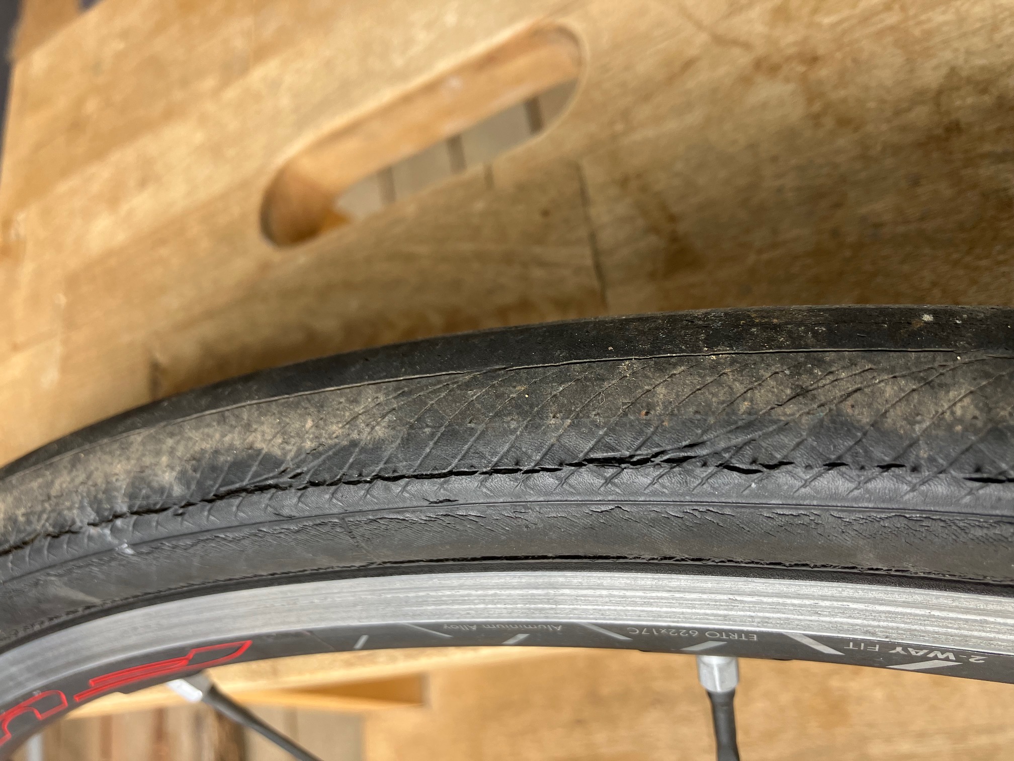

    Got these tyres with a used set of wheels, I’m guessing they’re toast and will kill me if I so much as chuck my leg over the top tube? Caused by being stored flat perhaps? They’re inflated to spec and seller claimed under 500 miles of use.

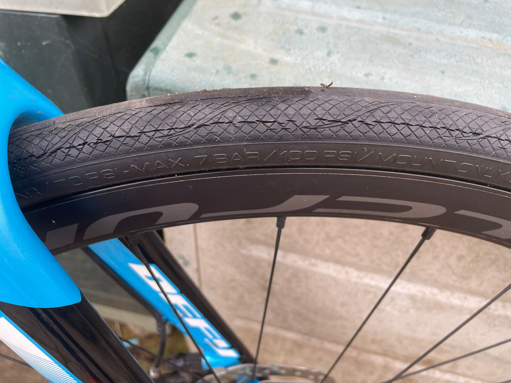

    I have a pair of these tyres and one of them has the same issue, cracked almost the entire circumference only six months old and put straight on the bike when purchased. Bike is always stored with wheels off the ground and ridden 5 days / week. More like a manufacturing fault I think. The other tyre bought at the same time is fine.

    That sounds like being ridden very under-inflated. If they are under-inflated then the sidewall will be flexed beyond its design limit.

    Not sure as I bought the wheels secondhand. My money is on them being stored mounted and flat. The cracking on the rear was all the way round though, on the shoulder of the tyre. I think they’re dual compound tyres so I wonder if it was a manufacturing defect. Still, no bother, seller gave me a partial refund and I’ve got a used set of Conti GP5000s on the way.

    Pic
    Pic (should add that the crack is pretty much round the entire circumference
