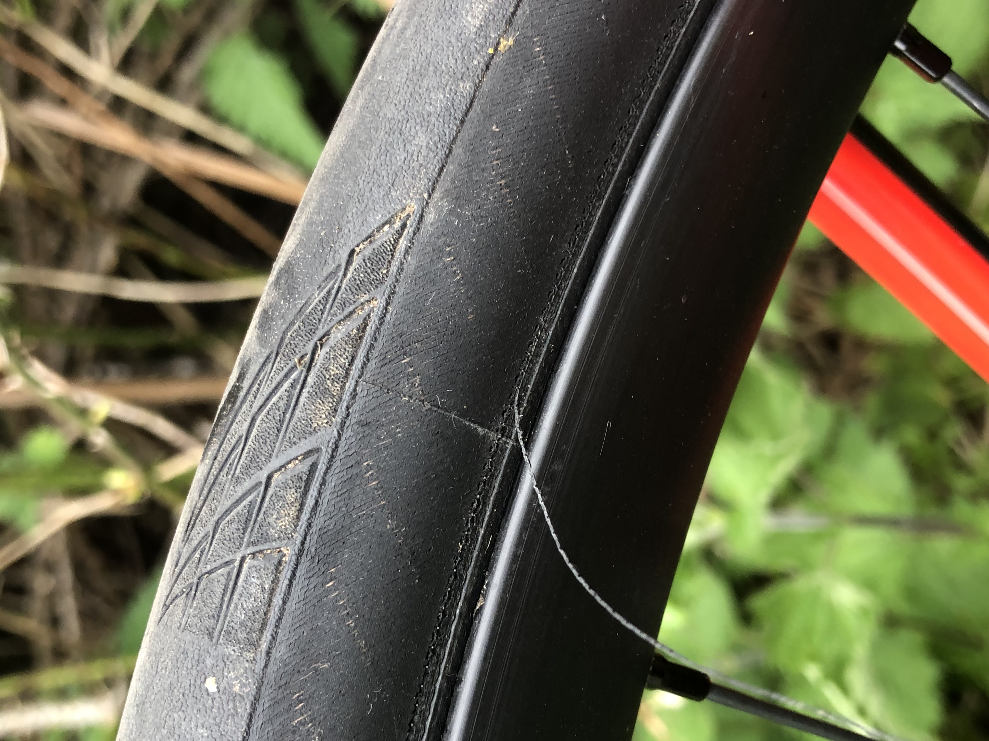

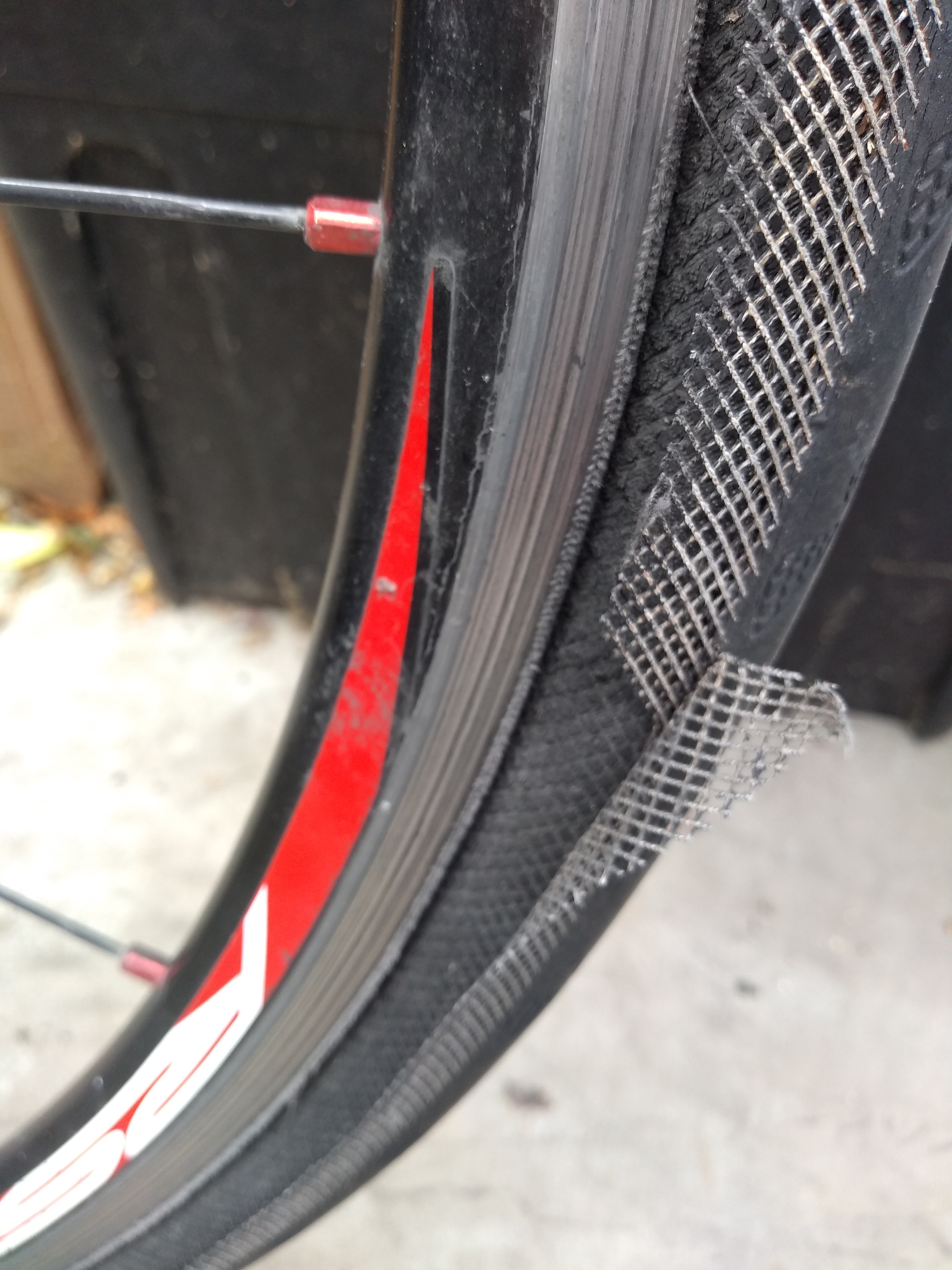

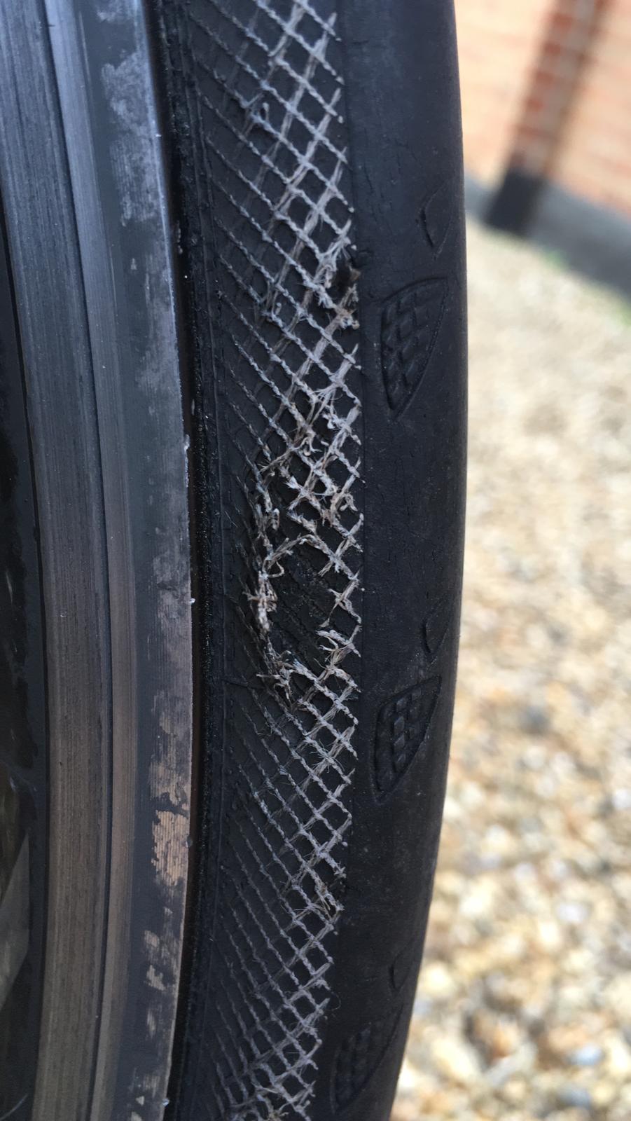

I wonder if any reader have come across this problem? The ‘gatorskin’ layer has detached from the sidewall on my 28mm Continental tyres!
Will try to load pictures, but not sure how to!
matthewn5
Same thing happened with my
Same thing happened with my friend’s Gatorskins, the ‘mesh’ layer started to disintegrated on one of them. Her bike shop advised her to replace it which she’s done.

I’ve just heard back from
I’ve just heard back from Continental Tyres’ customer relations who I’ve been liaising with about these sidewall issues. This is what they said:“Fraying bead tape has now been rectified on current production.
Seeing the Duraskin layer come off like that is not something I’ve seen in around 25 years of working with Conti, but have see two recently. I don’t see this as a batch issue though.”I would not say this is totally satisfactory as this site alone has identified two cases of the duraskin sidewall delaminating, but hopefully Continental will now be more aware of the issue and, like the issue with the bead fraying, revise production to try and ensure it does not recur. Meanwhile I am pleased to say on a personal level that Continental Tyres have accepted that my own tyres were faulty, at least in so far as they have offered to replace them. Really not sure why Cycle Surgery failed to come to a similar conclusion!

Same problem on 4 of my
Same problem on 4 of my GP5000 TL’s, I’ve had no safety issues just yet but I’ve only done about 1200km on one set and 200km on the other. I just snip the thread off as close to the rubber as possible.
I agree though if this is a manufacturing quality issue, it seems like it could be, then Continental should sort it out. At £40 a tyre this shouldn’t be happening.

Roy07775
I brought a pair of GP5000 TL
I brought a pair of GP5000 TL from German retailer Bike Discount. Within a couple of hundred miles both tyres started to shed threads from around the side walls.
I contacted Continental who apologised and sent replacements. These also started to shed at the same mileage. I continued to use them and in the mean time made another order to Bike Discount for cycle consumables and also included an additional GP5000 TL tyre.
The original replacement rear tyre was disposed of because of rips and tears. The front I left on until it came off the rim and caused an accident.
Had the wall been weakened? I replaced with the spare new GP5000 tyre which then showed the same shedding at the same mileage.
So Five x GP5000 TL all shed threads and one threw me off.
Great tyre but at what cost ? You’re teeth or worse. Continental know this is happening and continue to sell them to YOU. After all the GP5000 TL hype surrounding its launch it turns out that the tyre is poorly constructed with no sight of rectification.
All tyres were run at around 70/80 psi and pressures maintained before each ride. Tyre leavers were only used to start tyre removal and mounted by hand.
Schwalbe tubeless don’t do this. I will now not use Continental tyres as they’re expensive and potentially dangerous.
