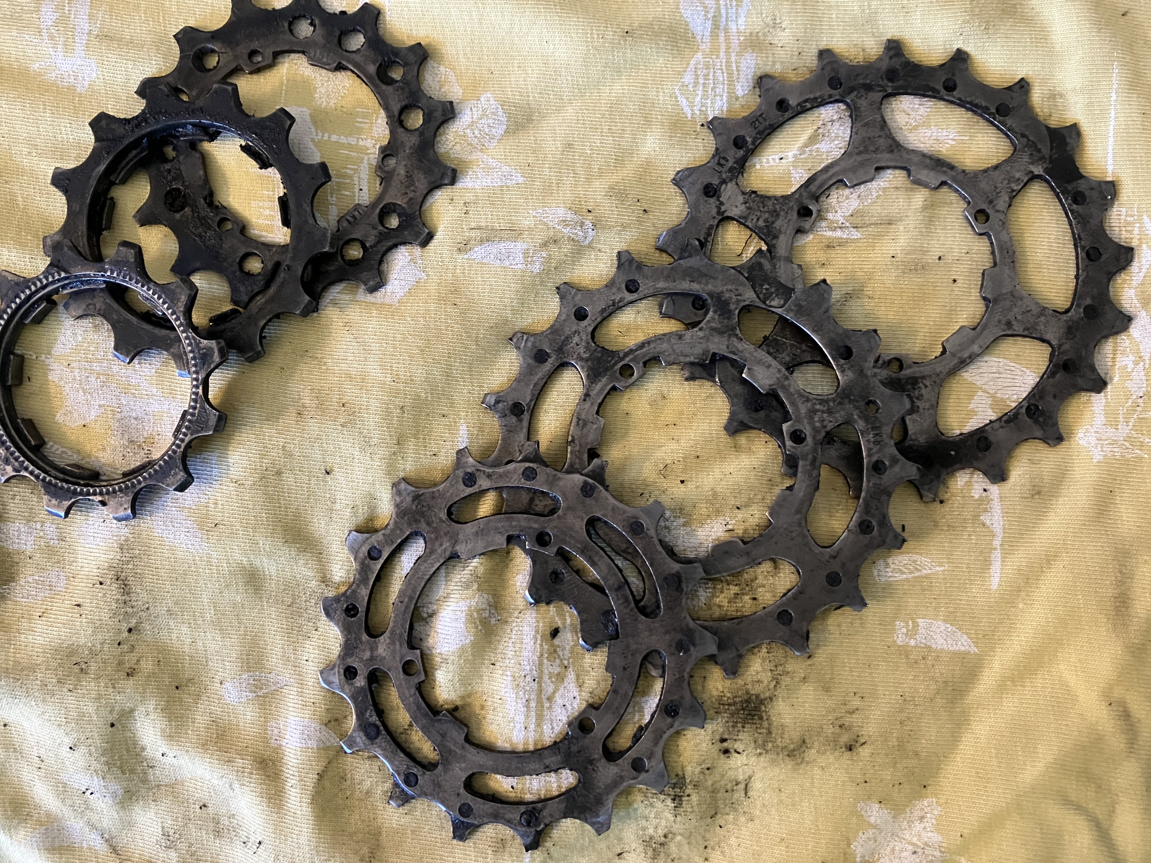

    One perhaps for Cycling Funnies – “the great thing with cassettes over freewheels is that the whole thing comes apart so you can replace individual cogs when they wear out; works out cheaper.”
    A whole bunch of chain skipping in mid gears under load – checked the mech alignment, lockring, recently replaced chain, only one thing left. Another upgrade – from Ultegra to a Miche 13-30t 10s cassette.

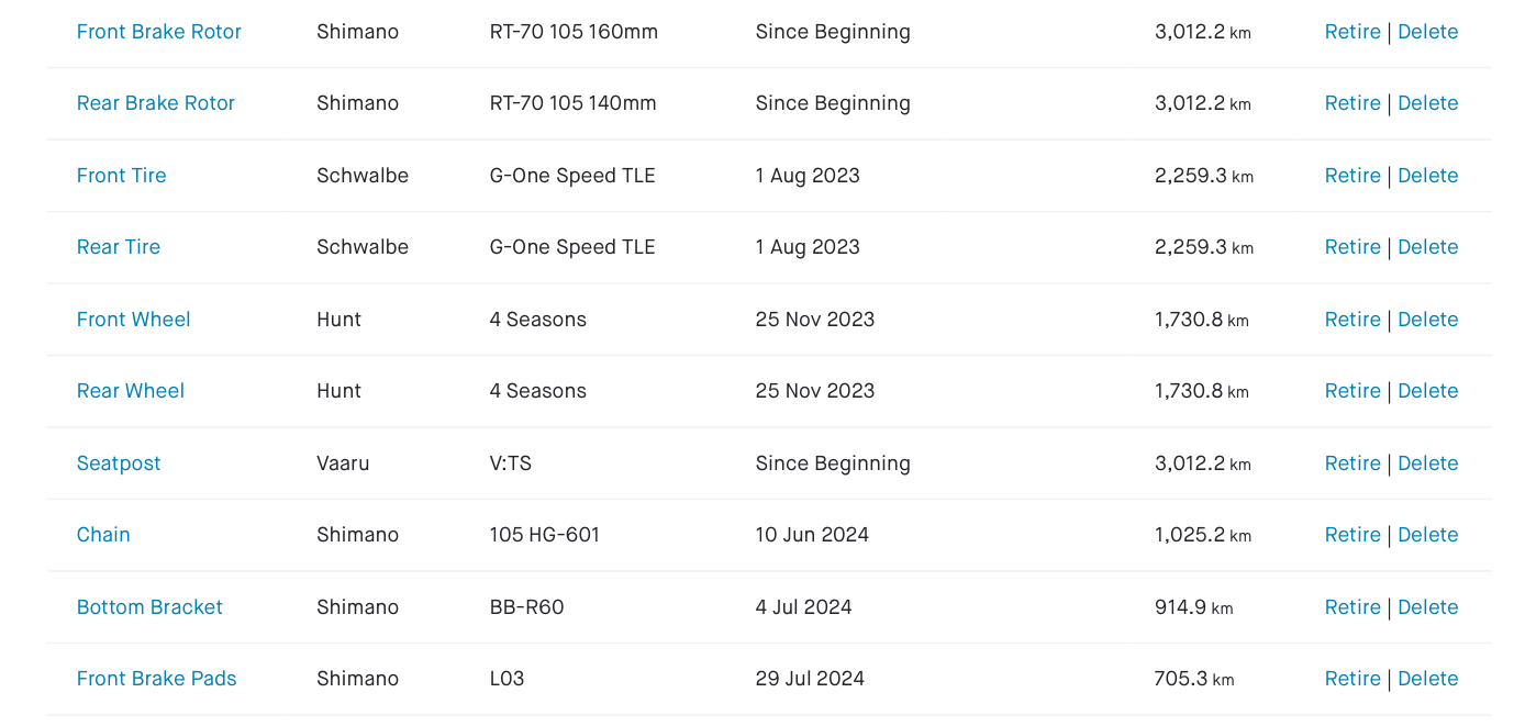

    I guess it’s sensible to run a log-book for each bike – Bike A / SRAM chain / date, Bike B – new tyres – date, bike C – regreased f and r wheel bearings – date
    Strava is handy for keeping track of gear usage (assuming one is already using it of course)…
    https://cdn.road.cc/wp-content/uploads/roadcc/IMG_0246.jpeg

    I’ve got replacements for the
    I’ve got replacements for the 3 cogs I reckon are the most worn. One was a Miche cog which seems to be built slightly differently to the Shimano – Shimanos are a perfect disc, Miche are dished slightly. It came with a paper-thin spacer.
    I’ve assembled it, not 100% sure if the distances are even – might be one for a friction shifter using bike.

    If I put the micrometer on
    If I put the micrometer on the tips of the cogs on a new cassette or the unworn smaller cogs, they’re about 3.5mm across. I was getting readings of less than 3mm on some of these teeth.
