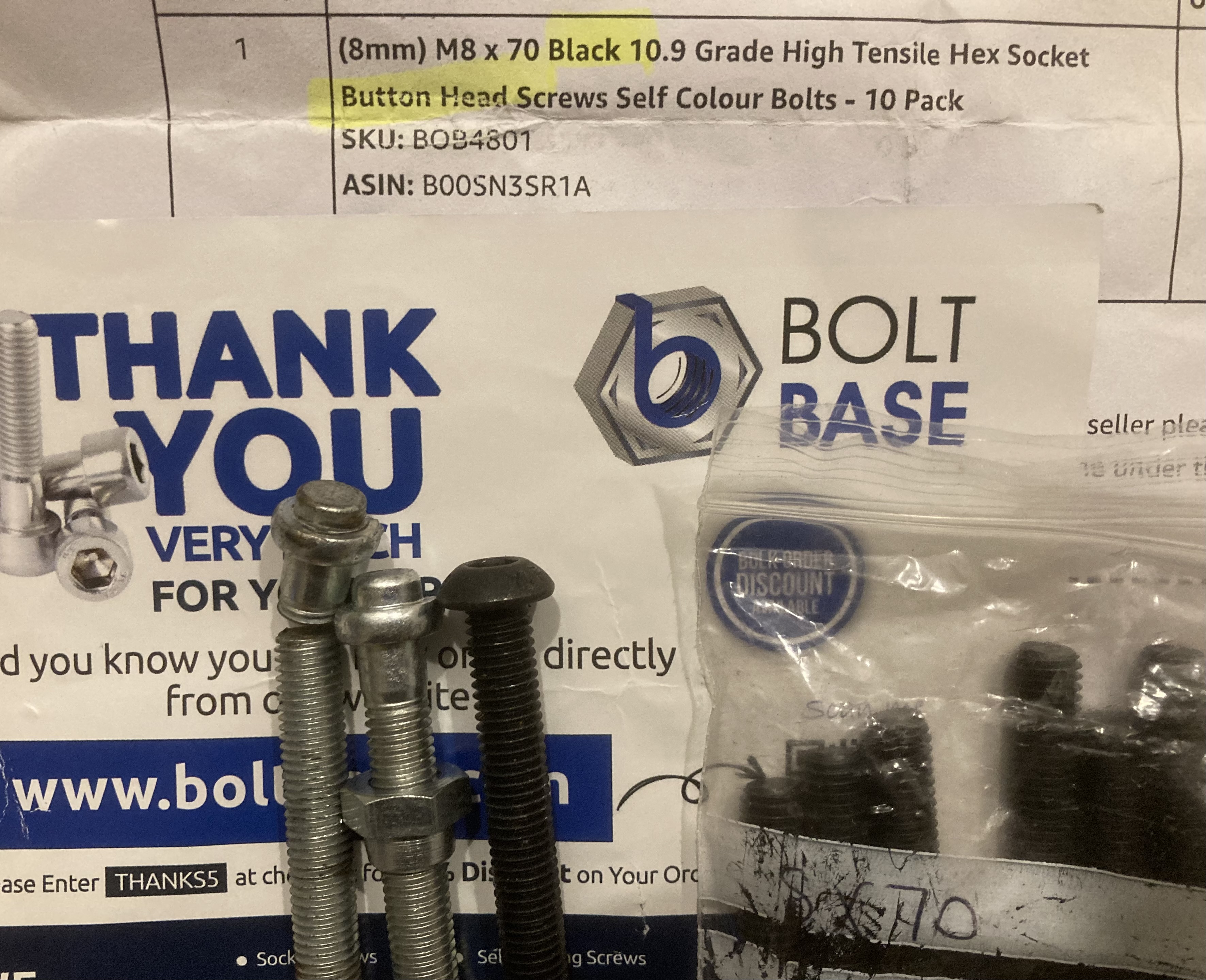

    I also bought a replacement Brooks tension bolt, and found it impossible to fit because the thread doesn’t tighten close enough to the head of the bolt – it isn’t threaded close to the head.  You need a Brooks factory tool or ridiculously strong hands.
    However, if you can source a suitable non-Brooks bolt you can reuse the nut from the broken bolt, tighten (effectively re-tap) the nut as far as the head of the new non-Brooks bolt.
    Then you can slot the bolt in place within the saddle’s metalwork, hold the nut firmly with the Brooks spanner and turn the M8 bolt anti-clockwise (mine needed a 5mm hex wrench) so that it tensions against the metalwork of the saddle’s nose.
    Carefully read the instructions in the CTC forum thread.  And here is a copy of the invoice for the bolts I picked up.  Around a fiver.
    [ edit: here is an Amazon link if you’re interested: https://www.amazon.co.uk/gp/product/B00SN3SR1A/ref=ppx_od_dt_b_asin_title_s00?ie=UTF8&psc=1 ]
    https://road.cc/wp-content/uploads/roadcc/Brooks saddle replacement M8 bolt.jpg
