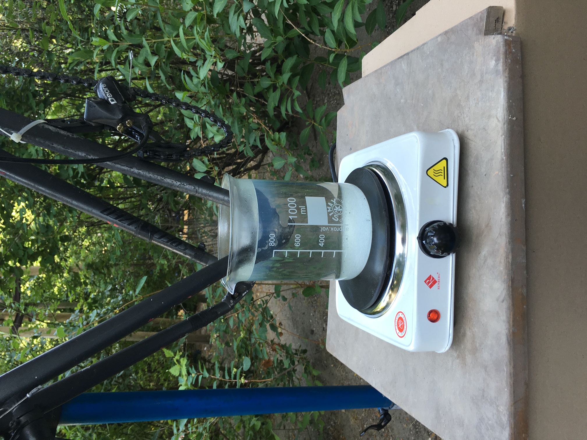

As others have said, I would
As others have said, I would try a bolt extractor first. Drill a small pilot hole first, then the correct sized hole. If you can get the bike held steady in a workstand it will be much easier. Use penetrating fluid before trying anything.
If that doesn’t work, and the frame is aluminium and the bolt is steel, you can also dissolve it. You ned to be able to dip the whole thing into water though so it depends on the shape of your bike and the shape of your container. I have sucessfully used Potassium alum (as used for making pickles) in hot water. Won’t work if the bolt is stainless.
